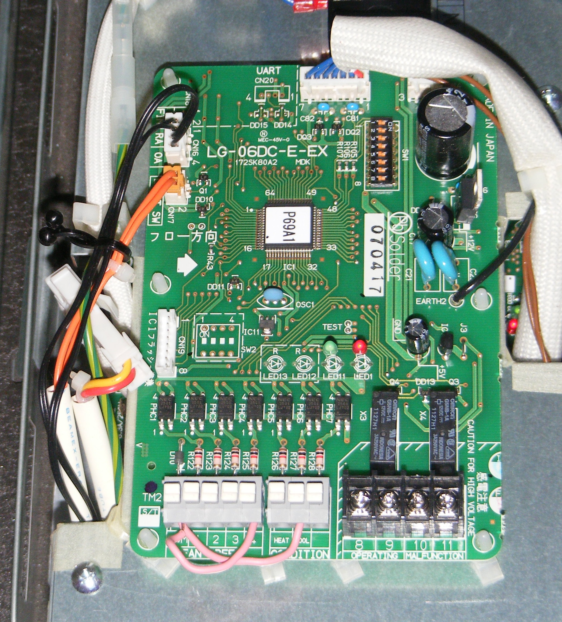

I am trying to find the installation / operating manual for my Lossnay MVHR unit model KAR-50RSDC I have the manual already for the LGH-50RSDC which seems easy to find and download, but it is different, with a different type of controller PCB.
The issue I am having is I cannot manually select summer bypass mode. My unit has two inputs called "heat" and "cool" (which the connection diagram says refer to bypass condition select) and it does not matter which I select, the bypass mode does not turn on.
I have just finished the ducting and giving the unit a basic operational check and frustrated I can't operate the bypass mode.
Anyone have the manual for the KAR unit or have one working please?
This is my controller pcb
the TM2 and TM3 connectors are at the bottom of the board and have a slightly different function to the LGH version.
Also m board has only one DIP switch with different functions to the LGH version.
Well I have not found the manual, but I have been doing some experimenting, which might help others with this version of the Lossnay mvhr units:
The unmarked right hand terminal of TM3 activates the summer bypass mode.
The DIP switch has different functions to that described in the LGH version manual.  So far I have discovered SW1 is the same test mode.and SW5-8 do the same fan speed fine tuning that Dip Switch bank 2 does on the LGH version.  Not yet worked out what switches 2-4 do.
