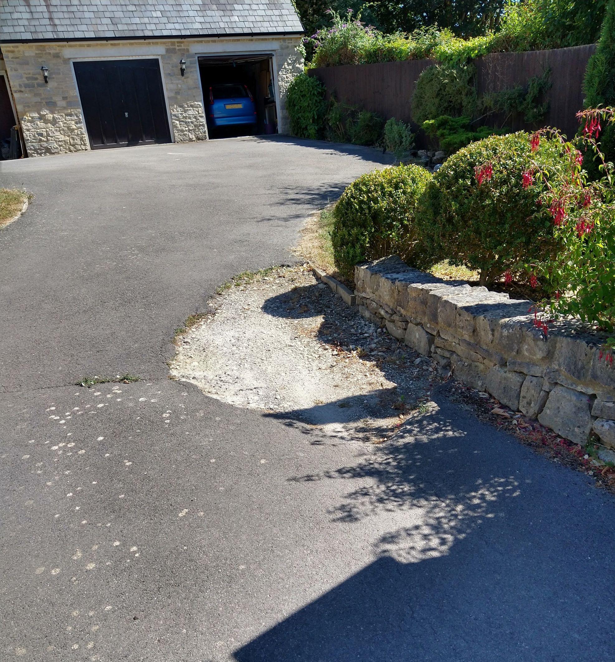

Radian Posted August 25, 2022 Share Posted August 25, 2022 It has been over a year since we had a regular procession of grab lorries, skip deliveries, cement trucks etc. The driveway suffered badly during that time and we've just kind of got used to it. But it really needs something doing. But what? I know nothing about tarmac or whatever this black stuff is called. Is it something you can buy and lay cold? Link to comment Share on other sites More sharing options...

Radian Posted August 26, 2022 Author Share Posted August 26, 2022 When I read online reviews of cold lay tarmac, there's not much positivity around. Not that I put all my faith in those kind of reports as there are some right dummies around who wouldn't read the instructions. It would be more useful to hear of some experiences here. Link to comment Share on other sites More sharing options...
markc Posted August 26, 2022 Share Posted August 26, 2022 (edited) Cold tarmac is ok for patching a small hole or around a access or inspection cover but it does not set like hot lay stuff does. That said, most users of cold lay set themselves up to fail by not prepping the holes, get rid of any mud and loose stuff, good priming with bituminous paint or better still roofing compound to give the tarmac change to get hold of the hole. Edited August 26, 2022 by markc Link to comment Share on other sites More sharing options...
Radian Posted August 26, 2022 Author Share Posted August 26, 2022 37 minutes ago, markc said: it does not set like hot lay stuff does So what happens when lorries roll over it? As we are at the end of a cul-de-sac everything tends to back a little way into our drive to turn. Bin lorries twice a week. Can't see how it would stay put. Link to comment Share on other sites More sharing options...
joe90 Posted August 26, 2022 Share Posted August 26, 2022 I think I would prefer “proper” tarmac , see if a local company would do it with a leftover from a big job nearby. 1 Link to comment Share on other sites More sharing options...
