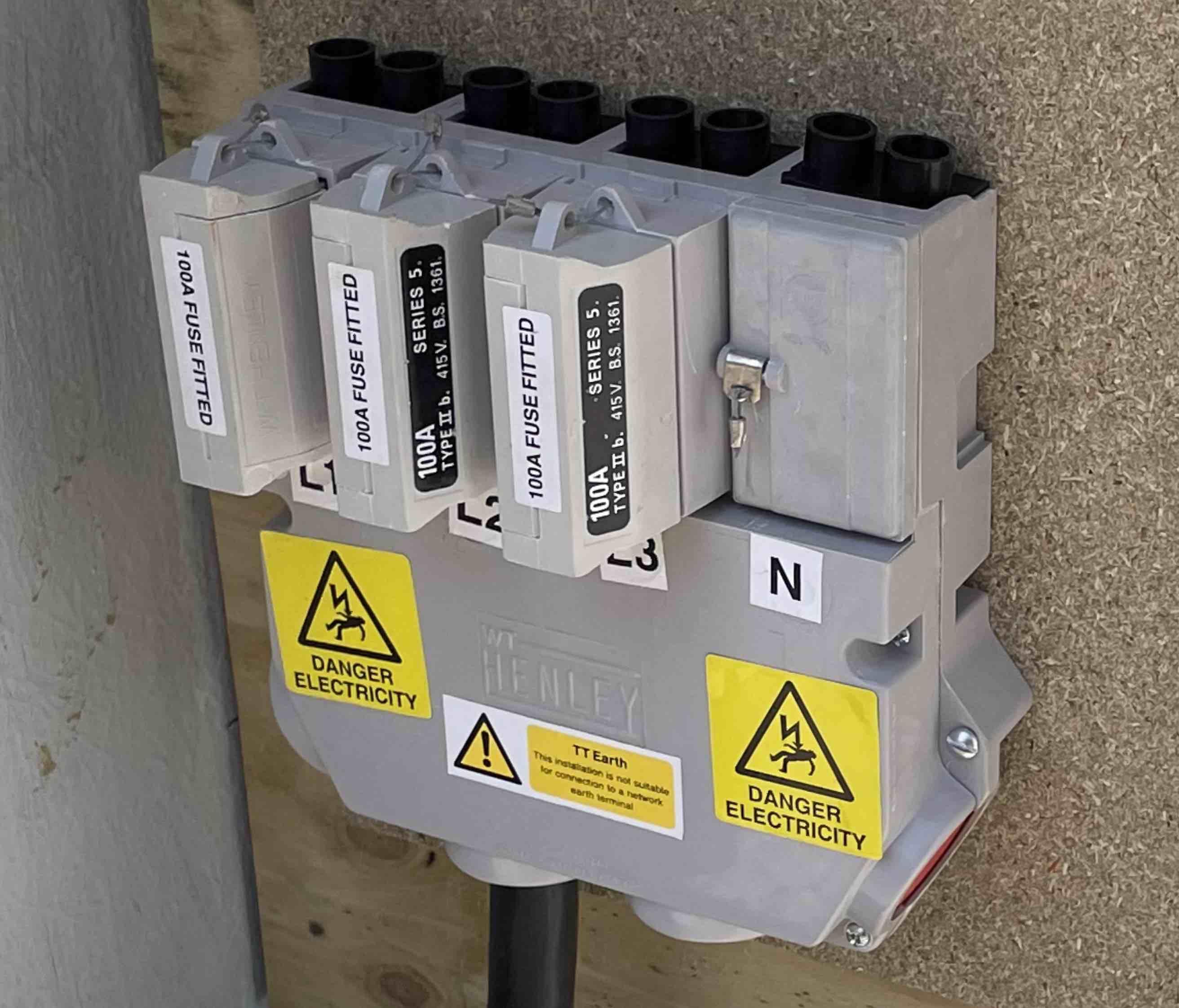

Thorfun Posted August 21, 2022 Share Posted August 21, 2022 I need approx 30m of 4 core 35mm SWA cable for the connection from the cabinet to the CU in the plant room (damn that stuff is expensive!). I've been doing my research and have found on superlecdirect.com their LSZH SWA cable is £1.01+VAT cheaper per meter (https://www.superlecdirect.com/cables/steel-wire-armoured-cables-bs6724-lszh/bs6724-35mm-4core-xlpe-swa-lszh-cable-harmonised-black/) compared to the PVC version (https://www.superlecdirect.com/cables/steel-wire-armoured-cables-bs5467-pvc/6944x-35mm-4core-bs5467-xlpe-swa-pvc-cable-harmonised-black/). My electrician said that he's previously used LSF cable and it's a pig to strip and as my SWA is going in a duct in the ground he said just get the PVC stuff. But LSF is different to LSZH, right? so is the LSZH cable also a pig to strip? And if the LSZH cable is cheaper than the PVC why wouldn't you buy it? it's better, right? am I missing something here? I have a LOT of cable to buy and will be agonising over the whole LSZH/LSOH vs PVC argument lots in the near future. can someone also please tell me if it's worth using the LSZH stuff even if it's more expensive than PVC? I would've thought that in a domestic environment by the time the cable catches fire, i.e. has gone through the plasterboard, I've got bigger issues than the PVC burning, right? is LSZH more for commercial buildings when you have to evacuate a multi-storey office block or high-rise buildings like apartment blocks etc Can someone please help to clear up this whole issue for me? 🙂 Link to comment Share on other sites More sharing options...
PeterW Posted August 21, 2022 Share Posted August 21, 2022 8 minutes ago, Thorfun said: need approx 30m of 4 core 35mm SWA cable for the connection from the cabinet to the CU in the plant room (damn that stuff is expensive! Who has sized that ..?? Has the DNO Installed a 3x80 head or is it a 3x100 head ..? You would be pulling 55kW with 3x100 which is industrial power levels not house levels. And how are you dealing with earthing ..? Separate conductor back to the DNO earth point ..? Link to comment Share on other sites More sharing options...
Thorfun Posted August 21, 2022 Author Share Posted August 21, 2022 14 minutes ago, PeterW said: Who has sized that ..?? Has the DNO Installed a 3x80 head or is it a 3x100 head ..? You would be pulling 55kW with 3x100 which is industrial power levels not house levels. And how are you dealing with earthing ..? Separate conductor back to the DNO earth point ..? DNO installed 3 x 100A head. our electrician has sized 35mm 4-core SWA with a separate 35mm earth. our system is a TT earthing system so I will be hammering an earthing rod in to the ground in the not too distant future! we're planning on running the house off a single phase but I am planning on utilising 3-phase in the future for EV charging, mostly. so am running the cable for future proofing. I also need a TP&N switch fused isolator which isn't cheap. Link to comment Share on other sites More sharing options...

Carrerahill Posted August 22, 2022 Share Posted August 22, 2022 (edited) 15 hours ago, Thorfun said: DNO installed 3 x 100A head. our electrician has sized 35mm 4-core SWA with a separate 35mm earth. our system is a TT earthing system so I will be hammering an earthing rod in to the ground in the not too distant future! we're planning on running the house off a single phase but I am planning on utilising 3-phase in the future for EV charging, mostly. so am running the cable for future proofing. I also need a TP&N switch fused isolator which isn't cheap. What is the cable route? Edited August 22, 2022 by Carrerahill Link to comment Share on other sites More sharing options...

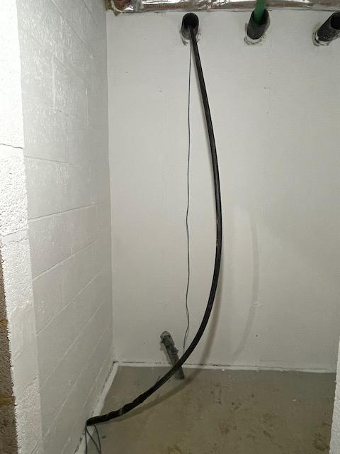

Thorfun Posted August 22, 2022 Author Share Posted August 22, 2022 1 hour ago, Carrerahill said: What is the cable route? underground in a 110mm twin-wall duct from the cabinet to plant room in the basement. Link to comment Share on other sites More sharing options...

Carrerahill Posted August 22, 2022 Share Posted August 22, 2022 51 minutes ago, Thorfun said: underground in a 110mm twin-wall duct from the cabinet to plant room in the basement. What is the anticipated board load? TPN board, each a potential of 100A, but what is the demand actually going to be? Reason I ask is 25mm could fly quite easily if the loads were OK. At 25mm² you might save £5 a metre! Also, 35mm² additional earth is a bit excessive, on 25/35mm² SWA the armour will be fine, I have never had a cable calc fail on a 25/35 armour earth on a SWA, if worried tack a 16mm² on in tandem. Put it this way, practically every cable schedule we do, for SWA's up to about 70mm² will go out with armour as the earth. Next time you are in a building with exposed services, look for all the sub-mains, most of them will be SWA on their own. What is being proposed is not wrong I hasten to add, just a lot of overkill and maybe some over egging on some figures which you are paying for. Link to comment Share on other sites More sharing options...
Thorfun Posted August 22, 2022 Author Share Posted August 22, 2022 1 hour ago, Carrerahill said: What is the anticipated board load? TPN board, each a potential of 100A, but what is the demand actually going to be? Reason I ask is 25mm could fly quite easily if the loads were OK. At 25mm² you might save £5 a metre! Also, 35mm² additional earth is a bit excessive, on 25/35mm² SWA the armour will be fine, I have never had a cable calc fail on a 25/35 armour earth on a SWA, if worried tack a 16mm² on in tandem. Put it this way, practically every cable schedule we do, for SWA's up to about 70mm² will go out with armour as the earth. Next time you are in a building with exposed services, look for all the sub-mains, most of them will be SWA on their own. What is being proposed is not wrong I hasten to add, just a lot of overkill and maybe some over egging on some figures which you are paying for. sorry, I can't answer the anticipated board load! I'm not that clever. But I have decided to go with this CU (again, bit of overkill but plenty of space for anything I want to throw at it and not much more than a smaller board) which is single phase. our electrician did think that we could be ok with 25mm but thought for the extra the 35mm will give us a lot of headroom should our loads ever require it in the future. I think I'd rather pay an extra £100 now than have to run a new cable further down the line! but, I guess that now I have prices on the cable I could ask him if we can go back to the 25mm cable. I understand what you're saying about the earth but it's what our sparky has suggested to do and as he will be installing it I feel I need to run the separate earth cable as he's requested. hope you understand. although, I, again, could simply have a chat with him about it! 🙂 I'm not very good with electrics and need to trust our electrician on all of these things. I've read pretty much every thread in the CU subforum on here so I've a bit of knowledge, but, as they say, a little knowledge is a dangerous thing. Link to comment Share on other sites More sharing options...
