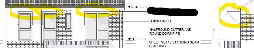

mike2016 Posted August 12 Share Posted August 12 I directed the Architects to improve the overheating score in PHPP from 5% based on local weather data (Dublin, Ireland). Adding Brise Soleil improved it to 2% and opening roof lights dropped it to 1%. However with climate breakdown I asked about changing the climate location to London and even with these mitigations it drove it up to 13%! I'm installing Air to Air heating/cooling with 4 internal cassettes and hopefully this and passive stack cooling in the evenings will help mitigate this risk for a decade or so...... Link to comment Share on other sites More sharing options...
Alan Ambrose Posted August 12 Share Posted August 12 @mike2016 That's interesting - how wide are your brise soleil? When you say '4 internal cassettes', are those the ceiling mounted ones, kind of like these below? BTW feedback from things that have worked well for people who have finished their builds is invaluable for people like me that are still in the pre-build stage. Link to comment Share on other sites More sharing options...
mike2016 Posted August 12 Share Posted August 12 The brise soleil are each the width of the 3 main upstairs windows and come out about a meter from the wall, the windows are 2 meters high. Internal cassettes are the nice wall mounted ones more typical in very small offices / homes, rather than ceiling mounted and I hope to put them above the beds when I get to 1st fix so they blow over the bed rather than onto it in case it needs to be kept on overnight for a good sleep! Link to comment Share on other sites More sharing options...
