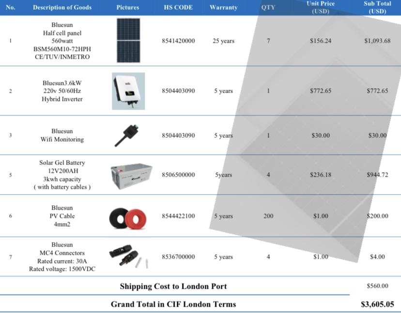

puntloos Posted August 27, 2023 Share Posted August 27, 2023 On 21/08/2022 at 20:54, CotswoldDoItUpper said: This quote is with a g98 inverter. can anyone tell me if it’s ok or complete ar5e? I’ve been sent the official g98 certificate, how do I check if it’s accepted by my DNO? thanks! One year on, I'm certainly wondering if this worked out for @CotswoldDoItUpper As you might've seen in some other topic you can get at least 630W JA Solar (respected brand, TUV, CE) easily in china, in fact they claim it's a EU warehouse - I've seen even 710W (slightly dubious sounding brand but respected seller it seems). Both of them want me to import a pallet (31 panels) at least.. but I might even be able to fit that on my roof - either way the thing I have no idea about is the headache of importing to "A london port" - and then having someone take them off the ship, fill out all the paperwork, then truck it to my building site. Would love to know the steps (of importing just the panels - I'll get the inverter and batteries in the UK..) - anyone? Link to comment Share on other sites More sharing options...
JohnMo Posted August 28, 2023 Share Posted August 28, 2023 Really, why would you actually bother importing, with a organising, shipping, getting the goods in the country, import duty, getting goods to your house. What about warranty - not worth the paper it written on. To save pennies, or most likely pay more when all said and done, just select from a good priced wholesaler in the UK. Open a account with a decent sized wholesaler in the UK, go into a local store, tell them you would like to order xyz and looking for a good price, they are likely to beat any internet price. If they don't move on the next company. Link to comment Share on other sites More sharing options...
puntloos Posted August 28, 2023 Share Posted August 28, 2023 (edited) 24 minutes ago, JohnMo said: Really, why would you actually bother importing, with a organising, shipping, getting the goods in the country, import duty, getting goods to your house. What about warranty - not worth the paper it written on. To save pennies, or most likely pay more when all said and done, just select from a good priced wholesaler in the UK. Open a account with a decent sized wholesaler in the UK, go into a local store, tell them you would like to order xyz and looking for a good price, they are likely to beat any internet price. If they don't move on the next company. After my math-doing in this topic: I agree it's not worth it. I was under the impression that better performance panels already exist in Asia, and it seems that it's simply not true, there are just different sizes, and _perhaps_ slightly better prices if everything turns out amazingly but it indeed doesn't seem to be worth the hassle at all. My main concern right now is designing panels that fit optimally in a roof.. I think I am close to a good solution but it's still pretty difficult to figure out. For example - I think this panel - the longi 450 might fit very nicely on my roof in landscape mode, but I can't find confirmation that there are GSE trays that will match this size. Edited August 28, 2023 by puntloos Link to comment Share on other sites More sharing options...
