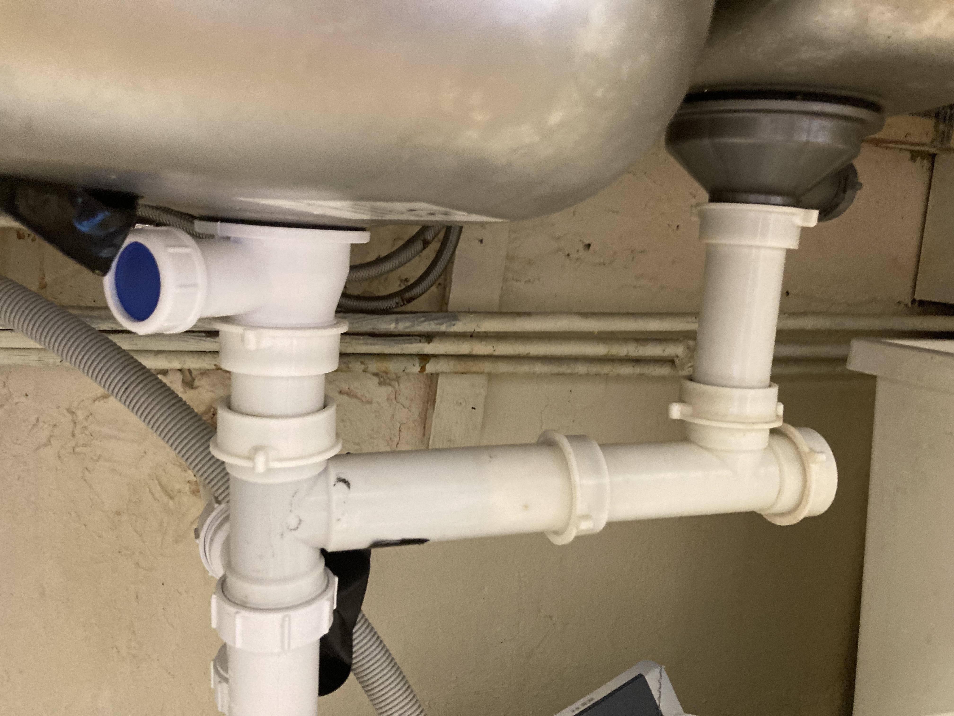

low_and_there Posted August 13, 2022 Posted August 13, 2022 Hello folks, would appreciate advice on how we can connect our dishwasher outflow pipe into the drain under the sink (photo added). The washing machine empties into a stand pipe. I’ve previously added a dishwasher into a spigot under a sink but this pipework here hasn’t got one and I can’t see how to add one.. I’d like to avoid buying a whole new under sink set there as this set up is only for about six months while we wait for planning permission to extend. thanks in advance!
joe90 Posted August 13, 2022 Posted August 13, 2022 It should connect to that blanked off bit far left of your photo, can’t find just that bit but you could use one of these and use the pipe connector only https://www.screwfix.com/p/mcalpine-v33s-compression-domestic-appliance-tee-piece-connector-white-40mm/4167P?kpid=4167P&ds_kid=92700055281954514&ds_rl=1249404&gclid=Cj0KCQjwl92XBhC7ARIsAHLl9al99MvEDW8bzYH3Ye4NlsghvxCE5GiVuPeNu8SlTZipC1bzINR2gDAaAv7EEALw_wcB&gclsrc=aw.ds 2
low_and_there Posted August 13, 2022 Author Posted August 13, 2022 26 minutes ago, joe90 said: It should connect to that blanked off bit far left of your photo, can’t find just that bit but you could use one of these and use the pipe connector only https://www.screwfix.com/p/mcalpine-v33s-compression-domestic-appliance-tee-piece-connector-white-40mm/4167P?kpid=4167P&ds_kid=92700055281954514&ds_rl=1249404&gclid=Cj0KCQjwl92XBhC7ARIsAHLl9al99MvEDW8bzYH3Ye4NlsghvxCE5GiVuPeNu8SlTZipC1bzINR2gDAaAv7EEALw_wcB&gclsrc=aw.ds thanks @joe90. trouble is that the part on the left is too close to the underside of the sink bowl to allow for an attachment like that to be added. Can I add an extender piece to take it out beyond the sink bowl do you think? Thanks!
Gone West Posted August 13, 2022 Posted August 13, 2022 This one is even cheaper. https://www.screwfix.com/p/floplast-hose-connector-40mm/48625?kpid=48625
joe90 Posted August 13, 2022 Posted August 13, 2022 1 hour ago, low_and_there said: trouble is that the part on the left is too close to the underside of the sink bowl to allow for an attachment like that to be added. I don’t understand as that’s how they are designed, it does not have to be vertical, horizontal will do for the pipe bit as it’s a pumped supply. OR will it fit to that blank below the small sink (far right?j
low_and_there Posted August 13, 2022 Author Posted August 13, 2022 1 hour ago, joe90 said: I don’t understand as that’s how they are designed, it does not have to be vertical, horizontal will do for the pipe bit as it’s a pumped supply. OR will it fit to that blank below the small sink (far right?j Ah ok, I actually thought it had to flow in vertically but if it can work horizontally then I should be able to add the fixture there. it would work on the far right side but the existing hose won’t reach that far - I imagine that there’s a possibility to extend the hose? Really appreciate your help @joe90 1
Big Jimbo Posted August 13, 2022 Posted August 13, 2022 Stick it on the one on the left. Horizontal inlet to the drain is fine. 1
joe90 Posted August 13, 2022 Posted August 13, 2022 1 hour ago, low_and_there said: I imagine that there’s a possibility to extend the hose? You can extend or get longer hoses but not worth the faff, left hand side horizontal will work just fine 👍 1
