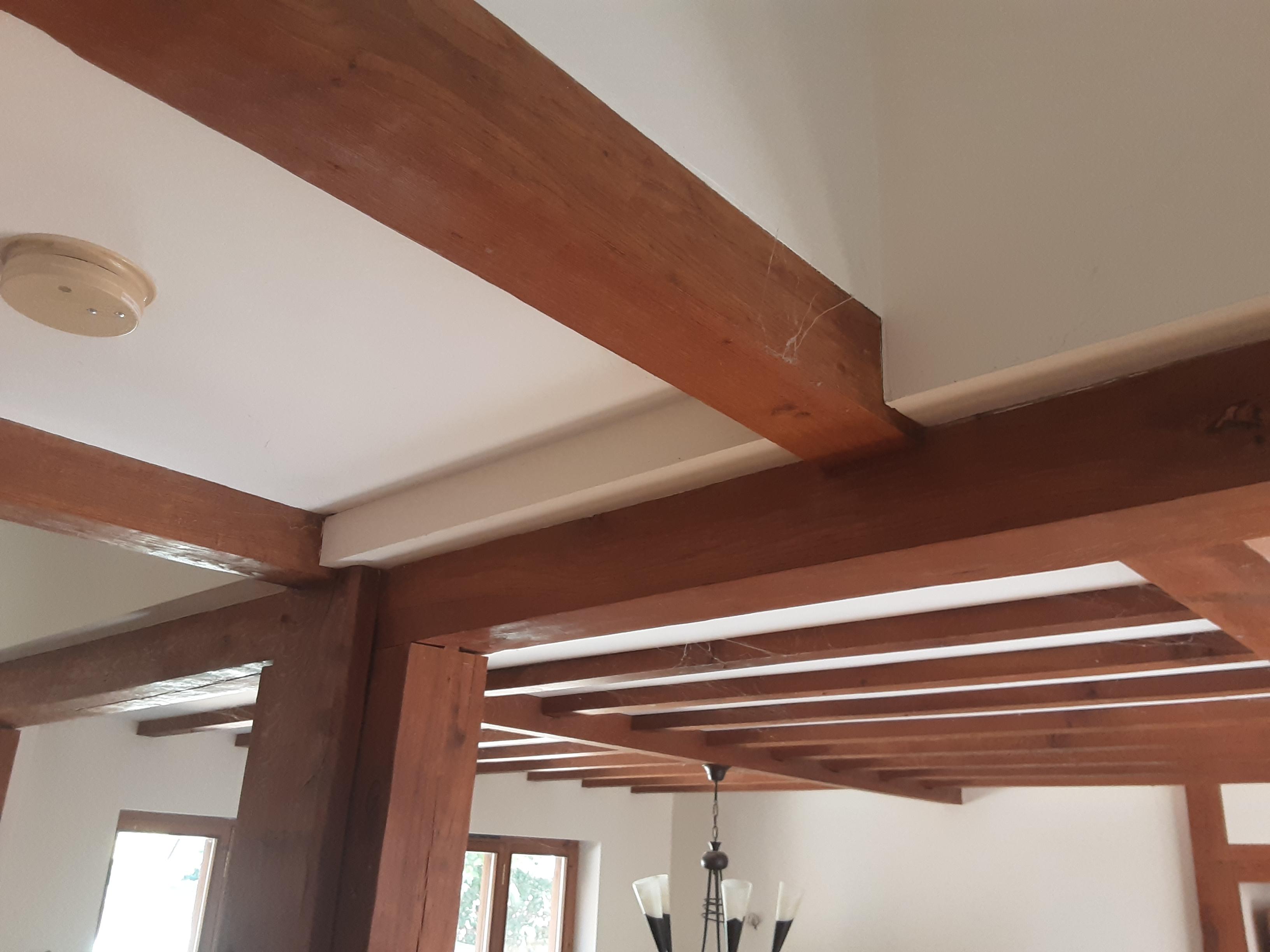

Temp Posted August 11, 2022 Share Posted August 11, 2022 This is our dining room ceiling. None of the oak is structural. It's got steel and concrete B&B floor above it. Ignore the cobwebs. Link to comment Share on other sites More sharing options...
jfb Posted August 13, 2022 Author Share Posted August 13, 2022 On 11/08/2022 at 12:35, Temp said: Have you considered a concrete structural lintel set above a decorative oak beam? I have done that on one side of the opening. On the other side its a bit trickier to use concrete as I have joists to deal with hence why steels were suggested originally. But I'm hoping the engineer will ok it as is because it will be a pain to redo! Pic 1 is side with concrete and pic 2 is without. Link to comment Share on other sites More sharing options...
