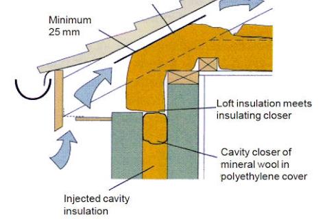

If you need to insulate between the rafters, you need a minimum of 25mm air space so 75mm PIR might work depending how much the felt sags. No battens needed, just fit the PIR flush with the bottom of the rafter, then you know there is an air gap above. Make sure you fit the PIR snuggly using expanding tape or foam. Assuming the felt is lapped, there should be adequate ventilation, no need for all those vents (IMHO!!)

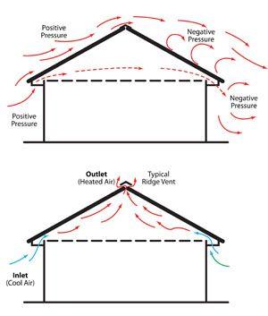

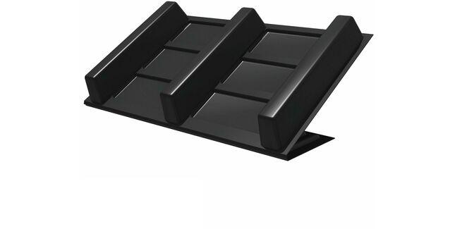

You should preserve ventilation at the eaves. Air should flow in one side of the house, across above the insulation and out the other side. There are special ventilation tunnels designed to stop insulation blocking air flow when you push it down into the eaves..
https://www.roofgiant.com/fascia-vents/refurbishment-eaves-panels-pack-of-50/

As @Temp advises there are significant potential issues with converting a roof designed for a cold/ventilated environment into one adjacent to a warm space.  You need to be aware of the associated risks, as adding insulation directly under a tiled/slated roof can introduce a leakage trap / condensation trap that can lead to rotting your roof timbers.  This risk isn't insurmountable, but needs to be addressed in your plans.  You will need to ensure good eave and ridge ventilation with a minimum 25mm and 50mm preferred air gap between the PIR and that sarking felt so that you can get a good (cold) airflow under the felt.
