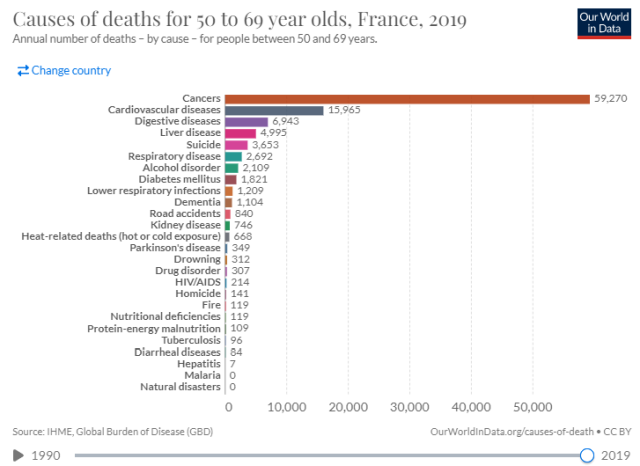

0.54/100k dying in a fire in France.
https://ourworldindata.org/grapher/fire-death-rates
5.1/100k being killed in a road related incident.
https://ourworldindata.org/search?q=transport+death+rate
There are much bigger worries than the effects of off gassing and fire.
In France, heat is more likely to kill you, as is a murderer.
