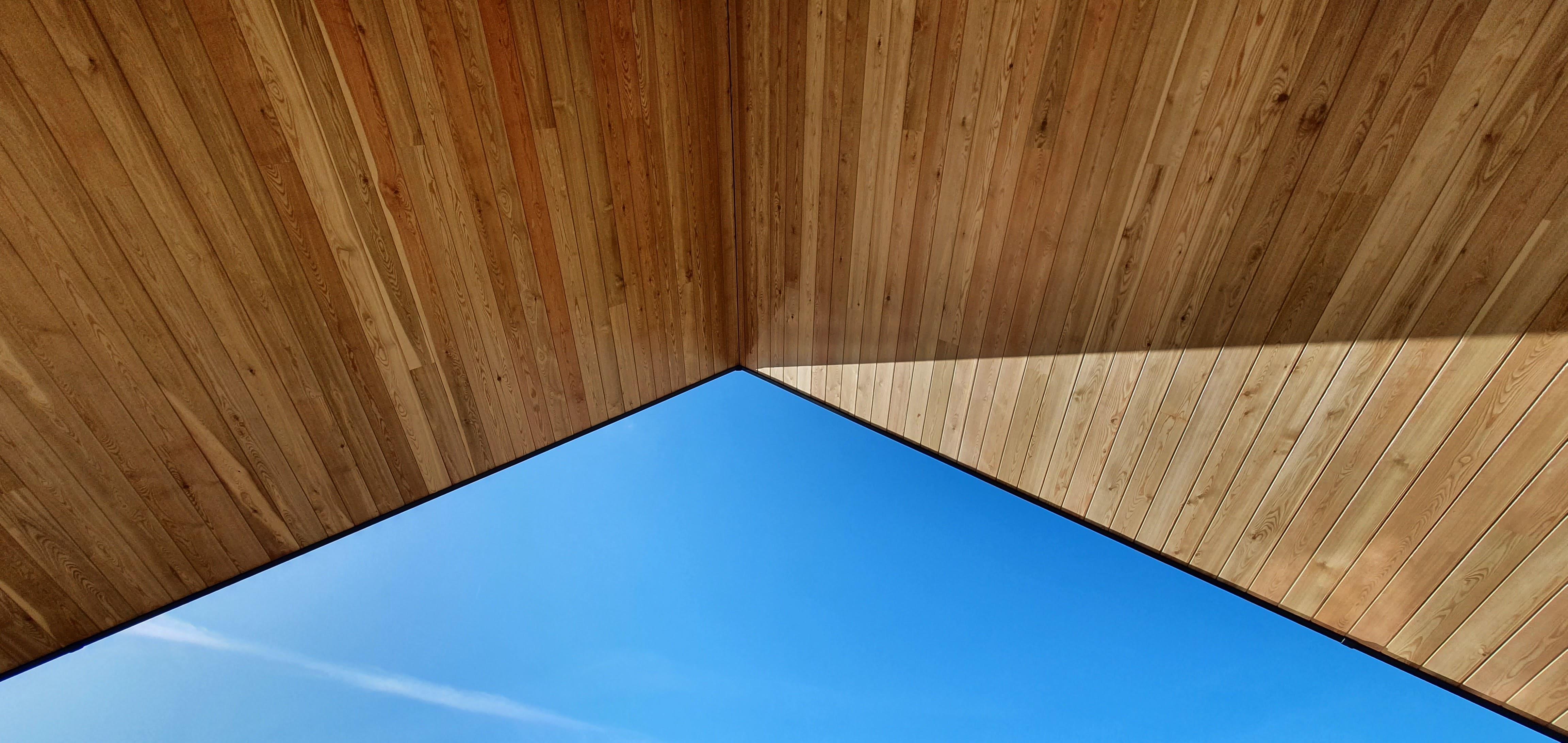

I fitted about 250sqm of Cedar using stainless steel screws. The heads disappear under the surface.

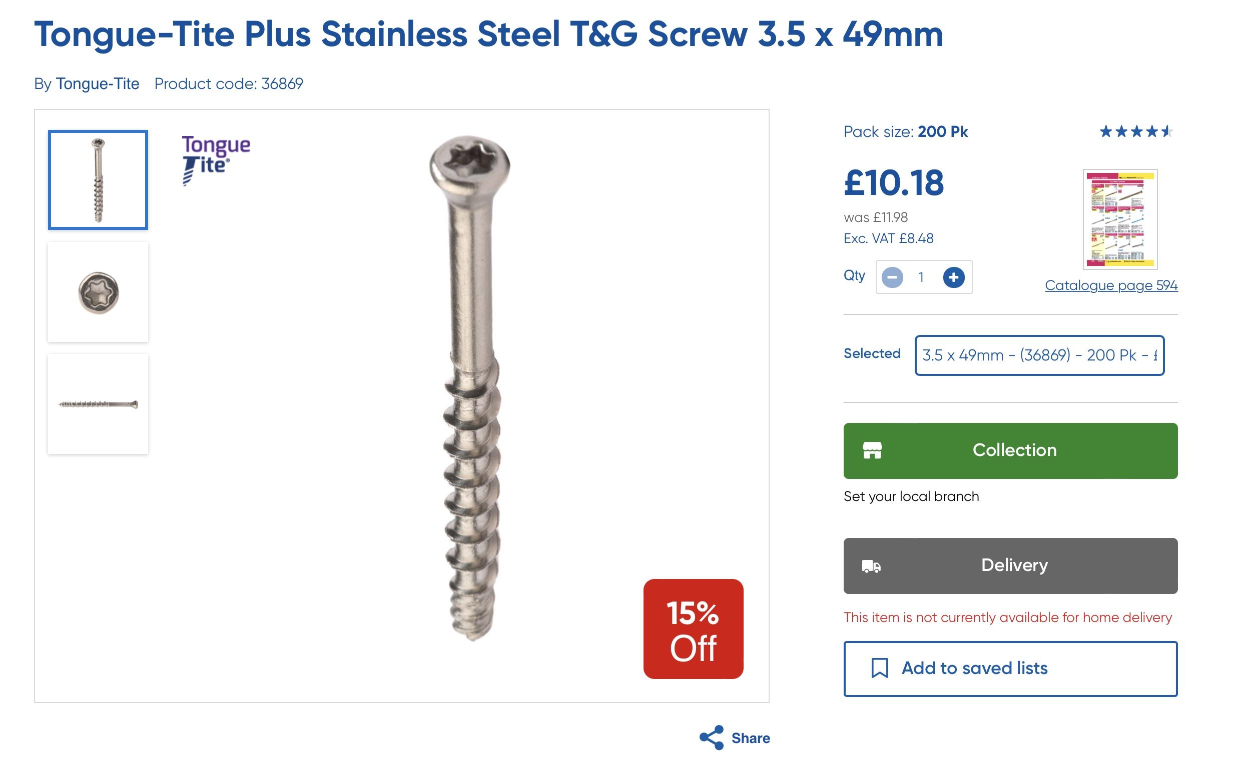

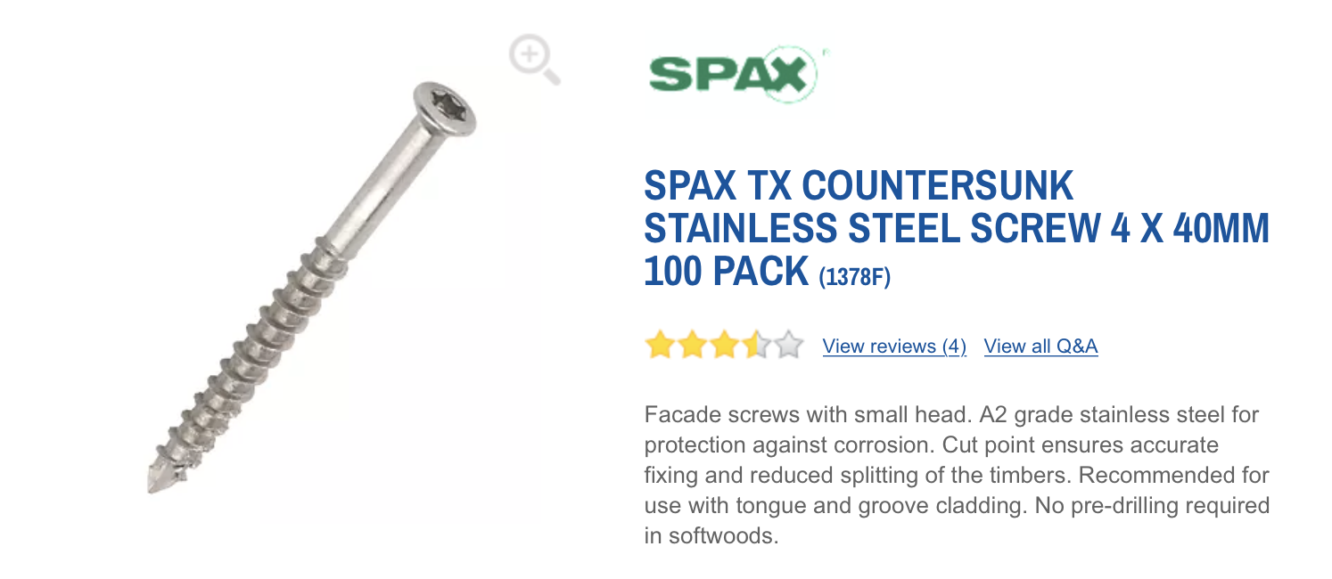

I appreciate cost is a factor. The Spax fixings are 20 pence each and I used the Tongue Tite fixings at 5 pence each from Toolstation.
I used about 3000 of the tongue tite 45mm screws on siberian larch a couple of years ago.  No issues with pull through or movement, so you should be OK with lost heads.
Interesting, if you used tongue tite did you fix them through the face of the board or through the tongue?

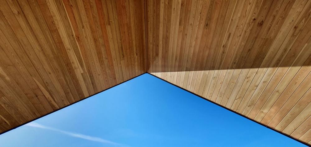

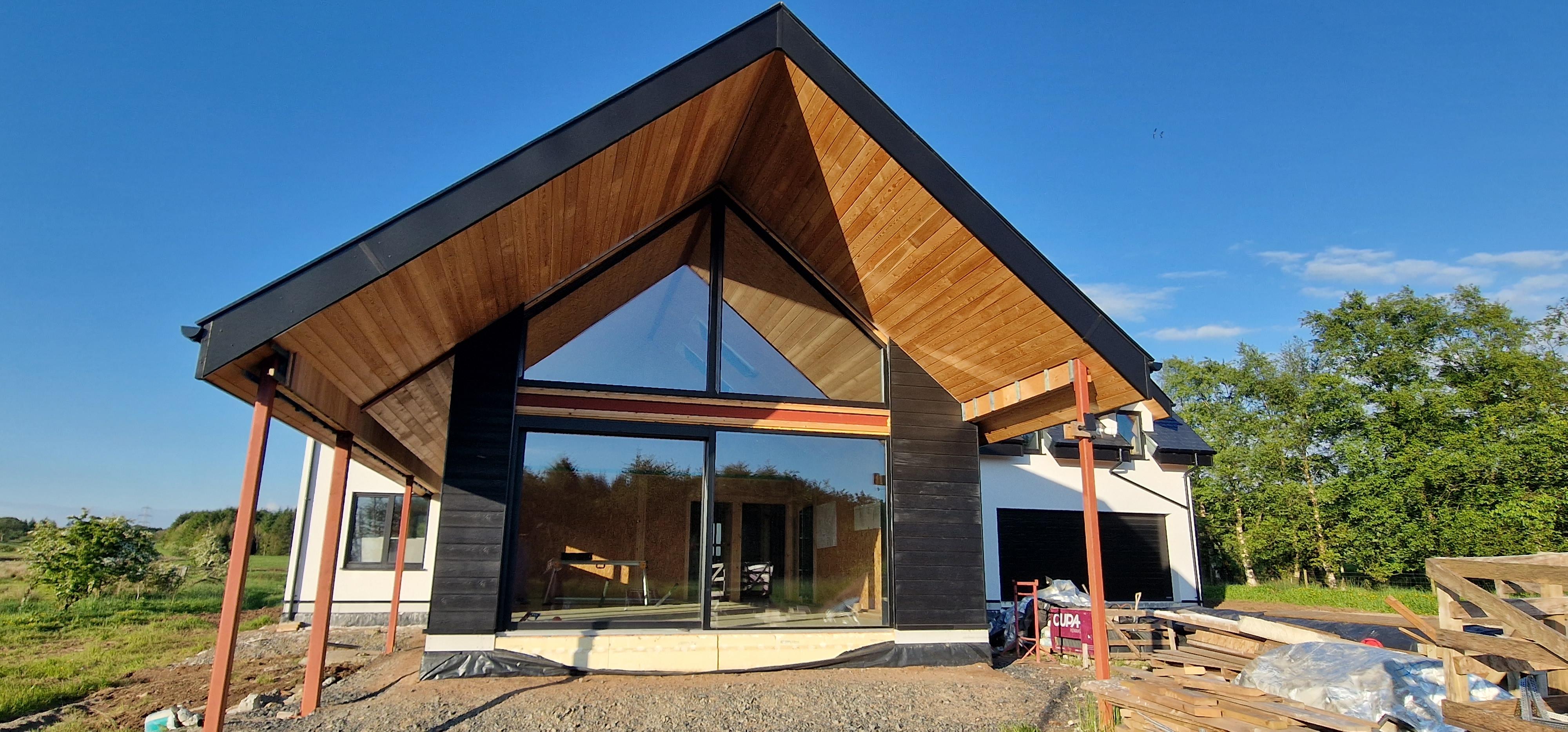

Cladding is British WRC. About 200mm wide boards fixed using Tongue Tite.
10 hours ago, Thorfun said:
through the tongue for us. chippie says not an issue as the T&G holds it all together and stops the boards curving round. ours are still being fitted so no pictures oh how they age.
Yes through the tongue is the standard why of using them, just not fully convinced that face fixing with them will be adequate, as the head is so small.
Thanks JamesP, looks good. Hardly noticeable there. Thanks
our carpenter was originally going to face fix with them but then when he saw the T&G profile he changed to fixing through the tongue. so, you can use the tongue-tites either way!

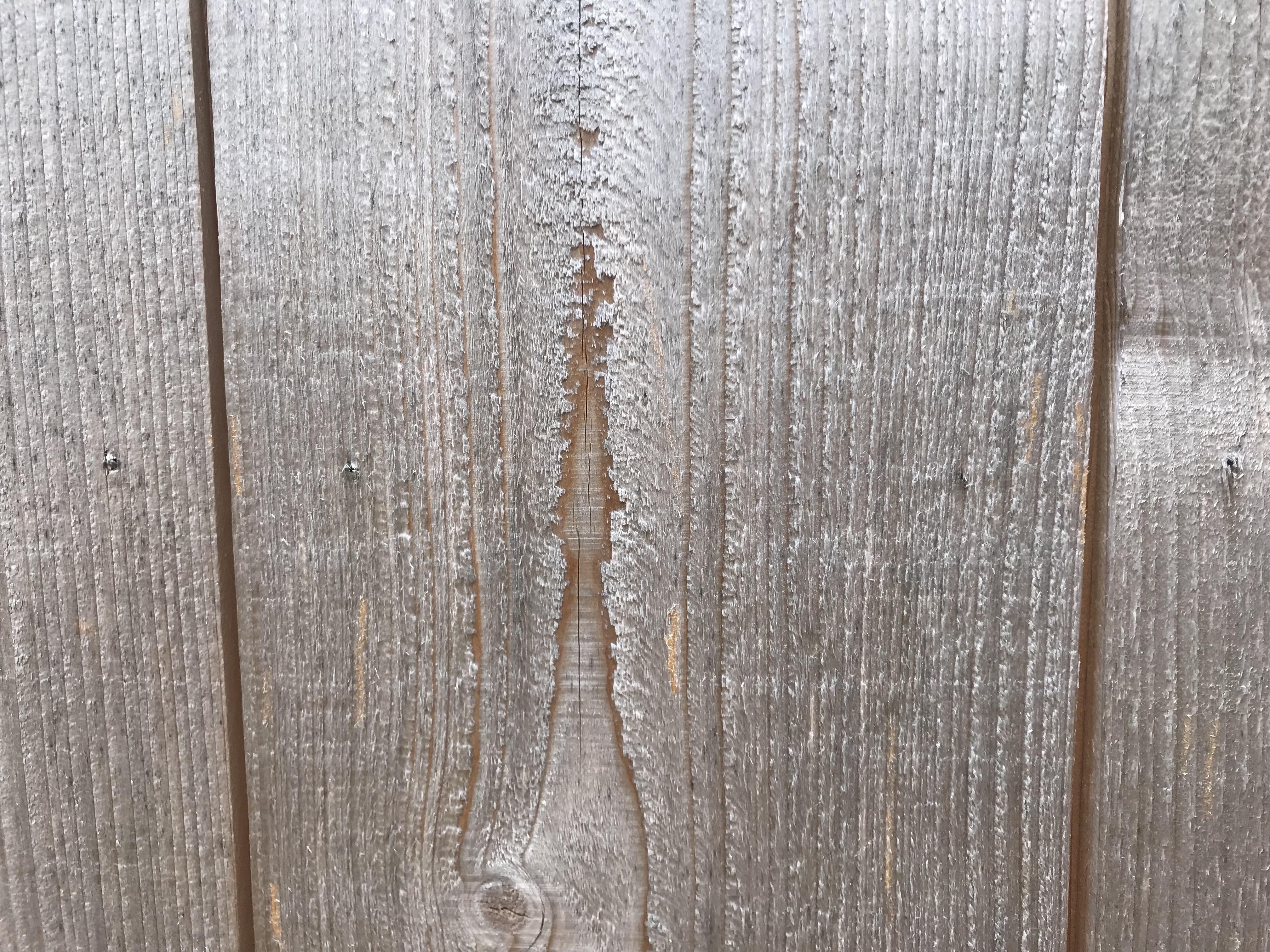

Face fixed with lost heads us7ng a paslode with no mark tip.
Use stainless steel paslode brads. Looks perfect...cannot be seen from the ground.
Don't fix them in the tongue, it's simply not required.

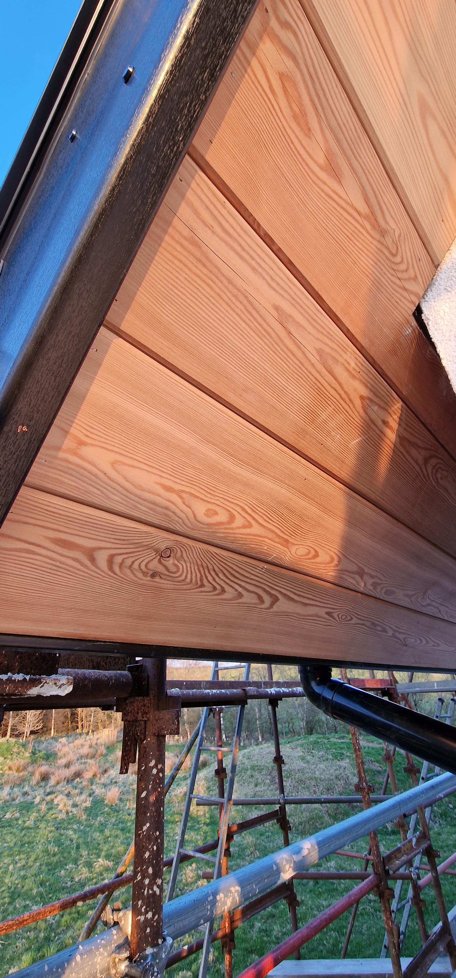

This is my siberian larch, 100m2 fitted.
