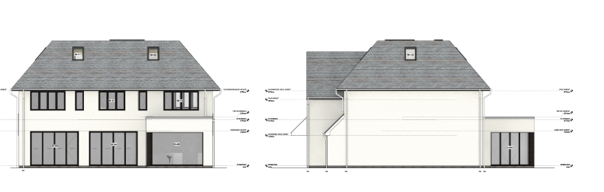

puntloos Posted July 24, 2022 Share Posted July 24, 2022 My situation: I have a crown roof design, so flat on top and SSE facing roof side (45 degree angle or so) So I also have a 45 degree E-facing and 45 degree W facing roof. Have some windows in the roof as well. - How can I maximise (without going nuts), so not N-facing side etc..) the output - How many panels can I fit around the windows, or should I reconsider the windows - flat panels on top, or no panels, or panels on stands at an angle (10 deg maybe?) Would love an advanced calculator that would let me play with these features? Or is there a professional who can help me with this? Link to comment Share on other sites More sharing options...
kommando Posted July 24, 2022 Share Posted July 24, 2022 Use the SMA design website, it will recommend one of their inverters but that's easy to find alternatives, it will take your choice of panels and the location, orientation and angles to give you the predicted outputs. You can do as many reiterations as you like until you find the best combo. https://www.sunnydesignweb.com/sdweb Link to comment Share on other sites More sharing options...
JohnMo Posted July 24, 2022 Share Posted July 24, 2022 You could actually have two arrays, one east one west, optimisers and two string inverter. Would increase your winter yields as it would give a longer solar day. Link to comment Share on other sites More sharing options...

Adrian Walker Posted July 24, 2022 Share Posted July 24, 2022 2 hours ago, puntloos said: Would love an advanced calculator that would let me play with these features? Or is there a professional who can help me with this? I use this one - https://re.jrc.ec.europa.eu/pvg_tools/en/ Link to comment Share on other sites More sharing options...

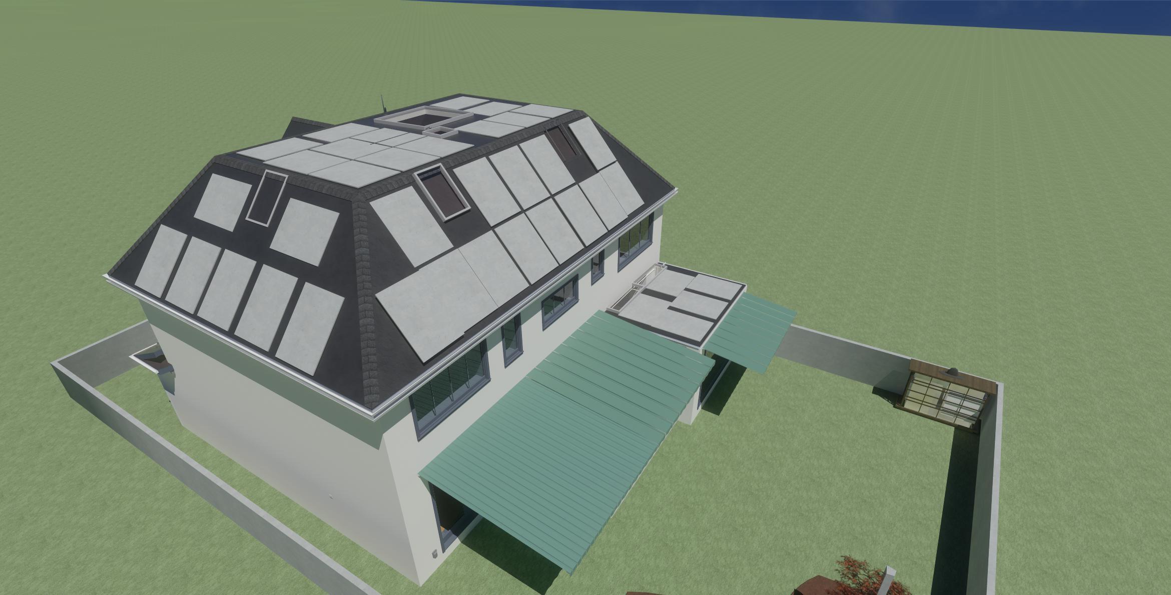

puntloos Posted July 25, 2022 Author Share Posted July 25, 2022 (edited) Doing some advanced 3D sculpting I figure i could theoretically fit 38 panels of 400W on my roof, not taking into account many practicalities such as that I'd want to sink the panels into the roof rather than bolt them on top etc. https://www.zerohomebills.com/product/tsc-powerxt-400r-pm-400w-solar-panel/ 38 panels at 216 ex = 8200 quid, total rating of about 15.2kW (400w panels) Of course that would be achieved if all panels face directly south, and in fact none of the panels face south, rear faces SSE.. not likely, but perhaps I can achieve 12kW? Still pretty hefty. Am I right that that's overkill unless I buy tons of batteries? When is it 'too much'? Edited July 25, 2022 by puntloos Link to comment Share on other sites More sharing options...

JohnMo Posted July 25, 2022 Share Posted July 25, 2022 You will generate loads of excess power in the summer, but you load limit that if you want, or export if allowed. In the winter when production is rubbish, you will still have your base loads covered and plenty of hot water by driving your heat pump. Link to comment Share on other sites More sharing options...
Dillsue Posted July 25, 2022 Share Posted July 25, 2022 9 hours ago, puntloos said: Of course that would be achieved if all panels face directly south, and in fact none of the panels face south, rear faces SSE.. not likely, but perhaps I can achieve 12kW? Still pretty hefty. Am I right that that's overkill unless I buy tons of batteries? When is it 'too much'? Having your panels facing different directions gives a longer spread of generation which could be more useful than a massive peak depending on your motivation for installing PV Whether 15kwp is "too much" depends on your motives and set up. In the summer youll likely have too much for self use but in the winter you could cover much of your usage if you have a battery bank. Batteries come with a big environmental footprint, so a consideration if one of your motives is environmental. A long spread of generation may negate the need for batteries or allow a smaller battery pack. If youre happy for excess to go to the grid, and the grid can handle it, then youll never have too much and a gas power station can throttle back a bit on sunny days. On the flip side, if you want to keep everything yourself youll likely need batteries, PV diverters, an EV etc to grab as much as you can 2 Link to comment Share on other sites More sharing options...
