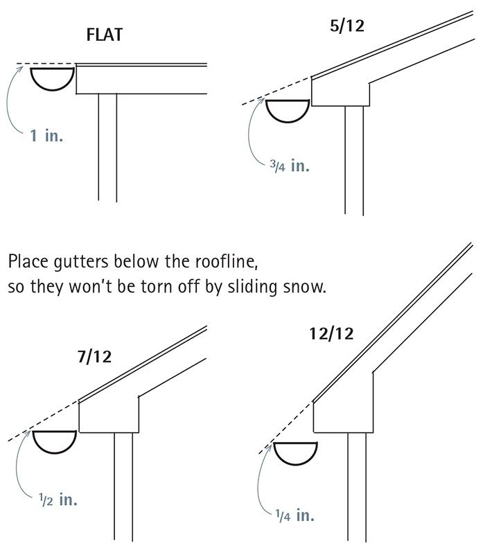

Roof slope is 9:12 (37 degrees) and they would be positioned low enough to avoid being town off by falling snow.

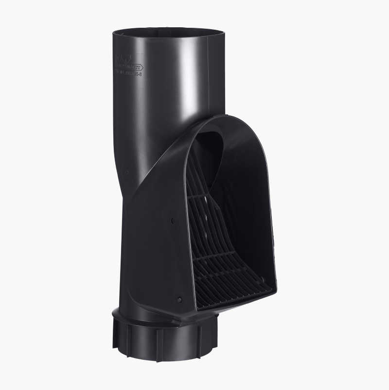

Allowing the ends of the gutters to overflow on one end or fall into a hopper of some kind wouldn't be a big deal. Allowing them to overflow in occasional heavy rain wouldn't be a big deal. Don't know is this makes any difference capacity wise for having them level vs not level.

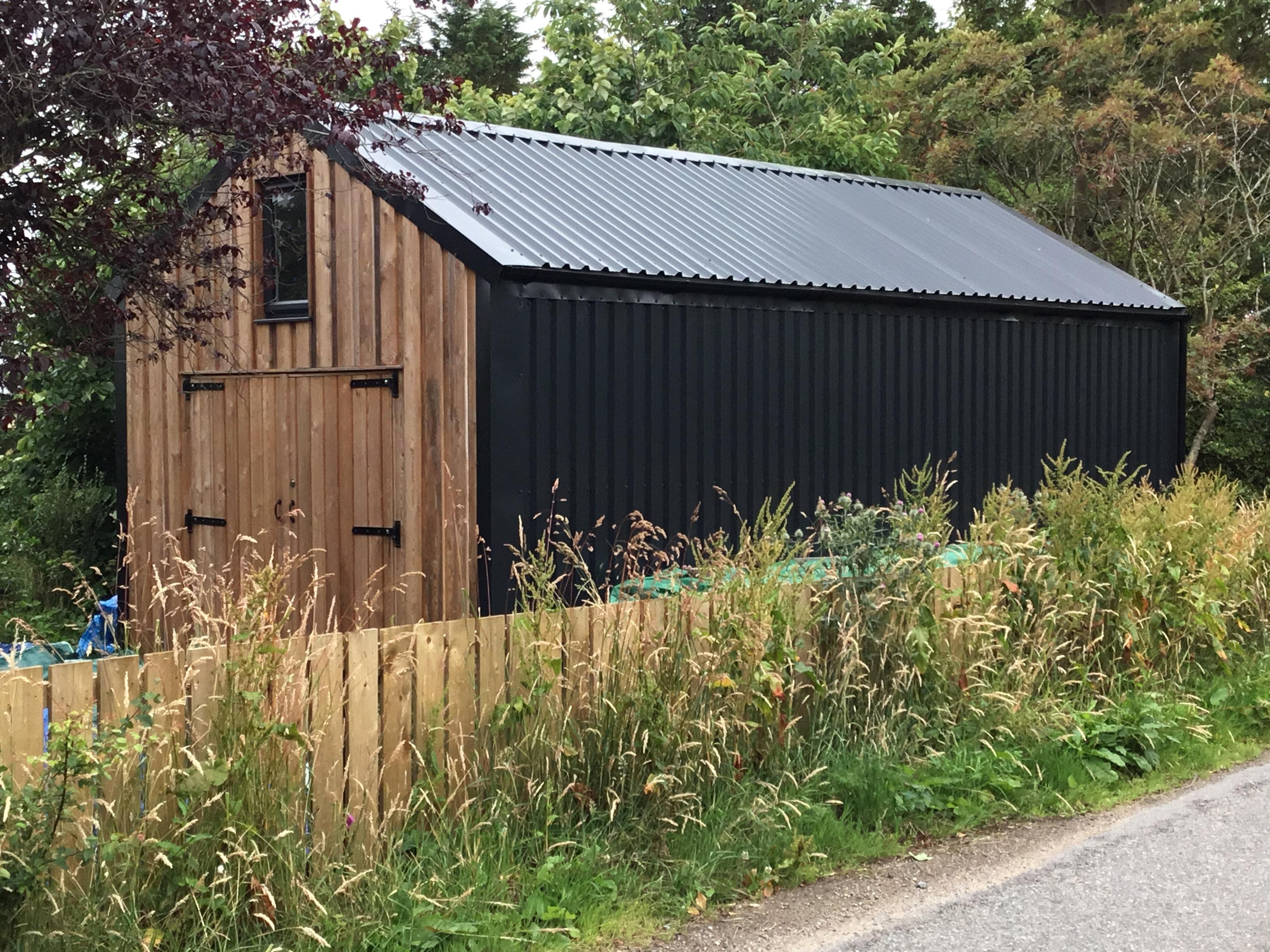

When I was building my posh barn/garage/shed I had same dilemma.  I ended up going for the required fall on the gutters.  Can you see the fall visually? Yes, if you look for it.  Does anyone else see that fall? No. I went for function over form.  I had black plastic gutters against dark box profile per picture below.  Not dissimilar to your property, style wise with box profile roof and sides.
I have galvanised gutters against anthracite roofline on the house.  Don’t notice the fall at all but the house is taller.
The way I see it is the gutters are there for a reason.  Having something unlevel in my view is ok if it’s designed to be unlevel, like gutters.
Your property is beautiful.  Everyone’s eyes will be drawn to the whole building, not the gutters.  Especially if they are similar colour to the box profile.
Thanks @Bozza
I have little visual imagination / taste myself and am more trying to avoid having to do build everything two or three times courtesy of an "eew; no; what have you done" from she who must be obeyed than I am enjoying obsessing over these details...
Your barn / garage / shed is prefect thanks. I see the fall a mile off but it doesn't look wrong. How big is it and over what distance can I ask? I'm guessing 50 mm over 10 metres on about a 3 metre high eave?
Do you have any drawings for the shed that I could pinch actually?

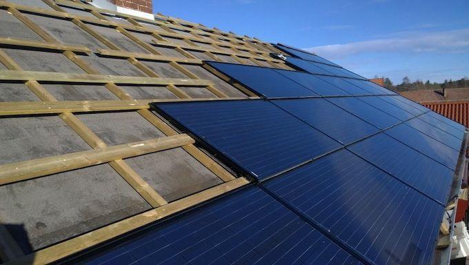

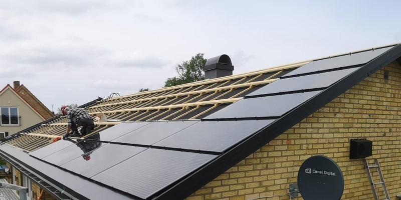

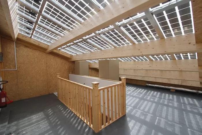

I will be suggesting a pure-pv roofed wriggly tin walled structure on the plot to house the pv and a lawnmower and any other treasure that I can no doubt collect once the house is finished...my suggestions for which will probably be rejected on the grounds of looks...and yours looks rather nice if I dare say so!
Pure-pv roofing meaning fitting the things as if they were regular tiles having largely setup your structure / overhang to suit the panels:

My barn is 8m long can’t remember the fall but it was the min requirement for guttering whatever that is.  Sorry don’t have formal plans I built it by hand and within sizes that it didn’t need planning permission etc.

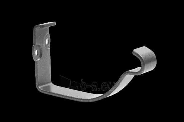

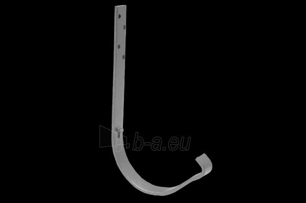

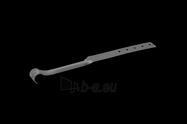

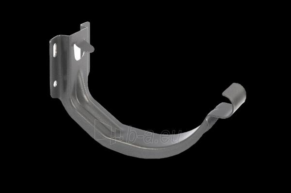

Ruukki offer a bigger range of brackets. From thin stamped ones for hot country use through adjustable angle ones to hulking great 4 mm thick jobbies:
image.png.d00db9d54ec33302316547f060db6372.pngimage.png.32fb74fb9cb1c930001adac84700dea6.pngimage.png.5c704851a6efacfcf2a72198d49152a2.pngimage.png.baf5558837475e9f25334ca6247a90cb.png
They offer other bits like the paint and the leaf separator widget too.
https://stogupartneris.lt/ruukki-stogo-sandarinimo-priedai/280-22625-ruukki-dazai-100-ml.html
Struga offerings look more basic. The option of a top restraint is interesting - mounted of the top of rafters it helps stop falling snow peeling the gutters off.
https://bustostilius.lt/struga/latako-laikiklis-compact-ral-9002-264

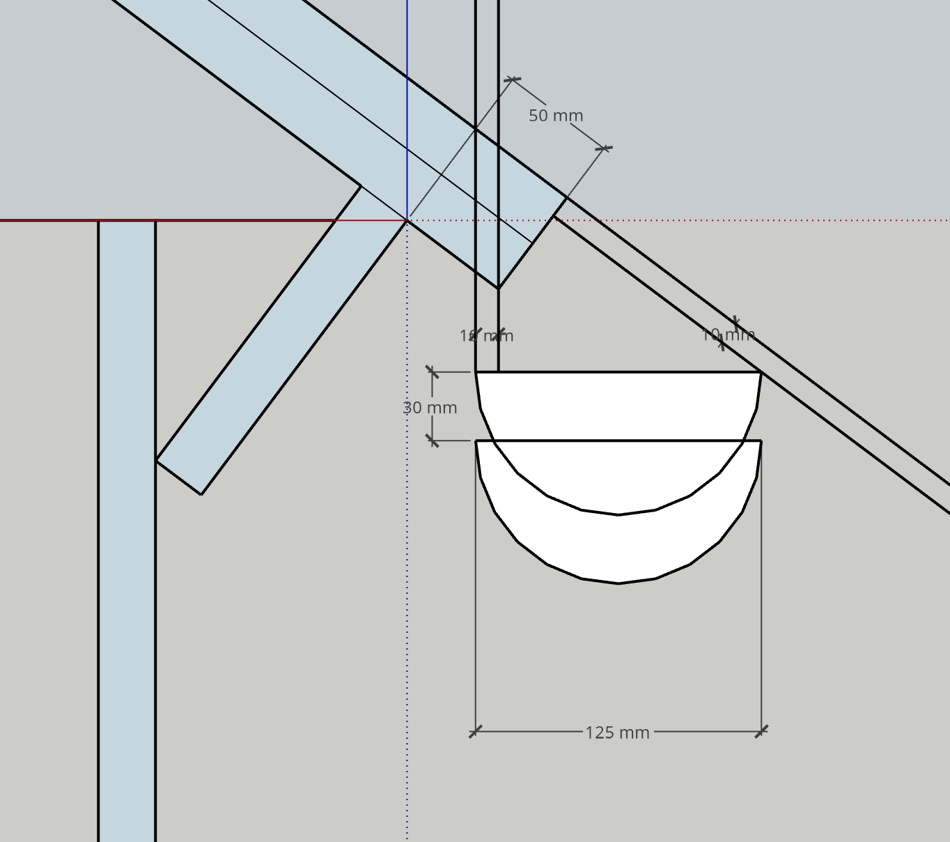

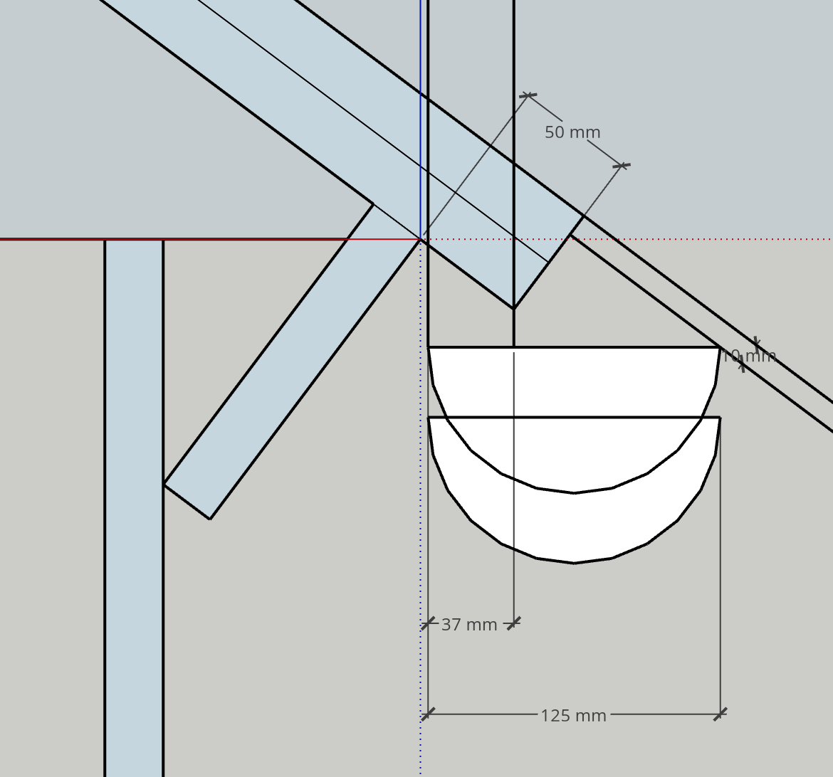

Can I get feedback on more overthinking please?
Ho far should these sit from the (non existent) fascia / relative to the roof edge?
Option 1: place gutters 10 mm below "top" of roof covering (avoid snow ripping them off) and 10 mm set back from the "drip edge" of the roof covering nearest the wall. Shown with 30 mm total fall from highest to lowest point.
619290331_Screenshot2022-07-26at20_05_50.thumb.png.907b0bd1522c002151f692f9dd0bb3f1.png
Option 2: place gutters 10 mm below "top" of roof covering (avoid snow ripping them off) and 37 mm set back from the "drip edge" of the roof covering nearest the wall. Shown again with 30 mm total fall from highest to lowest point. 37 mm was an arbitrary "looks about as much as I could get away with"
1437282636_Screenshot2022-07-26at20_07_33.thumb.png.730a233f6b7308fc64db6486d22500c7.png
MOST of the water would run down the middle of that roof covering (the less bold line) in heavy rain.
SOME will drip off the very bottom edge. SOME may run off the top edge but that would have to be exceptional rain.
SNOW risk is pretty much all from the very top face. If you imagine a 25 mm thick clay tile with 25 mm of waviness that's about what we have.
The Ruukki guidance is silent on this positioning as their roof thickness is effectively zero. I've not found something decent yet.

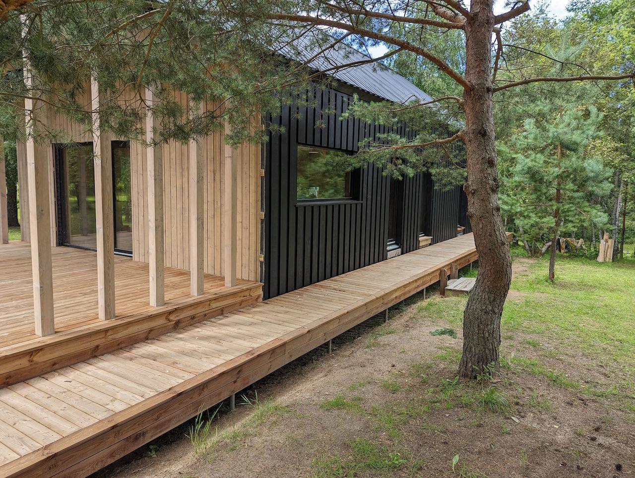

  • 1 year later...
FYI - yes you can see it at 4 mm / metre, no you don't hate it, and no it isn't enough to ensure that the gutters are dry after rain but it's probably enough to ensure that there's not enough standing water for mosquitos:
Next up...getting the heating running!
Link to comment
Share on other sites
2 hours ago, Eric said:
@markocosic gutters look fine, building looks spectacular 👌🏻
Is that larch boards? Are they stained \painted?
I'll let my wife know 😉
Rough cut pine / spruce. Graded. Grooved. Primed. Painted. Never again.
Use Ruukki roof or full-PV roof and pre-painted pre-machined thermowood boards intended for cladding and save your sanity. 😉
  • Like 3
