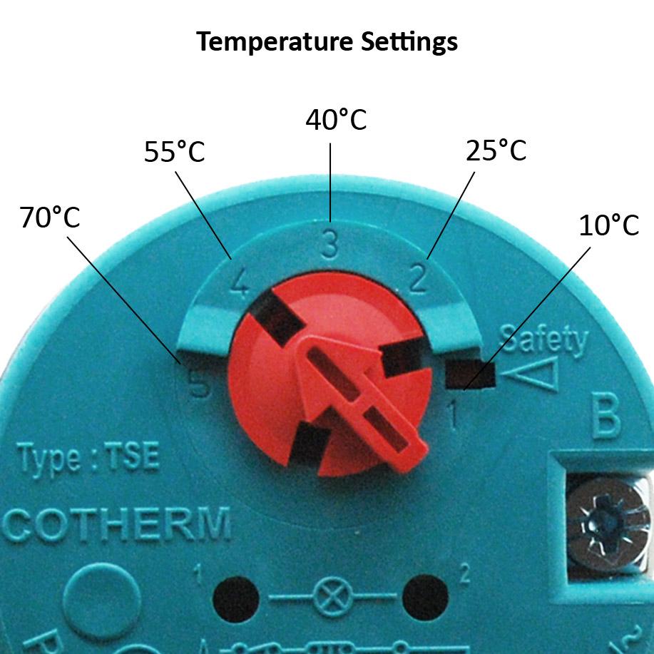

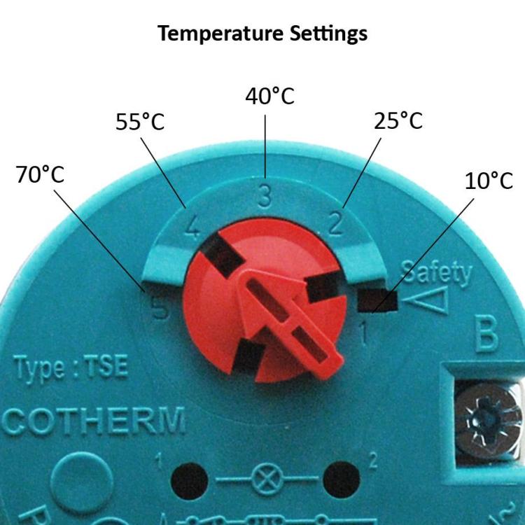

Barryscotland Posted July 23, 2022 Author Share Posted July 23, 2022 41 minutes ago, ProDave said: ^^^ Peter's post above also shows it is the left hand thermostat that is the cylinder thermostat for the boiler, and that is the one you want to turn down to a lower temperature, say 50 degrees. (the right hand one is the thermostat for the immersion heater) So run the system so the hot water is on. Turn that left thermostat down until it clicks, then the boiler and the pump should stop. If it does that, then chances are it is wired correctly. You should also hear the motorised valve spring shut when the thermostat clicks off. The cylinder thermostat should always be set lower than the boiler flow temperature. presuming the bottom left red dial is stat boiler is wired through as did as you suggested, had hot water on demand and turned dial when on 3 the zone valve clicked and when got to the boiler it was off so presume it is wired properly and that the problem is the stat is set too high? Anybody no what temps the 1 2 3 4 5 relate to? Link to comment Share on other sites More sharing options...
kommando Posted July 23, 2022 Share Posted July 23, 2022 Googling Cotherm type TSE got me to Link to comment Share on other sites More sharing options...
ProDave Posted July 23, 2022 Share Posted July 23, 2022 The red dial in the middle of the blue round thing is the immersion heater thermostat, NOT the cylinder stat for the boiler. That should make no difference to the heating. Yours appears to be wired / constructed differently to the manual @PeterW posted. you have TWO tank thermostats for the boiler. They are both mounted in that metal plate at the top. The right hand one has a dial 1,2,3,4,5 and that is the cylinder thermostat that will shut off the boiler when the tank gets up to temperature. It currently looks to be set to setting 4. that is the one you want to turn down while it is running to see if the boiler then shuts off. The other one to the left is the safety cut out. In the event of the main thermostat failing and the water getting too hot, that will trip and the red button will pop out. You can usually reset that by pushing the red button in again. Link to comment Share on other sites More sharing options...
