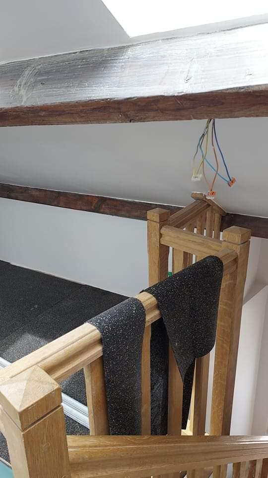

Garald Posted July 21, 2022 Share Posted July 21, 2022 The attic in the place I've now got has a very creaky floor - to say that one can hear every step while in the floor below is a severe understatement. It's an attic that was made inhabitable by previous owners; part of the problem is that they put a laminate floor on top of wood, apparently badly. We will fix that, but we want to go much further in minimizing noise. (The floor below has what will be my library/piano room!) I was just proposed something that contains rock wool (https://www.fermacell.fr/fr/produits/plaques-de-sol/plaque-de-sol-avec-laine-minerale). However, the attic will consist mainly of bedrooms, and I've been avoiding rock wool overall, in part because it seems fairly clear that it can cause lung injury. (It is not remotely as bad as asbestos, and it may or may not be a carcinogen, but, given that I have a touch of asthma, and that it is a family thing...) What are some alternatives without rock wool, of similar or higher effectiveness? (We would like to lay actual hardwood on top of the insulation layer.) Link to comment Share on other sites More sharing options...

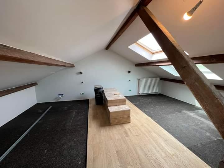

Garald Posted May 30, 2023 Author Share Posted May 30, 2023 Update: the contractor treated the floor in some way and then put in some sort of magical squishy membrane before laying hardwood. Apparently it all works nicely (I last was on site after they started laying flooring but before they finished). Maybe the material used looks familiar? Link to comment Share on other sites More sharing options...
Big Jimbo Posted May 30, 2023 Share Posted May 30, 2023 That to me looks like a kind of underlay that seems to be made of crumbed rubber. It is often used within the recording industry. Bloody heavy if i remember correctly. Link to comment Share on other sites More sharing options...
Garald Posted May 30, 2023 Author Share Posted May 30, 2023 Heavy is good for this purpose, no? Only mass stops lower-frequency noise. Link to comment Share on other sites More sharing options...
