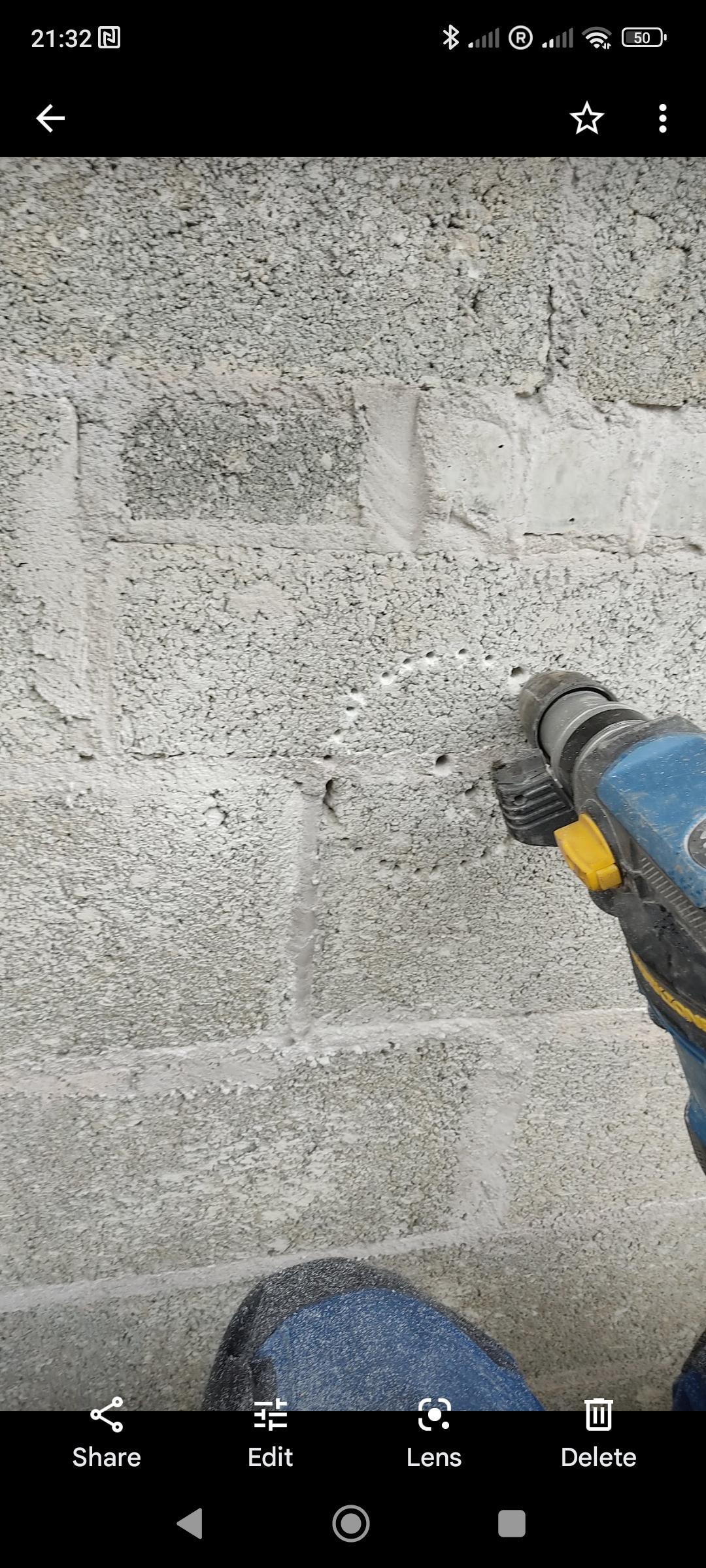

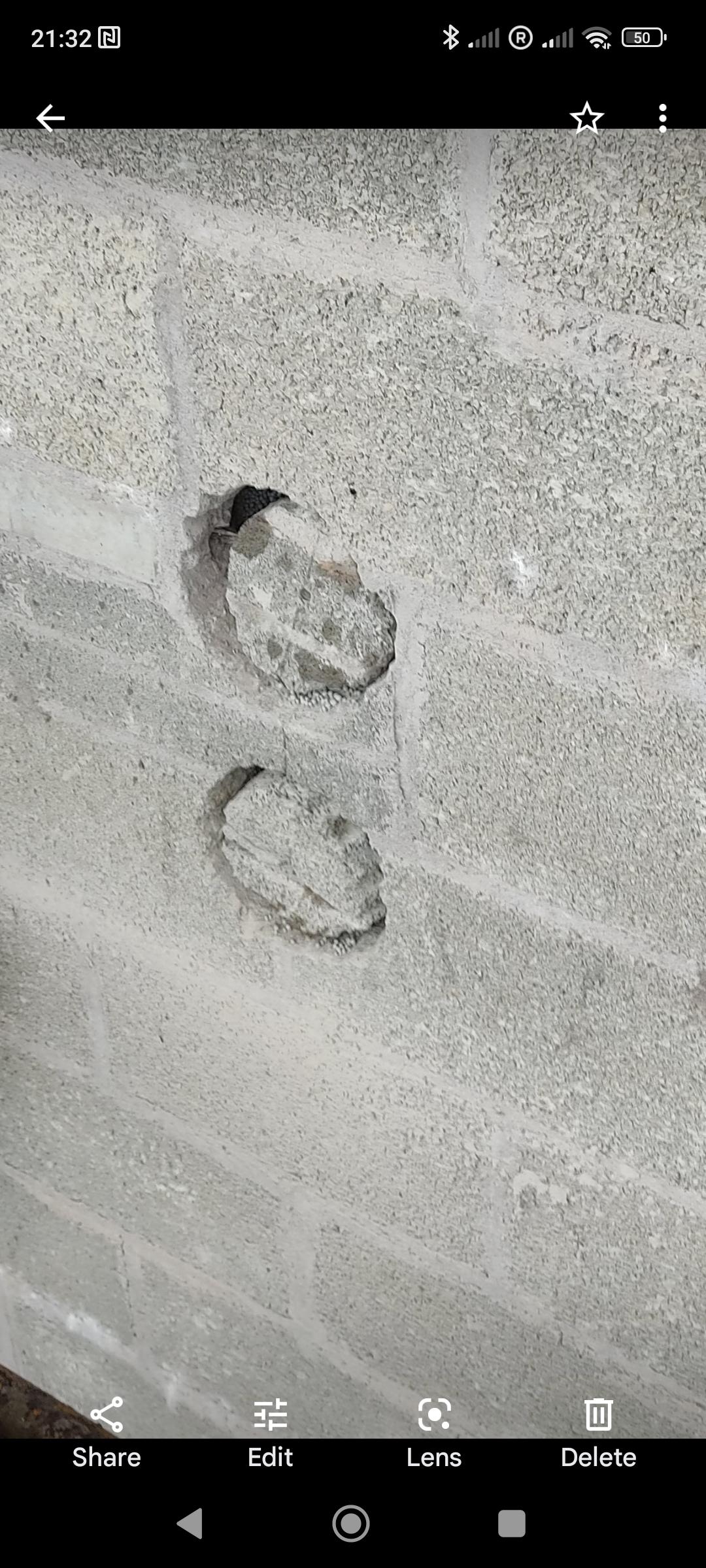

I pilot driled all the ways through. Then stitch drilled from both sides and chiseled out to finish. didn't have a 200mm core and love suffering.
It was a PITA. Screenshot_2022-08-13-21-32-54-726_com.google.android_apps.photos.thumb.jpg.dfee7a7cd40e7b939fee819cfb8d3772.jpg all done pre plastering.
Made the hole good with some sand and cement and airtightness paint.
