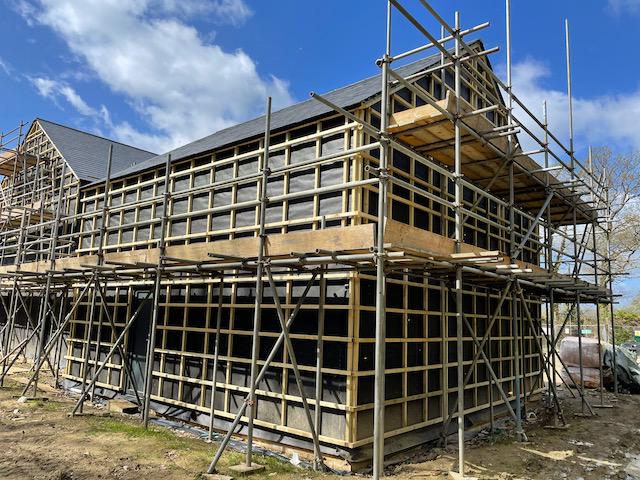

Tom Posted June 28, 2022 Posted June 28, 2022 Can anyone recommend a black vapour-permeable membrane to cover ICF walls? Black cladding will have gaps so the membrane will be just about visible through, so need it black and preferably without any printing. Thanks all

Thorfun Posted June 28, 2022 Posted June 28, 2022 we used Tyvek UV Facade (https://www.dupont.co.uk/products/tyvek-uv-facade.html) even though in the end we didn't do a traditional shadow gap and went for a tongue and groove shadow gap as we didn't fancy painting all the battens black to hide them through the black cladding!
Tom Posted June 28, 2022 Author Posted June 28, 2022 Thanks both. Stupid questions: does this get fitted horizontally or vertically? If I'm having vertical timber cladding, guess I will have a vertical batten then a horizontal counter-batten then clat on to that and the membrane go over the top of the vertical batten?
bob the builder 2 Posted June 28, 2022 Posted June 28, 2022 Hi all I am currently going with a Glidevale Protect 5000 product Protect 5000 Façade wall membrane - Glidevale Protect Would appreciate your thoughts on this vs other out there Thanks Bob
Thorfun Posted June 28, 2022 Posted June 28, 2022 33 minutes ago, Tom said: Thanks both. Stupid questions: does this get fitted horizontally or vertically? If I'm having vertical timber cladding, guess I will have a vertical batten then a horizontal counter-batten then clat on to that and the membrane go over the top of the vertical batten? the membrane is fitted horizontally. ours was fitted to the external OSB of the timber frame. we then battened and counter battened on top of the membrane. we're also having vertical cladding e.g. I do know someone who mistakenly had the Glidevale silver membrane and were having a shadow gap so they applied the black membrane on top of the horizontal battens which meant they didn't need to paint the battens. but they did check with the manufacturers of both membranes to ensure that there would be no issues having the 2 layers of membranes, which there wasn't but if you're doing that then I would advise checking with the manufacturers of your chosen membrane(s)
Nestor Posted June 28, 2022 Posted June 28, 2022 1 hour ago, Tom said: the membrane go over the top of the vertical batten? Underneath both battens.
