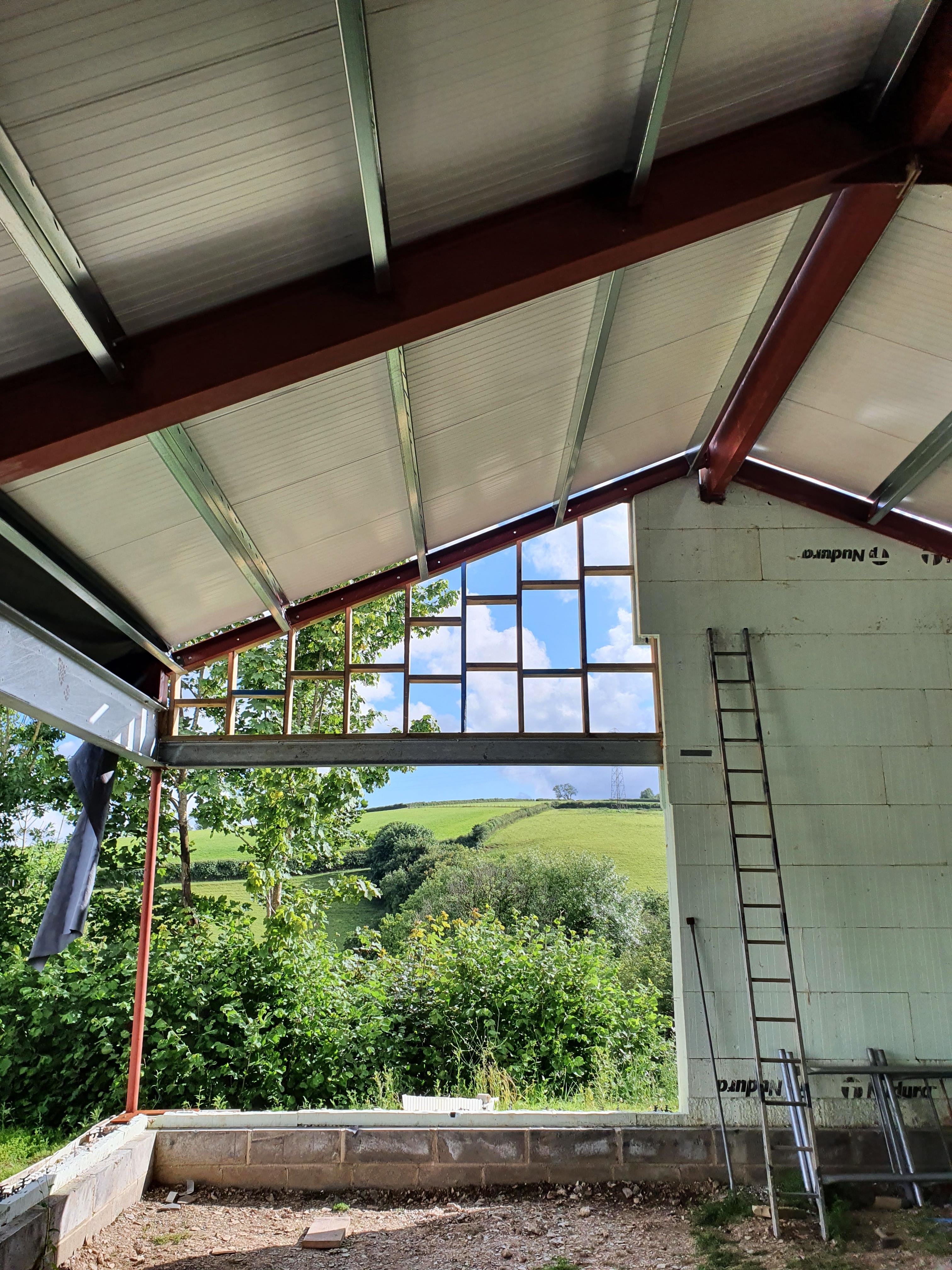

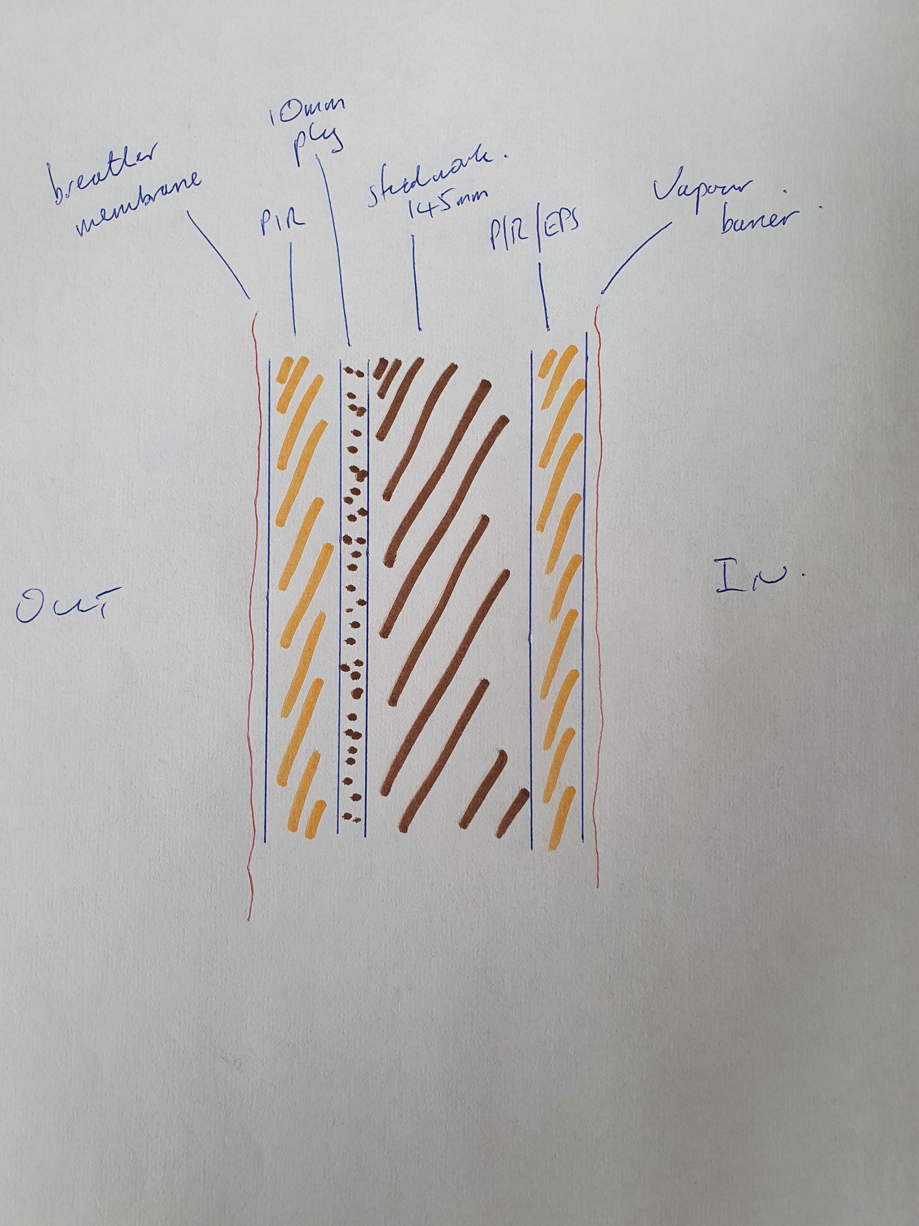

Tom Posted June 28, 2022 Share Posted June 28, 2022 Hi all - I need to construct a timber studwork gable end that continues on from a Nudura ICF wall over one of our cantilever steels. See pic. The concrete core of the ICF is approx 145mm so I've used the same width timber and plan to put some ply on the outside surface for rigidity, then 90mm PIR screwed on to this to make up the wall thickness to match the ICF. The interior surface would be covered in similar insulation with rockwool between the studs, see diagram in second post. I was going to put a breather membrane over the outside and vapour barrier on the inside. Does this sound right? Link to comment Share on other sites More sharing options...

nod Posted June 28, 2022 Share Posted June 28, 2022 Have you considered Met set Metal frame Stronger straighter and easier to work with than timber Link to comment Share on other sites More sharing options...
Russell griffiths Posted June 28, 2022 Share Posted June 28, 2022 Why pir, why not eps to match the icf, Link to comment Share on other sites More sharing options...
Tom Posted June 28, 2022 Author Share Posted June 28, 2022 17 minutes ago, nod said: Have you considered Met set Metal frame Stronger straighter and easier to work with than timber No I didn't tbh, but have done the studwork now 14 minutes ago, Russell griffiths said: Why pir, why not eps to match the icf, No reason tbh, other than being a better insulator. Link to comment Share on other sites More sharing options...
