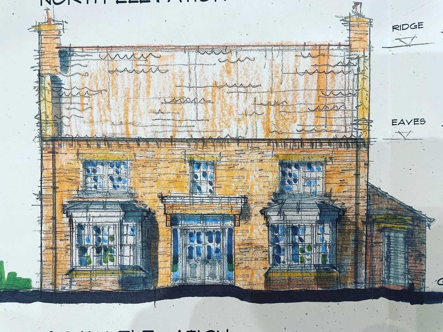

MMcGill Posted June 16, 2022 Posted June 16, 2022 Hi all, I’ve scoured the forum but struggling to find a view of good suppliers for traditional style but efficient windows. We’ve recently secured planning permission but the new house will be on a fairly traditional street therefore the front has to blend in - we’ve got an allowance for ‘wood effect’ windows at the front so at least have flexibility there, but I’m trying to make this new house as energy efficient as possible. I’m struggling to find a supplier beyond the usual UPVC candidates that supply a good looking window with low U-value (triple glazed). we’re based near York. Any pointers appreciated! 1
Radian Posted June 16, 2022 Posted June 16, 2022 (edited) I wouldn't totally discount timber framed windows myself. Wooden frames have comparable U-Values to UPVC. I've seen some that perform better. My preference for them is based on appearance - UPVC always come out bulkier with less area for the glass for a given sized wall aperture. As for maintenance, yes they need an application of good quality exterior paint once in a while, but regular washing down can reduce the frequency. All UPVC windows that I've had experience of have become scruffy on similar time frames but then there's little that can be done to rejuvenate them after that. PS your house looks a little bit like mine. Square leaded windows just don't sit right in UPVC IMO. Edited June 16, 2022 by Radian

jayc89 Posted June 16, 2022 Posted June 16, 2022 Looks lovely. We're only ~ 20 miles outside of York and in need of windows of a similar style so will be watching this thread with some interest
craig Posted June 16, 2022 Posted June 16, 2022 Looks lovely, I do like a bit of traditional builds blending into the existing area. If you have a look around, you'll find suppliers that are able to help.
