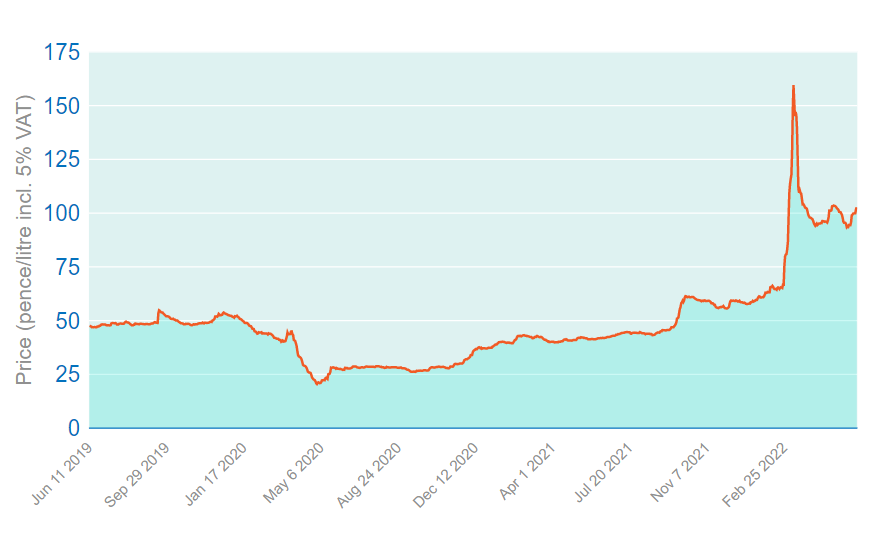

PS I hope you bought your heating oil at not-the-wrong-time. It's been a touch variable !
