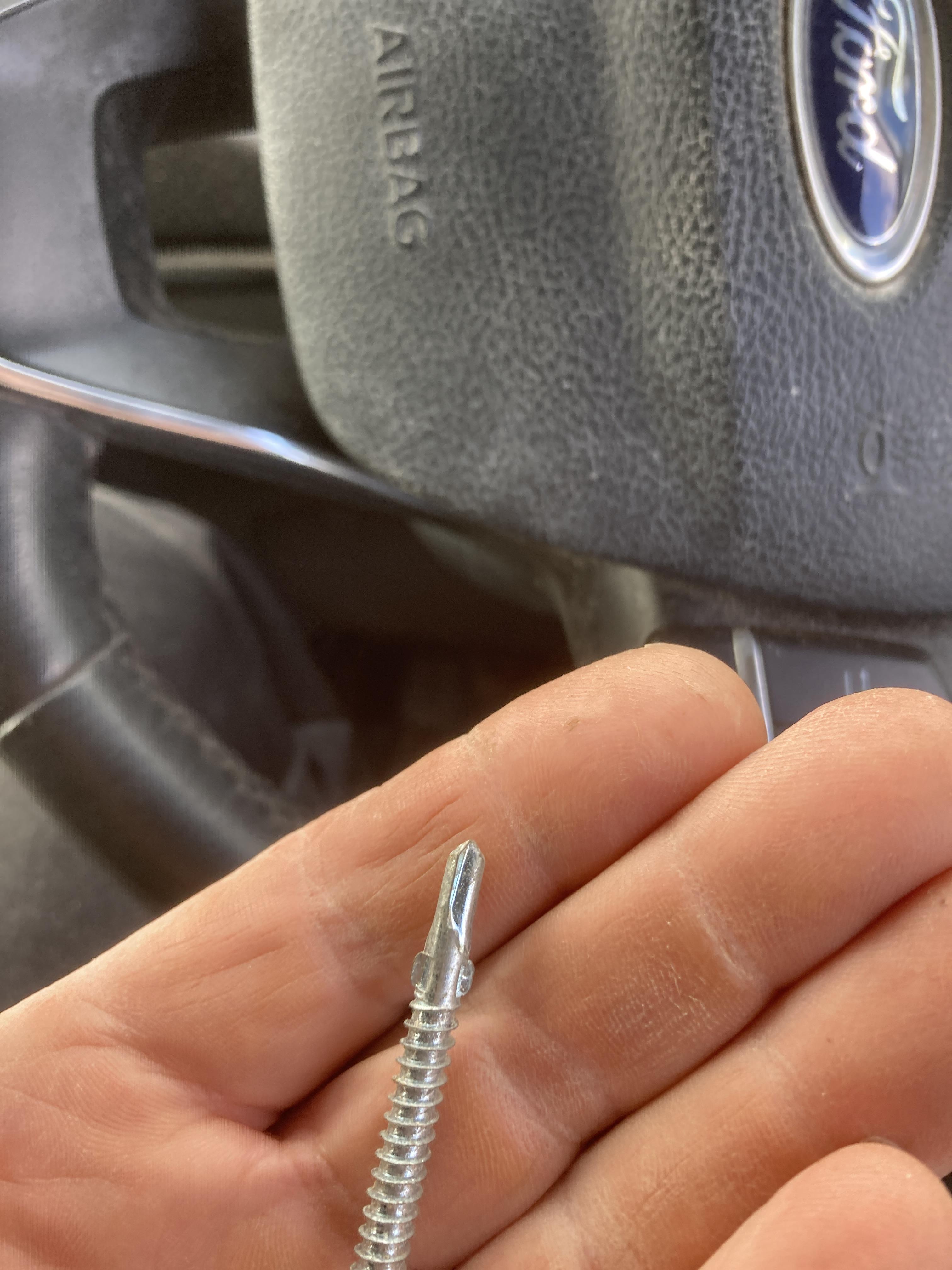

saveasteading Posted June 3, 2022 Posted June 3, 2022 6 hours ago, nod said: A self tapping tech screw Designed for the job, and will cut and self-tap screw itself in one. A wood screw might work fine but is a compromise. Just be sure to get 'heavy' self tap screws that will go through an rsj, and get a few extra just in case any don't quite get through. Hex head for maximum torque and certainty, or torx head if it has to countersink into the wood. I look at these screws and all the complexity and wonder how we can buy them for 10p each.
nod Posted June 4, 2022 Posted June 4, 2022 8 hours ago, Modernista said: Thanks both, will look into both those options. I guess I was trying to avoid all that drilling.... Be sure to buy The bit at the same time I use these by the box They go through steel like butter No pilot hole needed
Modernista Posted June 4, 2022 Author Posted June 4, 2022 Thanks, they sounds ideal. Will give that a go. I seem to be behind the curve with fastener technology - I only discovered the brick screws you can get nowadays last year and given that our house renovation is entirely brick walls they've been brilliant too! These look like the equivalent for metal. Thanks all, much appreciated. I think I will fix a consistent depth 47mm packing piece with these screws so I only need one length and then fix the variable depth firrings timber to timber on top.
saveasteading Posted June 4, 2022 Posted June 4, 2022 13 hours ago, nod said: They go through steel like butter The good ones do. As for many such things, it is worth the extra for a known brand, other than an own-brand.
nod Posted June 5, 2022 Posted June 5, 2022 (edited) 12 hours ago, saveasteading said: The good ones do. As for many such things, it is worth the extra for a known brand, other than an own-brand. I always buy Techfast They never bend or snap Its worth spending a five on a Techfast magnetic bit The cheaper ones soon round Edited June 5, 2022 by nod
