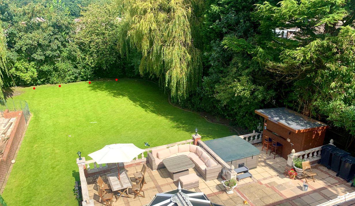

I'm not sure what it's ben backfilled with, but where I wanted to sink the sockets is pretty close to the egde of the lawn, at the edge of that there's some block pave edging then it drops off a good 200-250mm to where all the trees shrubs are. Photo at end (red dots are where I planned to have the floor sockets)
Apologies if an incredibly stupid question, but what's the best method to solve this? simply drilling with a masonry bit down into the ground for some reason felt silly. So wanted to ask some experienced folks first!

I presume its backfilled bricks and cement.
Question - if the Stakes that go into the ground are 50mm diameter. And i'm using much narrower drillbits. Is there a certain way of drilling multiple smaller holes that will break the sub layer away enough to get the larger stakes in easily?
my concern is if I drill a hole too big the stakes will just be too loose when I try to sink them in. Want to avoid using cement etc.

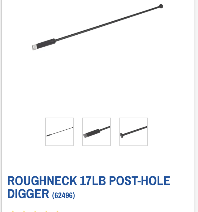

This has made short work of our very hard chalk and flint ground.
Depends on backfill. I'd use ~22 mm drill bit on hammer mode; hoping that it displaces or smashes up whatever the backfill is; then whack your 40-50 mm posts in using something to protect the tops of them from burring over. They will move the lumps out of the way
You will feel it if you're "drilling through a rock" instead of smashing the rock/ moving the rock.
If they still won't go in then find something bigger/heavier (e.g. scaff pole) and a close fit, REALLY bash that in with a sledgehammer, then cut the mullered top of it off and slide your fence post down the centre of it.
