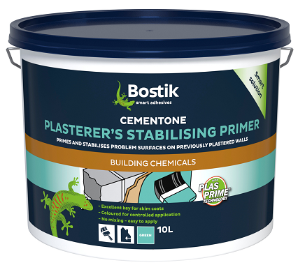

MortarThePoint Posted August 20, 2023 Author Share Posted August 20, 2023 On 30/05/2022 at 16:45, markc said: I’ve used the Everbuild Aquaseal stuff a few times and it’s been great Having discussed the bathrooms with the plasterer it seemed a good idea to sand and cement plaster the blockwork walls before tiling. Would that make for the following running order?: Sand and Cement (S&C) plaster blockwork Aquaseal tanking kit to S&C plaster and bare plasterboard in shower area Tile Can you prime the tanking surface to get a good key for plaster skim if I end up going a bit into the non-tiled area? I'm thinking of something like Bostik primer of BG Bond-It? https://www.bostik.com/uk/en/catalog/product/construction/emea/uk/bostik-plasterer's-stabilising-primer/ Link to comment Share on other sites More sharing options...
markc Posted August 21, 2023 Share Posted August 21, 2023 Morning squire, the tanking stuff leaves a good tacky surface, very like PVA bonding. Tile adhesive grabs hold well so no reason plaster won’t. 1 Link to comment Share on other sites More sharing options...
