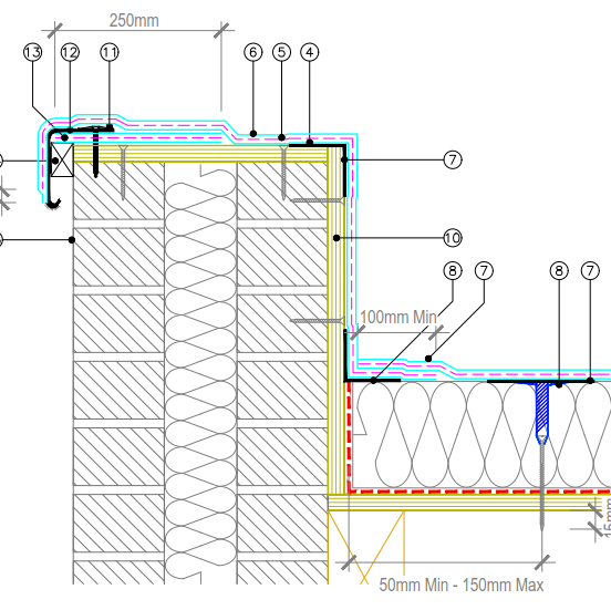

Moonshine Posted May 30, 2022 Share Posted May 30, 2022 Roofer needs 18mm ply lining to a parapet wall as below (he says 9mm on upstand will be o.k). What is the easies way to mechanically fix the boards to the masonry? initial thoughts were something like these https://www.screwfix.com/p/easydrive-countersunk-concrete-screws-7-5-x-60mm-100-pack/3313h anything less chunky? Link to comment Share on other sites More sharing options...
Russell griffiths Posted May 30, 2022 Share Posted May 30, 2022 Those screws are fine. But I would go 18mm, 9 is just floppy and will fall to bits if fixing close to the edge. Link to comment Share on other sites More sharing options...
makie Posted May 30, 2022 Share Posted May 30, 2022 Hammer fixings are normally what I see used on jobs. https://www.screwfix.com/c/screws-nails-fixings/hammer-fixings/cat840070?cm_sp=managedredirect-_-screwsfixings-_-hammerfixings#_=p Link to comment Share on other sites More sharing options...
