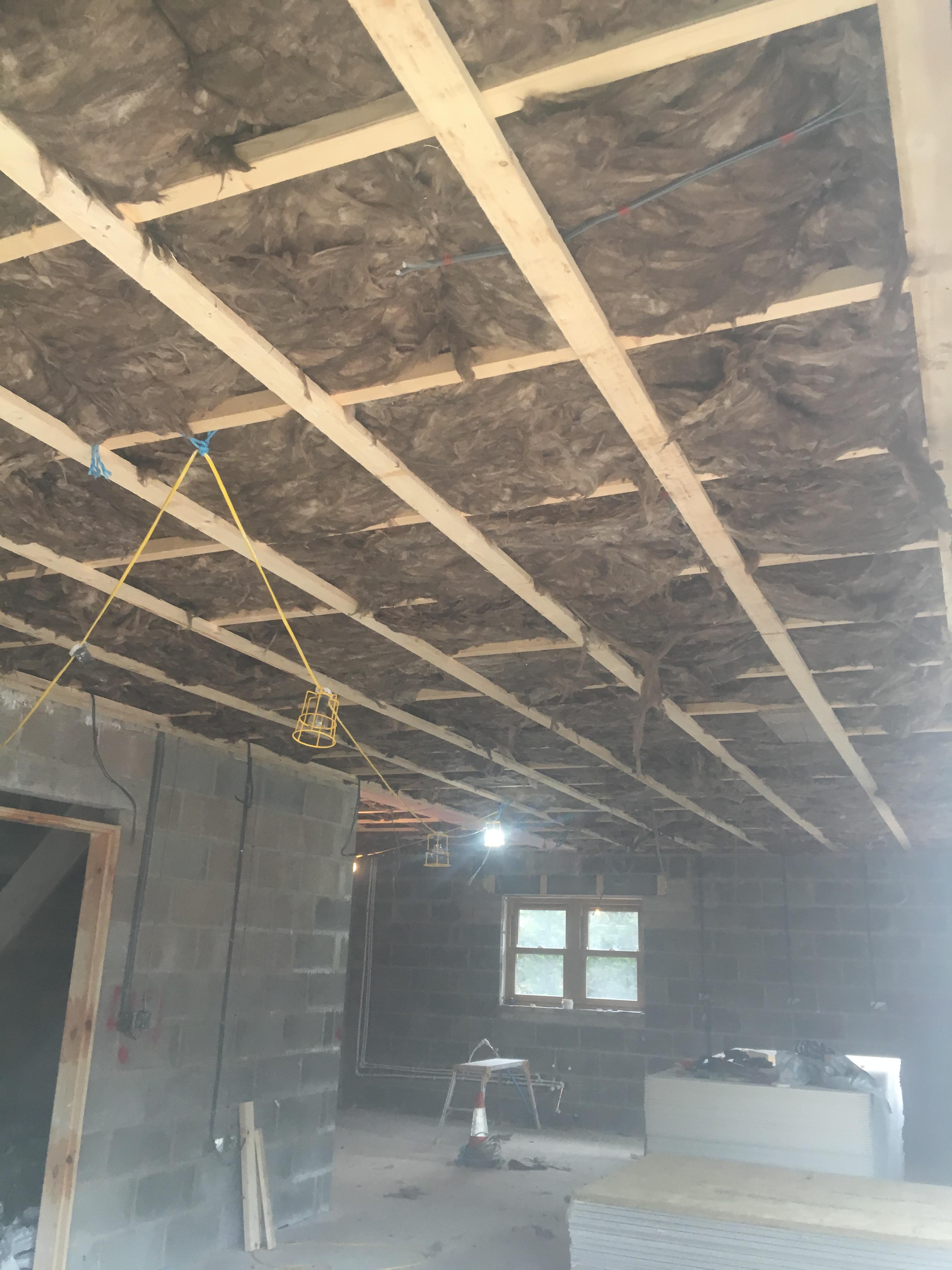

matthyde83 Posted May 14, 2022 Posted May 14, 2022 We’re just about to install I Joists for our first floor. “Under no circumstances notch the flanges”. How does this work with metalwork and plasterboard getting a nice flat finish? The hangers will protrude down at edges (and we have some meeting in middle on a steel) even a few mm can cause issues with the plasterboard. Same issue for the restraint straps with the floor?
joe90 Posted May 14, 2022 Posted May 14, 2022 IMO a couple of mm will not cause problems in either case. Plasterboard and flooring is flexible enough to cope with any deformation of that small amount. In engineering terms it would not be acceptable with steel which is not that flexible. In my floors upstairs the boards were fixed with d4 glue and no nails or screws and that fills any small voids anyway.
matthyde83 Posted May 14, 2022 Author Posted May 14, 2022 26 minutes ago, joe90 said: IMO a couple of mm will not cause problems in either case. Plasterboard and flooring is flexible enough to cope with any deformation of that small amount. In engineering terms it would not be acceptable with steel which is not that flexible. In my floors upstairs the boards were fixed with d4 glue and no nails or screws and that fills any small voids anyway. My builder thinks it will cause screws to pop etc in plasterboard. Traditional joists he would usually recess the hangers… 🤷🏻♂️
joe90 Posted May 14, 2022 Posted May 14, 2022 (edited) 7 minutes ago, matthyde83 said: My builder thinks it will cause screws to pop etc in plasterboard. Traditional joists he would usually recess the hangers… 🤷🏻♂️ Then your only option is to use counter battens of some sort or hardboard strips along all joists!!! (nowhere on my build has any screws popped). Others will be along shortly with their input, @nod ? Edited May 14, 2022 by joe90
Mr Punter Posted May 14, 2022 Posted May 14, 2022 If you run resilient bars at right angles to the joists you will get a nice flat ceiling, vastly improved soundproofing and only lose 18mm ceiling height. 2
nod Posted May 14, 2022 Posted May 14, 2022 1 hour ago, joe90 said: Then your only option is to use counter battens of some sort or hardboard strips along all joists!!! (nowhere on my build has any screws popped). Others will be along shortly with their input, @nod ? Spot on Joe Counter baton with rough cut 75x25 mil Also save bogging out
nod Posted May 14, 2022 Posted May 14, 2022 Bogging should say nogging Also you will have to notch out 5 mil for the straps that hook into the cavity and sit on the top of three I joists 1
