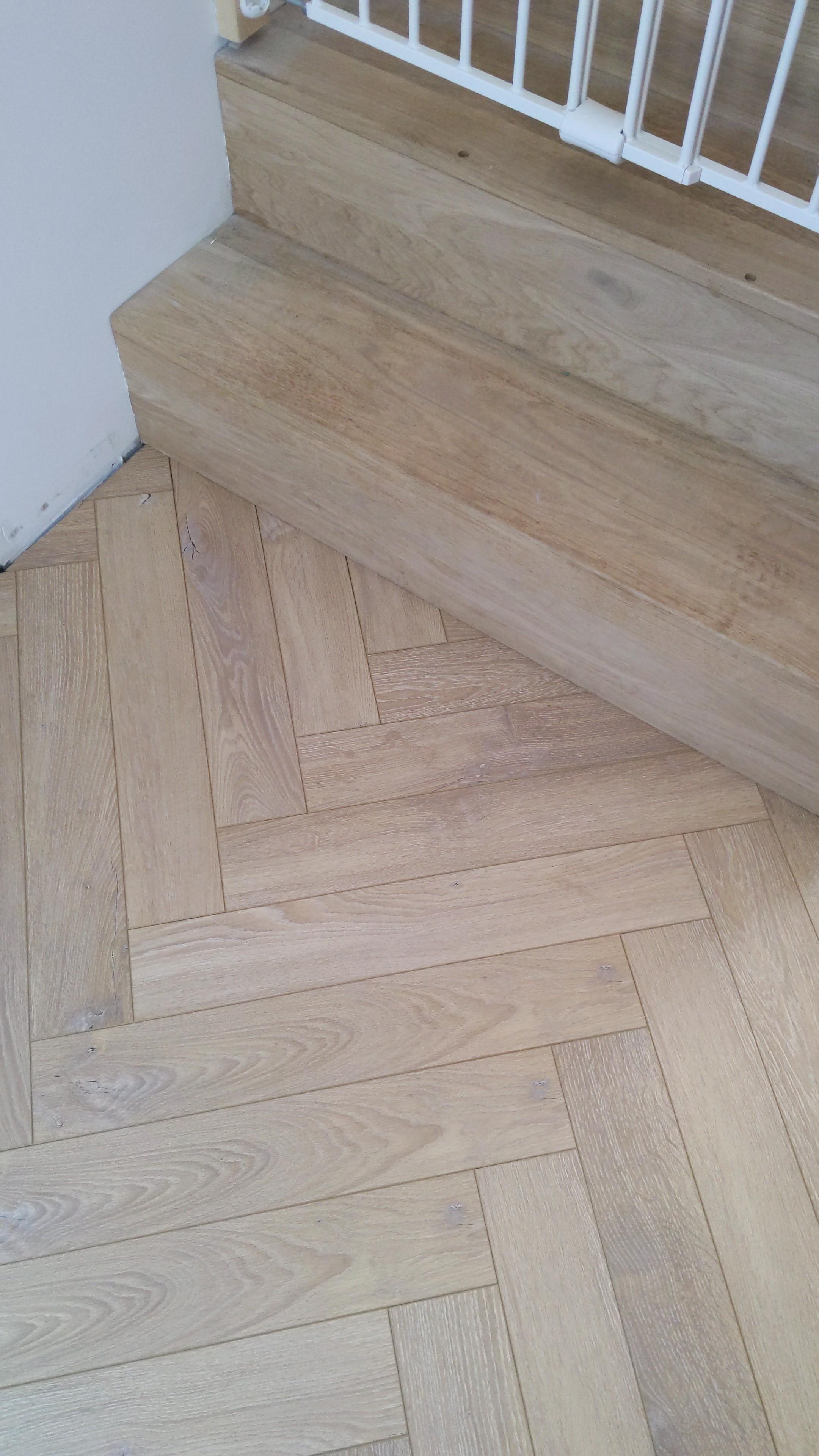

Forget the lvt and go for laminate. We did the same, left 20mm for an engineered wood floor, chickened out and found a lovely herringbone laminate instead. Was only 12mm thick so we used 5mm wood fibre underlay to get it up. Worked brilliantly. We had wanted lvt but all the people we spoke to said it was a no go to build up that much. Only realistic option would have been to lay a full click laminate floor and out the lvt on top. Only other option is 20mm of self leveller, but then your stuck with lvt or lino for ever.
