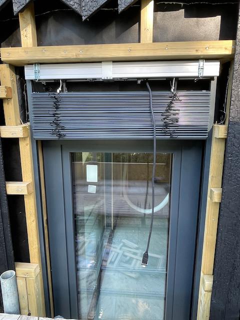

Thorfun Posted May 8, 2022 Author Share Posted May 8, 2022 8 minutes ago, Temp said: Is it going in conduit or exposed to UV? If exposed it would be nice to see UV resistant in the description somewhere. these will be behind the blinds head unit which will, in turn be behind cladding. so, it will be outside but will not be exposed to UV directly. I'll pop out and take a photo. 🙂 Link to comment Share on other sites More sharing options...

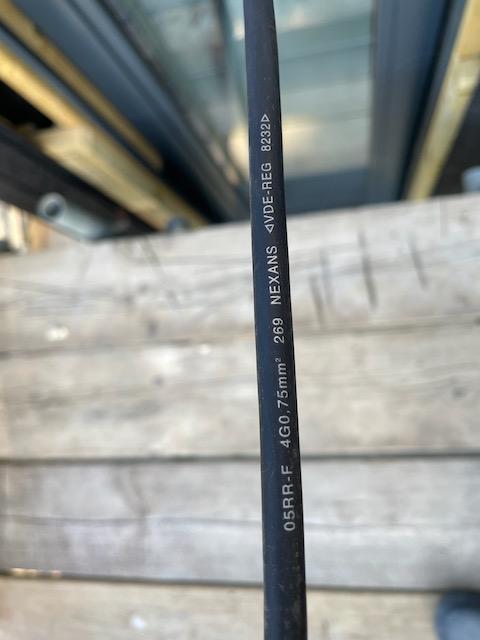

Thorfun Posted May 8, 2022 Author Share Posted May 8, 2022 the cable hanging down is the one that comes with the blinds. I will run a cable from the plant room to each blind to connect to the blind motor's cable through a hole in the wall behind the silver head of the blind you can see below. the timber cladding (tongue and groove) will come down to cover the slat stack. the cable that comes with the blind motor (a Geiger GJ5606k) has the following written on it: Link to comment Share on other sites More sharing options...
Thorfun Posted May 8, 2022 Author Share Posted May 8, 2022 a quick Google tells me that the H05RR-F cables are rubber flexible cables. I see no reason why I need to use rubber cables for my run from the plant room to the external blind. so back to PVC cables then. Link to comment Share on other sites More sharing options...
