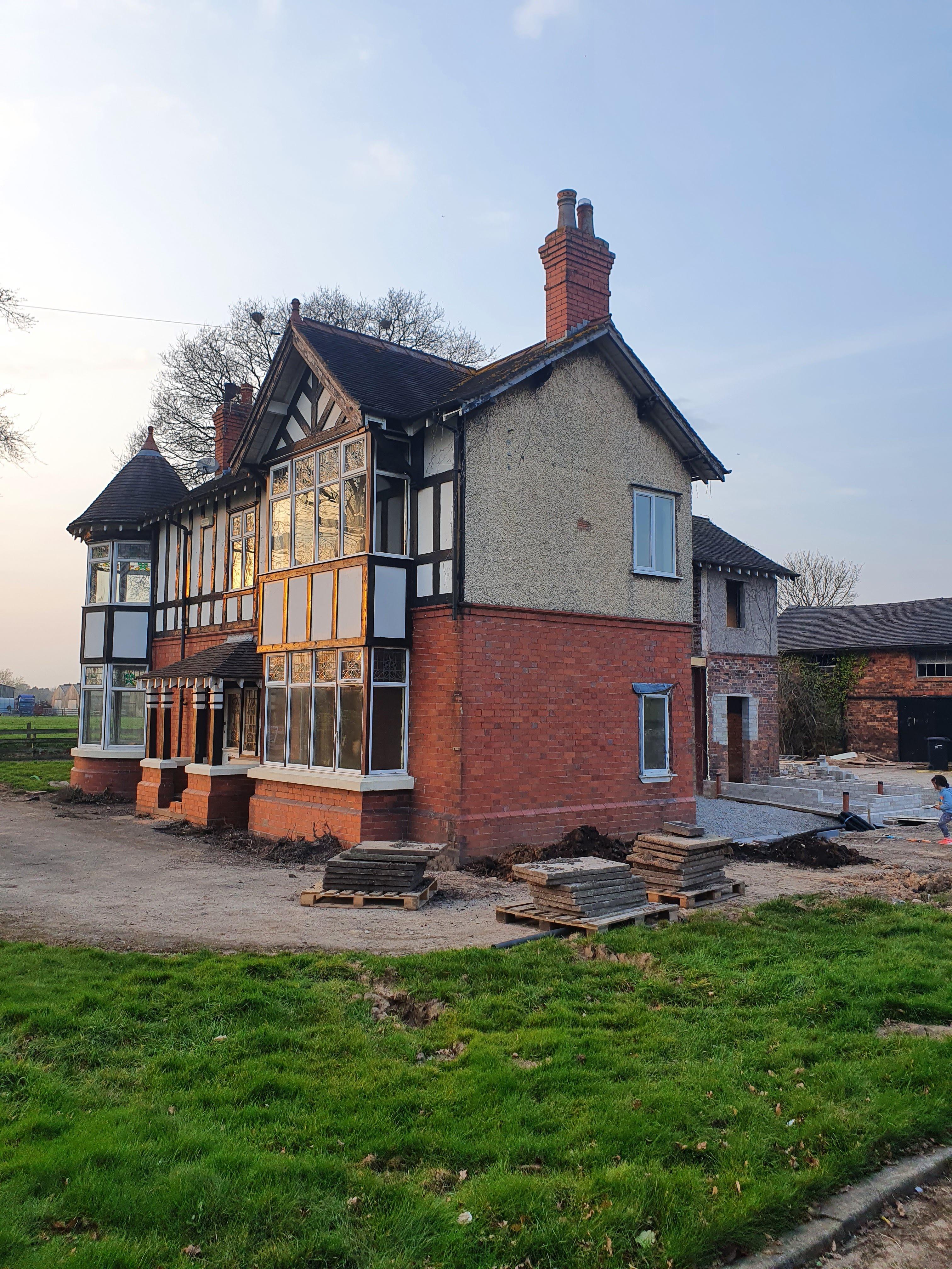

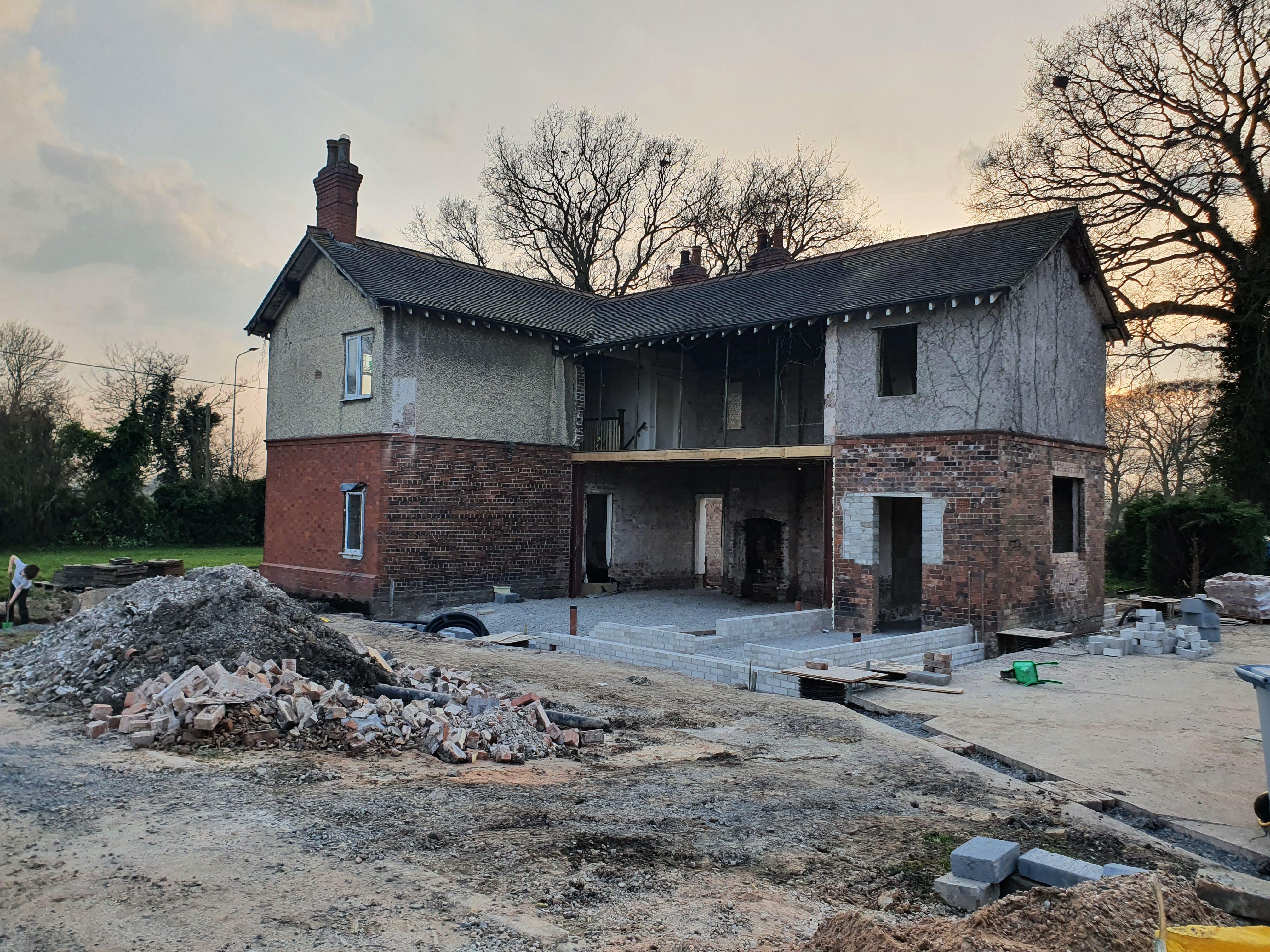

FrankHouse Posted April 26, 2022 Share Posted April 26, 2022 Hi everyone, I've been stalking the forum for quite a while after buying a farmhouse in Nantwich to renovate and thought I should finally introduce myself. I'm an engineer who has taken 6 months out of work to work with my builder to the majority of the build done. We have put nin steels and are putting in the slab next week so are on with the build but some of the finer details will need ironing out as I get to them. I'm almost doubling the size and the inside has been gutted and insulated so it can be brought up to a modern standard. I'm not aiming for a passive house but am putting in a fair amount of insulation, MVHR, ASHP, rainwater tanks etc. I have a few questions which I'll put int he relevant sections for some help. I really like the forum because it contains a wealth of information and on occasion differing opinions which is something I like as I can choose which one I agree with Here are a few pictures so you can see the project, Frank 2 Link to comment Share on other sites More sharing options...

FrankHouse Posted April 28, 2022 Author Share Posted April 28, 2022 The original house was build in 1897 I think - We have found the original plans which are drawn on cloth. We are planning on framing them alongside the new ones if we every get to that point! Link to comment Share on other sites More sharing options...

FrankHouse Posted May 2, 2022 Author Share Posted May 2, 2022 3 hours ago, DevonKim said: That's a really attractive farmhouse, isn't it? What are you planning to do to it? Thanks, i swing back and forwards between admiring the different bits and then disliking the asymetry... but overall I like it. it was a t shaped building with two large front rooms and a small kitchen dinning room, scullery at the back. we are squaring it off and adding a modern looking section to the rear with the usual big open kitchen diner. Inside the old bit, it's back to brick to try and make it affordable in the era of high energy prices, so pir insulation, ufh, ashp, mvhr... all the acronyms you can think of. I'll put up pictures as I move through the build. Link to comment Share on other sites More sharing options...
