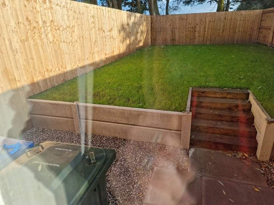

Danny-r Posted April 22, 2022 Author Share Posted April 22, 2022 (edited) Yes it is. I've attached a previous picture before I started digging, it may help. Water visibly drains between the two pieces of concrete, gaps on the sides and also a significant gap at the base when you pull the stones back a little. Edited April 22, 2022 by Danny-r Link to comment Share on other sites More sharing options...
saveasteading Posted April 22, 2022 Share Posted April 22, 2022 OK I understand now, and obviously you don't mind that gravel area being under water. I would be more inclined to make a catchment up on the higher level, so a big pit, that would be a pond. Then it holds the water, allows half into the ground and half to evaporate with wind or plant respiration, and meanwhile be attractive. Shrubs would help too, in drinking the water and breaking up the soil over time. Failing that, build the french drains with additional pipes to create more void space, tto hold the water. Gravel is one two thirds or more stone, and doesn't hold much water. Link to comment Share on other sites More sharing options...
