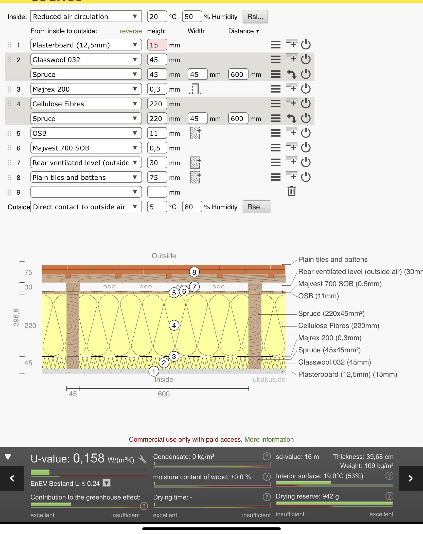

matthyde83 Posted April 17, 2022 Posted April 17, 2022 I’m trying to make some decisions on roof insulation on my new build… So far I’ve increased the cavity to 150mm and using EPS Beads, increased floor to 200mm PIR. Now I’m tackling the roof. I have a few different sections. Mono-pitched on ground floor currently specced as 150mm rafters at 400 centres, dormers with similar and a hipped section specced with 400mm loft roll. Reading through building regs submission it’s suggesting 0.16 u value for mono pitch using 200mm celotex and 0.11 u value for the loft wool sections. I’d really like to hear people thoughts / advice…
Iceverge Posted April 17, 2022 Posted April 17, 2022 This for the pitched sections. 400mm blown cellulose on the flat sections.
matthyde83 Posted April 18, 2022 Author Posted April 18, 2022 6 hours ago, Iceverge said: This for the pitched sections. 400mm blown cellulose on the flat sections. Thank you. So this achieves the stated 0.16 for the pitched sections. I can imagine this being quite costly though? 9’x2” instead of 4, OSB layer, glasswool and 220mm blown cellulose… Can you tell me why the recommendation?

Iceverge Posted April 18, 2022 Posted April 18, 2022 2 hours ago, matthyde83 said: Thank you. So this achieves the stated 0.16 for the pitched sections. I can imagine this being quite costly though? 9’x2” instead of 4, OSB layer, glasswool and 220mm blown cellulose… Can you tell me why the recommendation? The timber price would logicaly be more but 100mm rafters I'd expect them to be very closely spaced. The increased spacing and reduced labour should somewhat compensate. My non exhaustive list of why blown cellulose trump's PIR. Installed cost of cellulose is half the material cost of PIR for the same U value but with zero waste. Fire performance. Noise performance. Waste during install. Heat protection. No thermal bypass. No shrinkage. Performs just as well in cold weather. (Foam doesn't) Blown cellulose contributes lots to airtightness. It's carbon negative. No thermal bridging through the aluminium foil. No gas migration leading to poorer performance over time. No mess on site. 3
