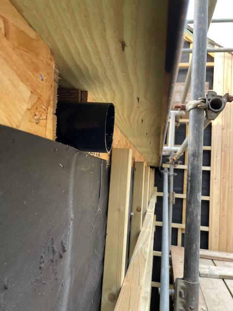

Thorfun Posted April 14, 2022 Posted April 14, 2022 next issue I need to sort out is that the drainage outlet from our flat roof needs to bend down to be able to come out below the trim, otherwise I'd need to cut the trim (which I'd rather not do). so I need to S-bend it to bring it below the trim so that it can, eventually, come out of the timber cladding and in to a hopper or other drainage solution that is yet to be decided. the pipe current sticks out 50mm from the wall and I have 70mm to play with before the trim and it needs to drop 30mm to be able to come out from under the trim. I've found 68mm 92.5° round offset bends (https://www.screwfix.com/p/floplast-92-5-round-offset-bend-black-68mm/53298). would it work to connect two of those together to get out below the trim? I was hoping for more of a 30° swan neck type of affair but that doesn't seem to exist and I can't find anything with such small angle to fashion my own. so I'm looking for assistance and potential solutions to this please.
Temp Posted April 14, 2022 Posted April 14, 2022 Can you use two 68mm 135/45 degree bends to make a joggle.. https://www.drainageonline.co.uk/above-ground-drainage/guttering/marley-guttering/marley-68mm-circular-downpipe/68mm-downpipe-bend-45deg?gclid=Cj0KCQjwjN-SBhCkARIsACsrBz6lrolbqgHfEB3hTP0Anx-fuIeZX_cCeveF10yIZfpobwoD5VDYQ7waArQUEALw_wcB#fo_c=2925&fo_k=d6e2b0c96d9fb450c75225f7696a8559&fo_s=gplauk
Thorfun Posted April 14, 2022 Author Posted April 14, 2022 47 minutes ago, Temp said: Can you use two 68mm 135/45 degree bends to make a joggle.. https://www.drainageonline.co.uk/above-ground-drainage/guttering/marley-guttering/marley-68mm-circular-downpipe/68mm-downpipe-bend-45deg?gclid=Cj0KCQjwjN-SBhCkARIsACsrBz6lrolbqgHfEB3hTP0Anx-fuIeZX_cCeveF10yIZfpobwoD5VDYQ7waArQUEALw_wcB#fo_c=2925&fo_k=d6e2b0c96d9fb450c75225f7696a8559&fo_s=gplauk Nice find. Probably better than 2 x 92.5° bends.
PeterW Posted April 14, 2022 Posted April 14, 2022 Use the 135/45° bends but make sure you joint them using something like CT1 especially onto that horizontal outlet as they will leak otherwise. 1
Thorfun Posted April 14, 2022 Author Posted April 14, 2022 4 minutes ago, PeterW said: Use the 135/45° bends but make sure you joint them using something like CT1 especially onto that horizontal outlet as they will leak otherwise. Got plenty of CT1
Temp Posted April 14, 2022 Posted April 14, 2022 1 hour ago, Temp said: Can you use two 68mm 135/45 degree bends to make a joggle.. https://www.drainageonline.co.uk/above-ground-drainage/guttering/marley-guttering/marley-68mm-circular-downpipe/68mm-downpipe-bend-45deg?gclid=Cj0KCQjwjN-SBhCkARIsACsrBz6lrolbqgHfEB3hTP0Anx-fuIeZX_cCeveF10yIZfpobwoD5VDYQ7waArQUEALw_wcB#fo_c=2925&fo_k=d6e2b0c96d9fb450c75225f7696a8559&fo_s=gplauk Worth checking that two of these can be joined together. You might need a short length if pipe between the two? 1

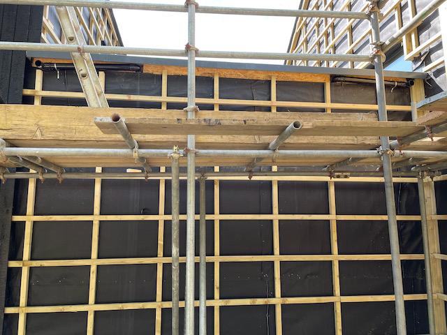

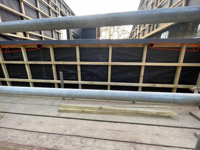

Thorfun Posted April 19, 2022 Author Posted April 19, 2022 slight change of plan here. I now would like to widen the gap between my 2 outlets on the roof. so I have bought 4 x 90° offset bends and some 68mm pipe and am planning on doing the following: so a 90° bend in to the existing pipe then a length of 68mm pipe to the side at a suitable fall and then another 90° bend at the end to bring it out through the cladding. anyone see any issues with this? will be connecting the offset bends with CT1. I assume a bead of CT1 around the pipe and slide it in? or is there a better way of doing it? Also, what sort of fall should I be looking at?

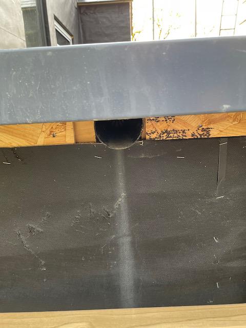

Thorfun Posted April 24, 2022 Author Posted April 24, 2022 well....no one shouted that this was a bad idea so I've gone and done it. water flows and falls through the new pipes nicely. another job ticked off the list!
