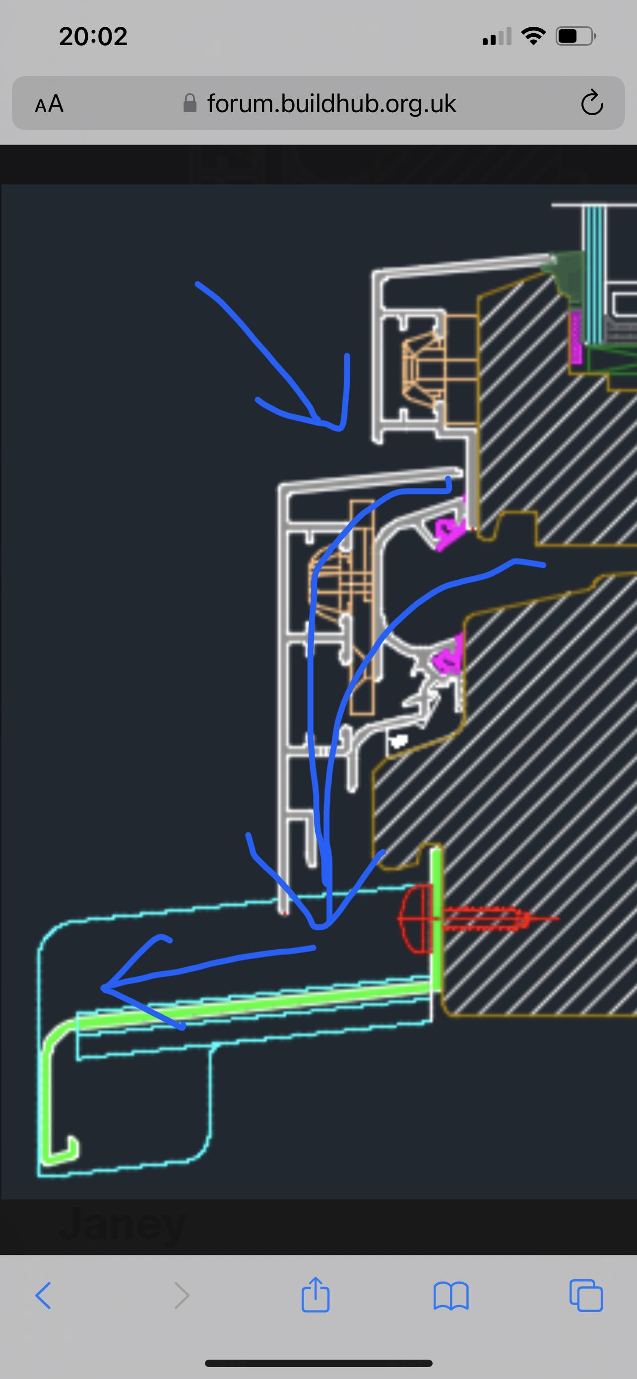

MrMagic Posted April 14, 2022 Posted April 14, 2022 Howdy folks - Can't seem to find an answer on this one - for a tilt and turn window are there still front drainage holes and do you need cills? or is this a purely uPVC thing? A lot of the aluminium cill profiles seem to butt up to the front face of the window rather than run underneath it - how does that become weather tight? If anyone has a cross section / explanation / photos that would be very very appreciated!! MM.
markc Posted April 14, 2022 Posted April 14, 2022 Anything that opens and closes is likely to need a drain of some sort
craig Posted April 14, 2022 Posted April 14, 2022 Timber alu clad, generally speaking no, the water is allowed to drain behind the cladding and the window cill sits further back (always refer to manufacturer or supplier for clarity on product you're looking at). 1

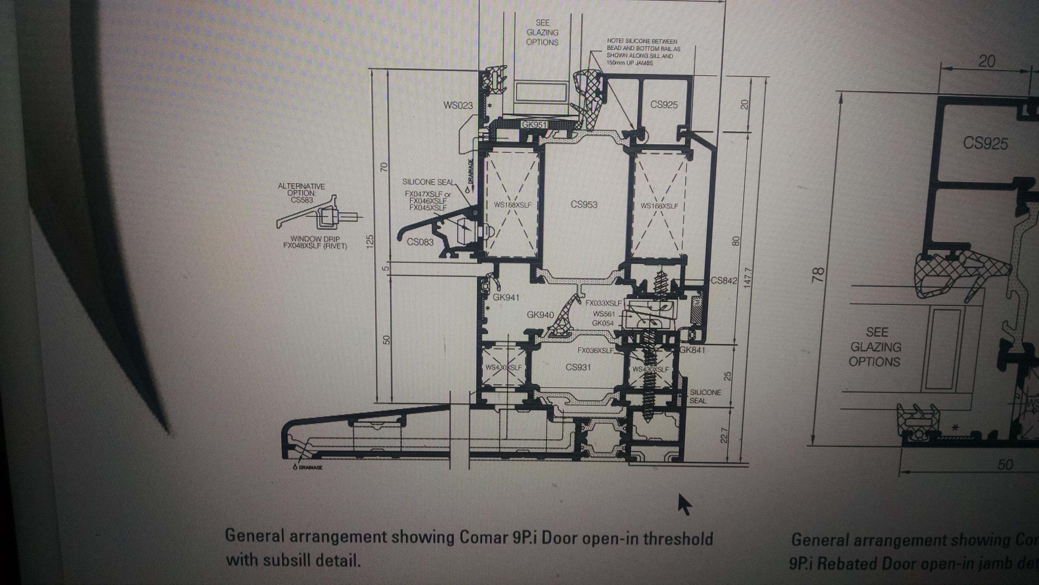

markc Posted April 19, 2022 Posted April 19, 2022 Both of the above sections through have drains/weeps in the profiles. the one posted by Craig i would imagine also has one to drain the centre left void of any collecting water
craig Posted April 19, 2022 Posted April 19, 2022 (edited) 9 hours ago, markc said: Both of the above sections through have drains/weeps in the profiles. the one posted by Craig i would imagine also has one to drain the centre left void of any collecting water Edited April 19, 2022 by craig 2
