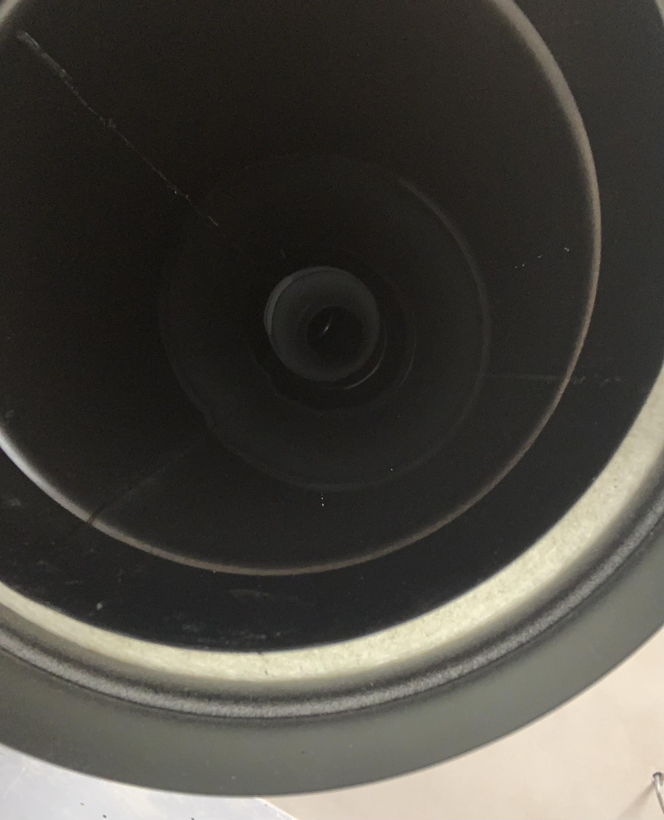

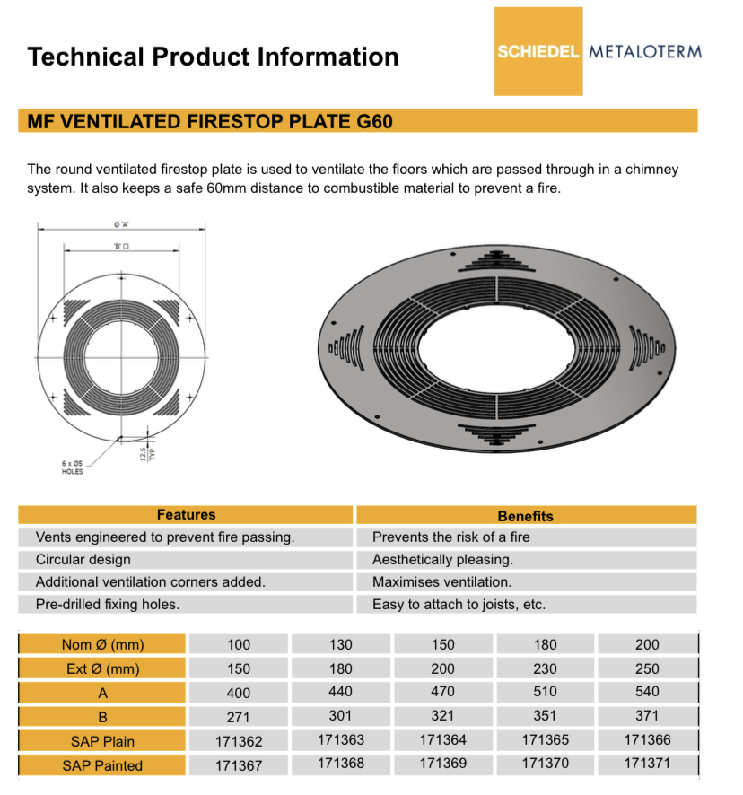

Adsibob Posted April 12, 2022 Posted April 12, 2022 (edited) An issue has arisen on site in that the twin wall insulated flue we have had installed has not been installed with one of these ventilated fire stop plates (see attached spec sheet) creating an air gap between the ceiling plaster board and the flue. Hetas installer says it’s not required because we are using an insulated twin wall flue, and so the flue will never exceed 50C or possibly 60C to the touch and is happy to sign off the installation as is. This didn’t sound right to my project manager so he called the manufacturer, Schiedel, who is saying that it is required. The ceiling has already been plastered and finished with clay based plaster, and I don’t believe the plasterboard is of the fire rated type. This is about 2.2m from the stove itself which is rated 5kw to 9kw, to the extent that is relevant. I’ve had a look at the cross section of the flue: and there do appear to be several layers, including a thick layer of insulation, so maybe the installer is right. Not helped however by his admission that he sacked one of the engineers involved in our install because his work was unreliable! What would you do? Edited April 12, 2022 by Adsibob
MJNewton Posted April 12, 2022 Posted April 12, 2022 (edited) I'd go with what the manufacturer says. Their instructions tend to trump all generic regs and rules etc and so can be regarded as gospel. Edited April 12, 2022 by MJNewton
Adsibob Posted April 12, 2022 Author Posted April 12, 2022 1 hour ago, MJNewton said: I'd go with what the manufacturer says. Their instructions tend to trump all generic regs and rules etc and so can be regarded as gospel. good advice. This is what I will do. Bloody stressful when a supposed authorised contractor tries to bend the rules. Para 1.45 of Approved Doc J says this: "Factory-made metal chimneys should be kept a suitable distance away from combustible materials. Ways of meeting the requirement for chimneys designated to BS EN 1856-1:2003 comprise: a. locating the chimney not less than distance ‘xx’ from combustible material, where ‘xx’ is defined in BS EN 1856-1:2003 as shown in Diagram 13; b. where a chimney passes through a cupboard, storage space or roof space, providing a guard placed no closer to the outer wall of the chimney than the distance in a) above." It's clear from DIagram 13 that the manufacturer is right: see PDF page 798 of this: https://assets.publishing.service.gov.uk/government/uploads/system/uploads/attachment_data/file/1010058/Single_stitched_together_pdf_of_all_ADs__Jul21_.pdf
