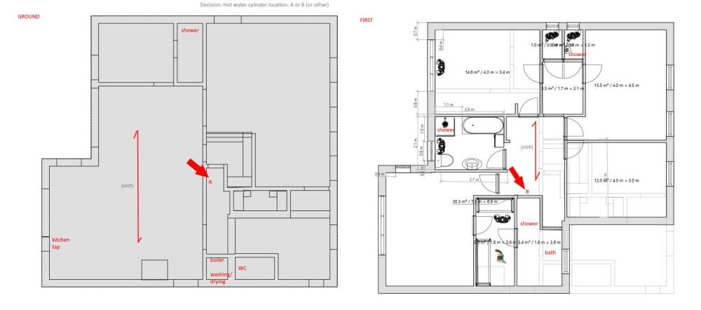

WWilts Posted April 9, 2022 Share Posted April 9, 2022 Unvented hot water cylinder, location to be chosen. Options: Either under the stairs (central) or off the upstairs landing (reasonably central) Which might you choose and why? (A, downstairs, was originally intended. B would involve some fiddling with the upstairs floor plan) Link to comment Share on other sites More sharing options...
ProDave Posted April 9, 2022 Share Posted April 9, 2022 A looks pretty central and already provisioned for. Hot pipes would go up to the ceiling void then as direct as possible to each point of use. 1 Link to comment Share on other sites More sharing options...
TonyT Posted April 9, 2022 Share Posted April 9, 2022 Drain at both locations? Link to comment Share on other sites More sharing options...
WWilts Posted April 9, 2022 Author Share Posted April 9, 2022 13 minutes ago, TonyT said: Drain at both locations? Did not realise a drain is needed for the hot water cylinder. Constant drainage required? Link to comment Share on other sites More sharing options...
TonyT Posted April 9, 2022 Share Posted April 9, 2022 https://mcdonaldwaterstorage.com/wp-content/uploads/2020/11/POWERFlow-Installation-Manual-Iss-3.1.pdf 1 Link to comment Share on other sites More sharing options...
