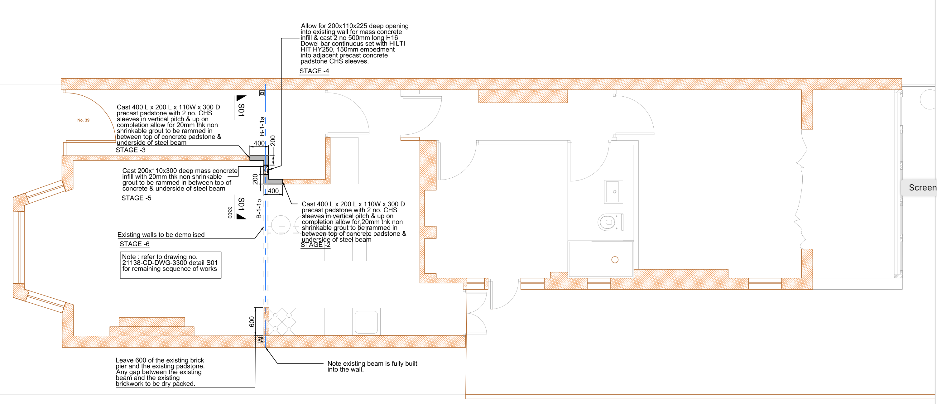

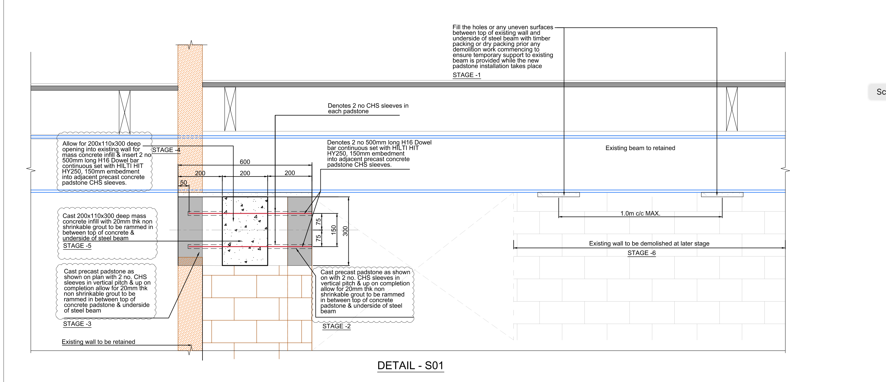

Ttrev Posted March 24, 2022 Share Posted March 24, 2022 (edited) Hi there surveyors! I have a question about managing freeholder disputes over alterations. I live in the ground floor flat of a converted 3 story Victorian house, 3 flats, own share of freehold with the other flat owner-occupiers (one 1-bed flat at the back of the the first floor, one 2-bed flat at the front of the first floor and the second floor). I want to knock two rooms through to make an open-plan living / kitchen area. The wall I want to remove was not there when the house was built, and there's an iron beam above it holding the rest of the house up so the wall is not really load-bearing. I've had a structural engineer prepare calculations and drawings specifying some minor supporting work which may be necessary when we expose the beam and he's had a look. The work would take 2-3 months in total I guess. The issue is that my fellow freeholders look like they're going to fight this tooth and nail. We'll probably need a surveyor to draw up the docs and arbitrate. Some questions though before I decide whether it's worth the fight: For a job like this, do we need a Party Wall Agreement as well as a Licence to Alter? Can they object to the work on grounds of noise and disruption? One of the couple in the 2 bed flat works with vulnerable children, is WFH since the pandemic so does everything on video calls, doesn't have an office to go to. She and her husband do however have two large double bedrooms on the second floor at the top of the house. He works in one, she works in their living room which is directly above my living room where a lot of the work will be done. I've suggested they both work on the second floor away from the noise but they don't want to and haven't given me a good reason. Is this something a surveyor would be able adjudicate on in the event of a dispute, or are we getting into legalities beyond a surveyor's scope? The kitchen of the new open-plan space will be below the bedroom of the 1-bed flat. Can the owner object to the new configuration on the basis of potential extra noise from the kitchen and living room below? If so will sound-proofing the ceiling be enough to address this? Many thanks in advance. Edited March 24, 2022 by Ttrev Link to comment Share on other sites More sharing options...
saveasteading Posted March 24, 2022 Share Posted March 24, 2022 1. Possibly, if you are changing how the wall attaches to the wall/floor/ceiling between you and the neighbouring house/flat. Depends on your circumstances. A sketch would help. 2. They can object but you are allowed reasonable noise. tell your workers to keep it down, and avoid unnecessary noise such as shouting and radios. 3. If nothing you are doing increases the chance of noise then, no. If you add sound proofing then that is more than reasonable. What are the floors constructed from? Keep photos of the conditions now and insulation being applied and complaints will fail. Link to comment Share on other sites More sharing options...
Ttrev Posted March 24, 2022 Author Share Posted March 24, 2022 Thanks @saveasteading! 1. SE drawings attached. The supporting work will be under the beam so not directly connected to the wall above, but does involve work on the wall of the communal hall, so I guess that counts as a party wall? 3. Floor are wooden floorboards over joists and the upstairs bedroom is not carpeted. Will take loads of photos. Link to comment Share on other sites More sharing options...
markc Posted March 24, 2022 Share Posted March 24, 2022 As you are “tampering” with the support to a wall above then this work will come under PArty Wall, doesn’t have to be anything fancy just satisfy your neighbours that the works will be fully insured, carried out by experienced trades in an efficient and curtious manner Link to comment Share on other sites More sharing options...
saveasteading Posted March 24, 2022 Share Posted March 24, 2022 The nuisance to the upstairs neighbours would be the main issue. The side neighbours are not having their shared walls affected so this wouldn't be a party wall matter (the beam is already in both shared walls), If the neighbours tell you they are ok with the work then just confirm that and you will have no issues. If they are not happy then the next thing is to show them the party wall act and perhaps they will drop it. The actual 'Act' is a lot of words but this booklet is helpful. https://www.gov.uk/government/publications/preventing-and-resolving-disputes-in-relation-to-party-walls/the-party-wall-etc-act-1996-explanatory-booklet Talking to the neighbours can do no harm. The upstairs people need to know that the structure is not at risk...show them the drawings, even invite them in to see the beam. Try to talk about dismantling the wall rather than demolition. Do make your own mind up on this as I don't know the full circumstances, don't know you or the neighbours and have only dealt with PWA a few times. Link to comment Share on other sites More sharing options...

Ttrev Posted March 25, 2022 Author Share Posted March 25, 2022 (edited) One last question: if some of the supporting work involves putting a padstone into the wall separating my flat from the house's communal hall, then is this wall outside the demise of my flat (the lease says the demise includes the internal faces of the external walls of the flat, I guess this is pretty standard) and if so I guess the freeholders could just refuse since my lease only allows work within the demise? Or would it count as an unavoidable part of the improvement work which they can't refuse unreasonably? Edited March 25, 2022 by Ttrev Link to comment Share on other sites More sharing options...
Faz Posted March 25, 2022 Share Posted March 25, 2022 Works outside of the demised premises are not allowed - this would even include fixings into the external walls. In the real world, get the License and chance it. 1 Link to comment Share on other sites More sharing options...
