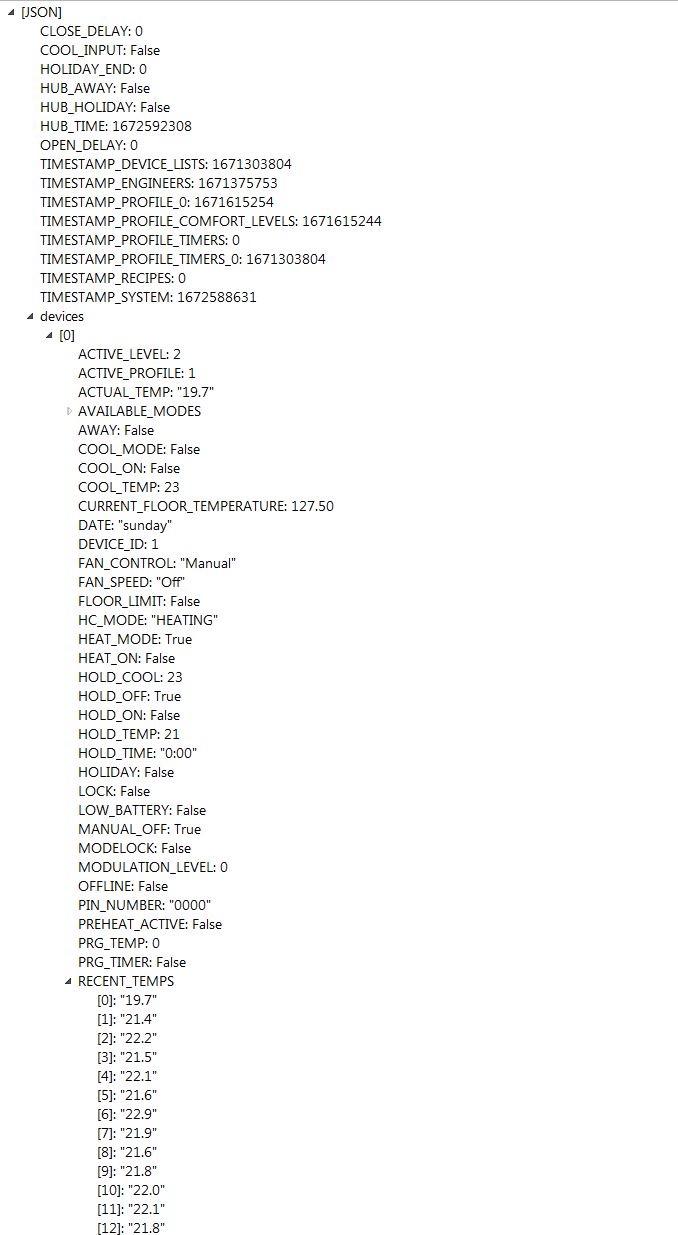

jayc89 Posted March 13, 2022 Share Posted March 13, 2022 Our UFH and upstairs radiator zones all use Heatmiser NeoStats (v2). I'm considering getting a NeoHub so I can use the API it exposes to track things like temperature difference and demand frequency per zone throughout the day/week etc. Before I write something from scratch I wondered if anyone had already done anything similar? Link to comment Share on other sites More sharing options...

Alan Ambrose Posted January 1, 2023 Share Posted January 1, 2023 >>> I'm considering getting a NeoHub so I can use the API it exposes me too and it just surfaced on my stack again (could be only for 10 minutes). Let me note some finds on this subject then: https://stackoverflow.com/questions/57873516/trying-to-communicate-with-heatmiser-neohub-using-provided-api-json-over-tcp-an https://github.com/RJ/heatmiser-neohub.py https://faq.heatmiser.com/hc/en-us/articles/360001844820-How-do-I-request-the-API-Documents- https://pub.dev/documentation/neohub/latest/ https://gitlab.com/afshar-oss/neohub-dart/-/blob/master/doc/Neohub_Api_For_Systems_Developers.pdf I'll post here if I find any time to write some code... 1 Link to comment Share on other sites More sharing options...
Alan Ambrose Posted January 1, 2023 Share Posted January 1, 2023 Also: https://github.com/MindrustUK/Heatmiser-for-home-assistant https://www.openhab.org/addons/bindings/neohub/ The latter is useful as it describes how you configure the hub with recent firmware (I think they update the firmware OTA automatically) for socket comms: (a) update the mobile app and set 'Legacy API' on in settings. (b) identify the hub ip using a scantool / your router's dhcp map and then check with nmap or similar that port 4242 is open. Then code something like the stackoverflow link above will work - otherwise you get 'socket closed'. Link to comment Share on other sites More sharing options...
Alan Ambrose Posted January 1, 2023 Share Posted January 1, 2023 OK basic access kinda works: Link to comment Share on other sites More sharing options...
Alan Ambrose Posted January 3, 2023 Share Posted January 3, 2023 A further update: + the API seems to work fairly reliably. + it's not so well designed or documented: for instance - although the app (and presumably the hub) knows the detailed 'heat-on' schedule by device over time for the couple of months on a 15 minute grid ... the api seems to only give you the number of total hours per day (as a rounded integer) per device for the last week. + however there a bunch of large json blobs you can retrieve, including 'GET_LIVE_DATA' which returns a 23K byte blob, 'GET_TEMPLOG' which returns a 5KB blob per device etc. + you can also send commands too. So this is, for instance, how the home automation systems integrate with the hub. Link to comment Share on other sites More sharing options...
