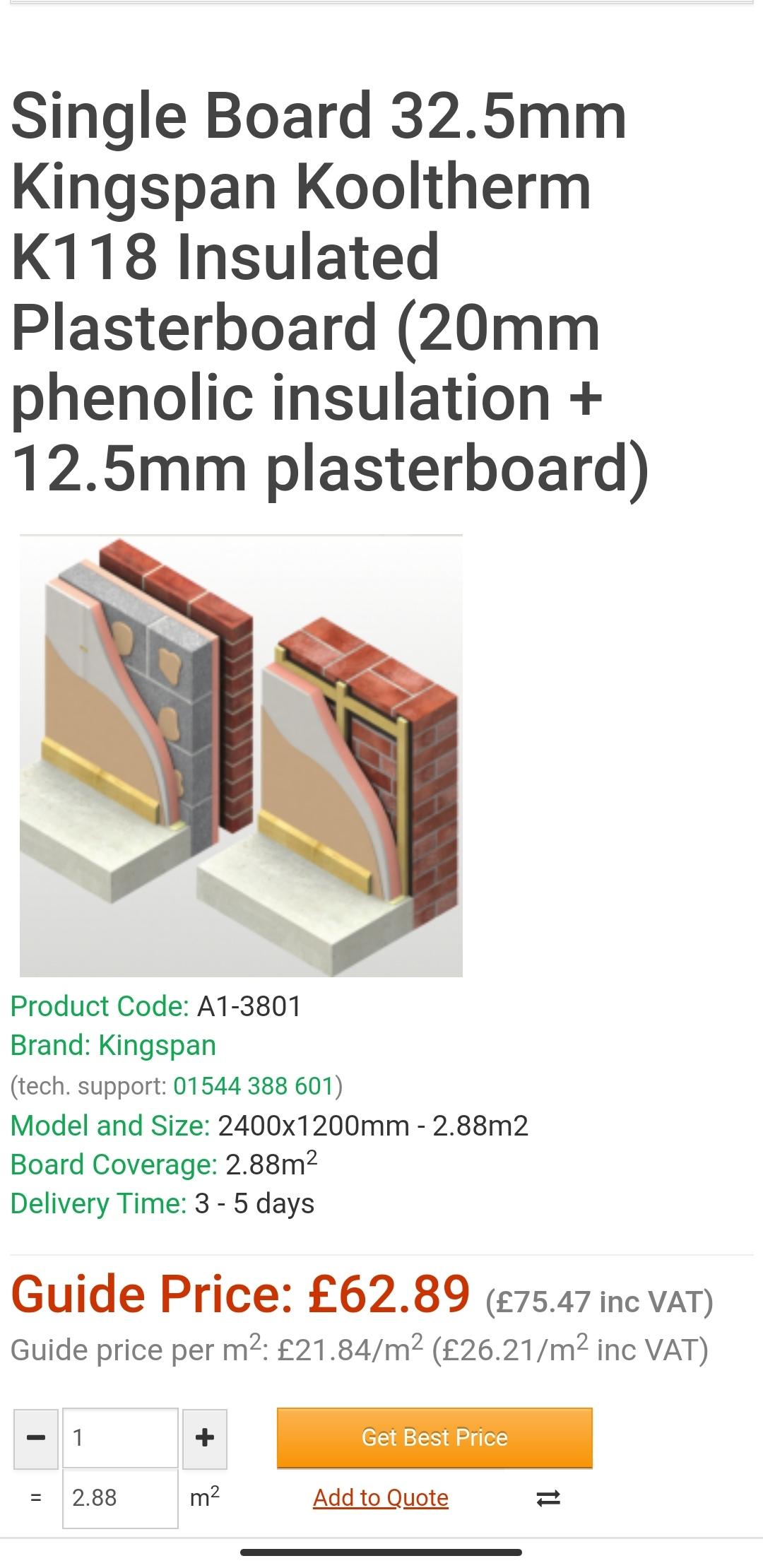

Iceverge Posted March 13, 2022 Share Posted March 13, 2022 I'm assuming that the wall between you and your neighbours is a solid 225mm block/brick wall? If so the acoustic plasterboard won't make much difference as you already have lots of mass there. More important for noise is ensuring all air pathways are sealed 100% and then decoupling the walls to prevent any transmission of noise through the structure, think a stand off stud/resilient bars. ( You shouldn't need to do this if it's a cavity wall) Once the noise is catered for, and you really really really need the room space insulated plasterboard is probably the goto, dot and dab or mechanical fixed. It is silly expensive mind you for the thinnest stuff. Link to comment Share on other sites More sharing options...

JKami84 Posted March 13, 2022 Author Share Posted March 13, 2022 @Iceverge thank you for an informative response. Yes it is a 225mm solid brick wall and they have 50mm celotex and standard plasterboard on their side. You talk of airgaps - well our ceiling is down and above the wall is hollow across neighbours garage roof (see image). They've packed their habitable part of their garage ceiling with insulation and we will pack with insulation too. I could buy a different "upgraded" insulating rockwool product to "stuff" above the 225mm brick wall section that separates us? And use the normal insulation on rest of the ceiling. Do you think that would make any acoustic difference? As to dot and dab. How much space does that take? Because if dot and dab takes about 15-20mm and then so does your 32.5mm product you showed me, then I may aswell continue with what's been started with 40mm battening with 25mm celotex (I am also going to Ask why he cant get 30mm celotex in this space? E.g. he has 40mm of space from the wall to play with right.). I know I am being pedantic here. .. but All I want is the best return on losing some width. If acoustic plasterboard alone would make no difference as you say. Then I may aswell do nothing. But if I do insulate then I may aswell use acoustic plasterboard anyway for minor price difference. Link to comment Share on other sites More sharing options...
