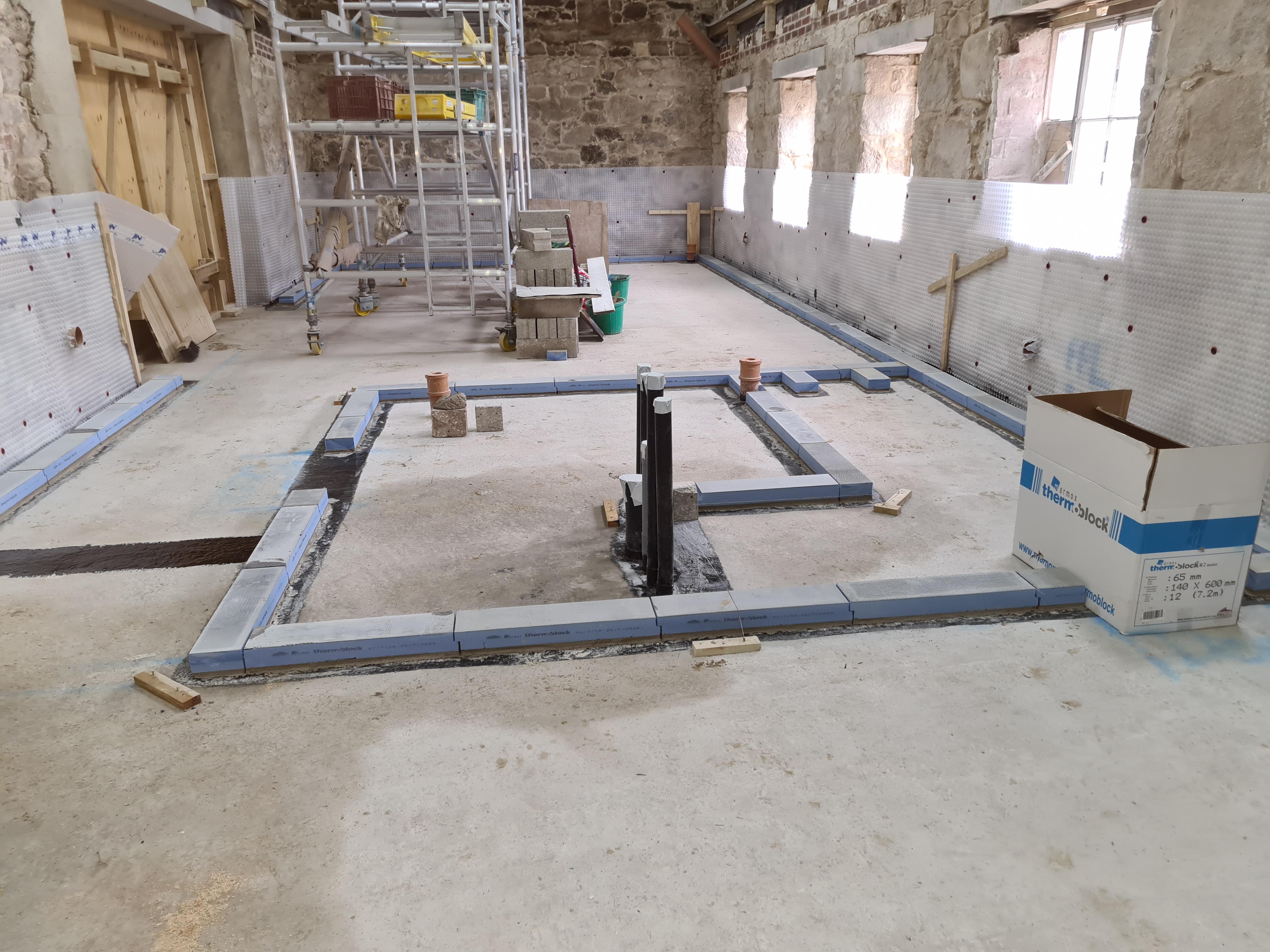

Perhaps I missed a trick with thermoblok, i have decided to go with a wider timber studwork so have shuttered and poured concrete to widen the perimeter dwarf wall. i have been reading up on sole plate sealng/ fixing, looking at either rubber or tapes., whats your plans? Maybe my BCO lack of interest or  guidance isnt a blessing. i thought with the number of stone barns/ structures converted there would be lessons learnt, best practice, do & donts everywhere on the web. I am still hearing the adviice, build a stud wall and fill with rigid insulation, i think things have moved on from this.
My sole plate isn't sealed down, the internal airtight membrane is sealed to the block with a tyvek bitumen double sided tape, creating the base of the airtight envelope.

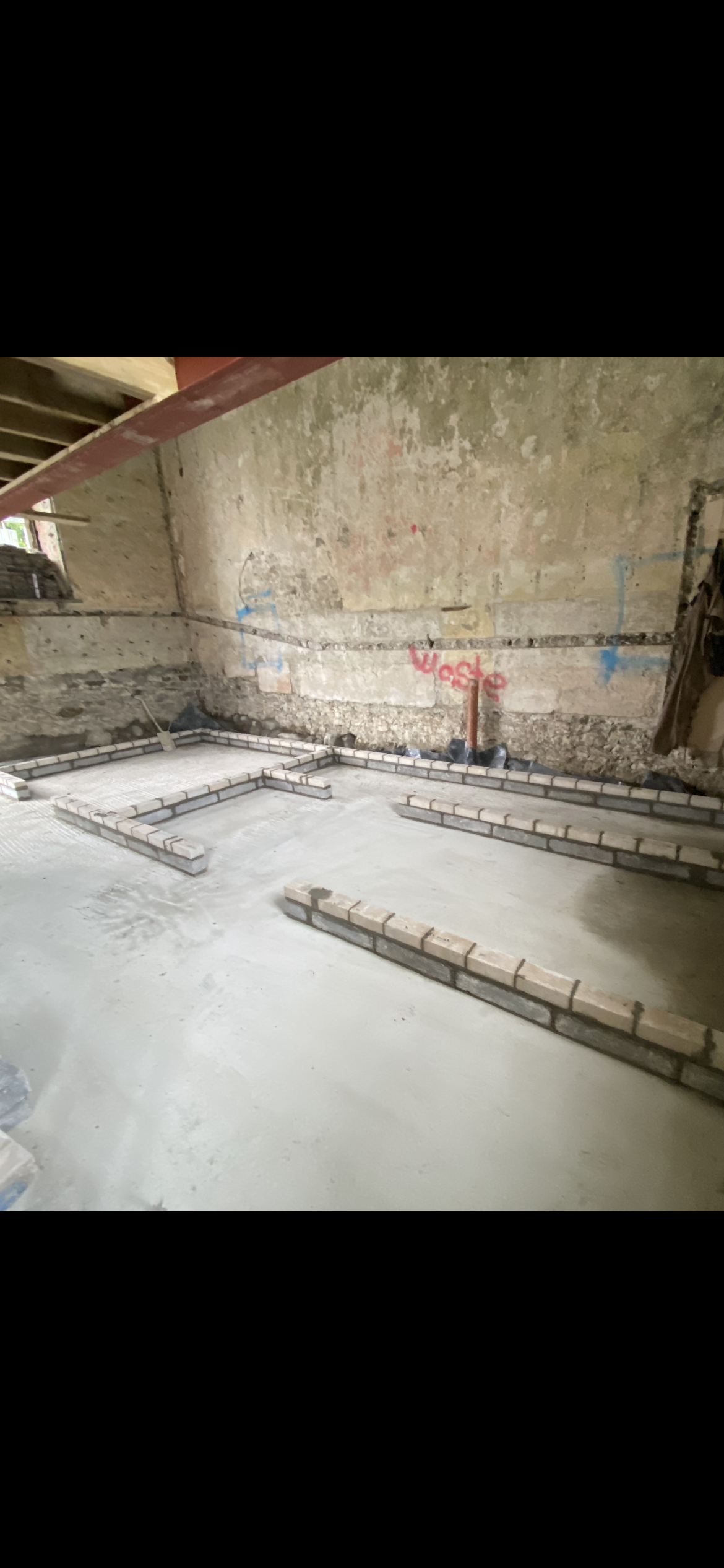

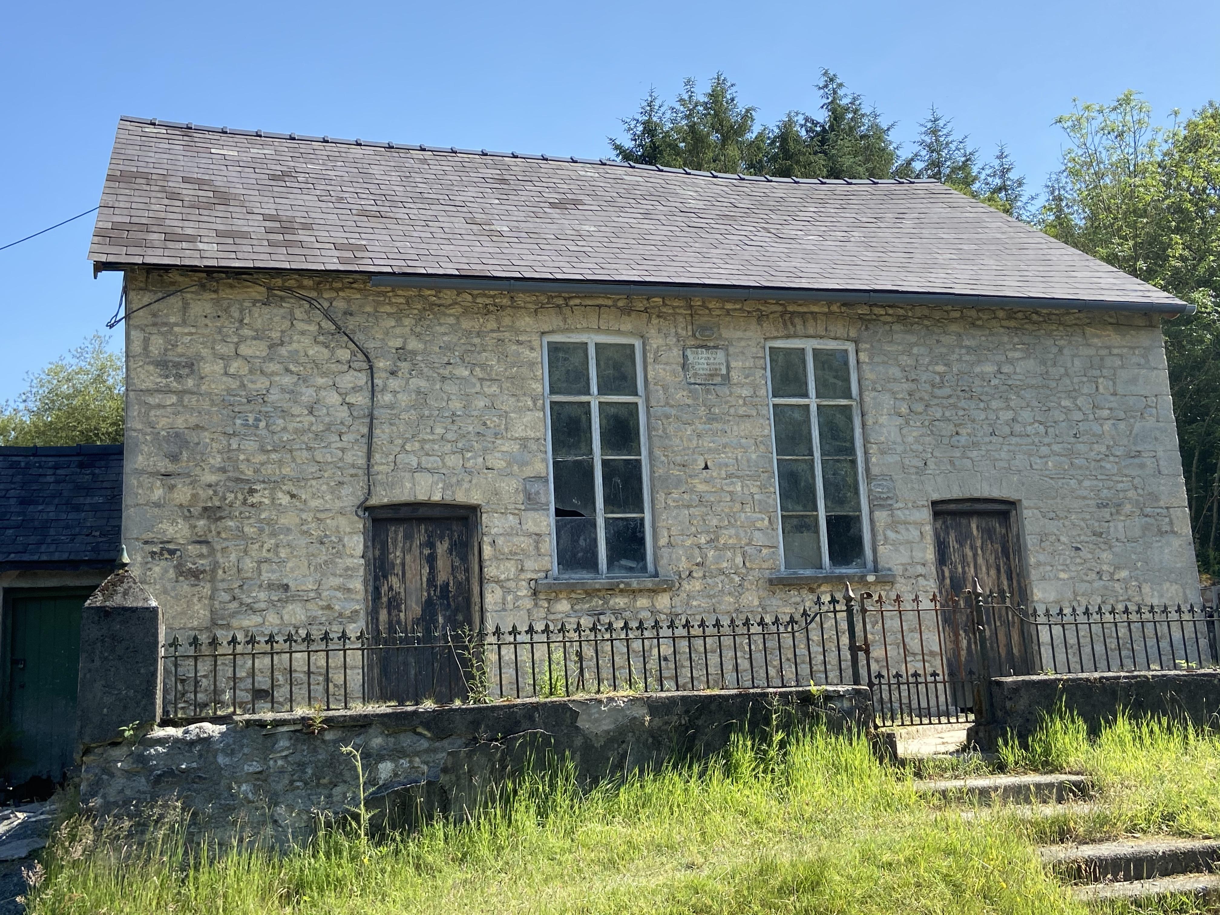

Thanks, I will have a look at the site. I am planning to leave the front un-rendered as it is relatively protected, just repoint and lime wash, the weather comes in from the back and side, which will be rendered.  I have made some decisions that I have regretted, which would be too costly to reverse, and if I was to take on another project I would do differently, but that isn’t going to happen! I am ok with the cavity, as I can see the logic of the wall acting as a form of cladding, can see the benefit of the fixed direct to wall insulation and cavity route. I have read lots of threads where builders have insulated stone buildings, but can’t think of many where people that live in these properties share how they have performed, so appreciate your building performance update. I know every day is a school day, just would be good to learn from someone’s else’s mistakes, rather than my own (is this something I should of said, or kept it to myself?)
it’s not all doom and gloom and I am enjoying the process…….honestly.
I will look at bitumen tape, just need to work out how to attach it when I lift the stud sections into place.
Link to comment
Share on other sites
I wrapped the housewrap around the top and bottoms of the stud so it was protecting the timber and then let the internal vcl do the rest with bitumen tape to the block at the bottom. The housewrap doesn't need to be airtight just the internal vcl.

55 minutes ago, Roger440 said:
How damp is it? Im not sure id have layed concrete. Thats likely to drive the damp to the walls. Depending on how much there is?
- the building is very dry, the damp areas you see in the right hand side of the photo is from under the old door and on the wall is where the ground is built up against the wall, which is to be removed soon. Where window openings have been made the wall has been very dry.
I quite like the look of it as it is. Pointing in lime i presume?

@RJHumphrey What a stunning looking place.
This rendering.. do you really have to do it, even if the other walls are half or a bit worse you will knock value off it, not just financial. It would be a real shame to render a beautiful place like that.

Thanks for the reply, I will have a read through the old threads to see if I have missed anything, any particular one you took most from?
The  photo was taken just after removing the render so the stone looked a lot lighter, and better in my eyes, but after a long winter it’s not looking so good, beauty is in the eye of the beholder and at the moment I like the look of lime washed stone, as it keeps the shape of the stone visible, rather than a render, are you not a fan?

3 hours ago, RJHumphrey said:
are you not a fan?
The lime wash is attractive, but so is the exposed stone.
In favour of the lime wash...it is an additional coating before the mortar  and seals any little gaps.
It emphasises the rough stone construction.
Conceals old repairs.
Relatively easy to repaint if needed.
Against: the rough stone face will catch and hold the rain.
For the exposed stone, depending on the stone itself, there is less of the absorbent surface.
If pointed near to flush, the rain will run off quickly and only the pointing hold water.
It is total rendering/ parging that is most effective but it is also rather plain and functional.
