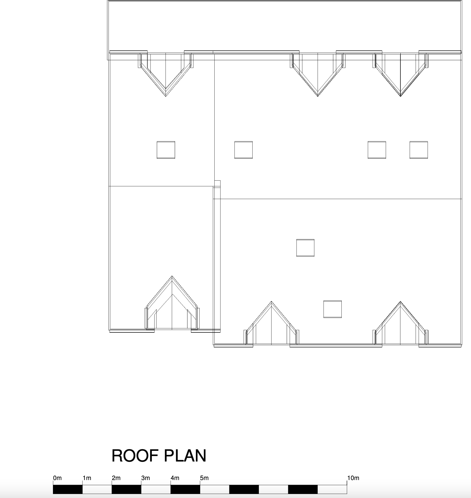

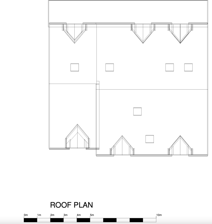

Nickfromwales Posted March 10, 2022 Posted March 10, 2022 12 hours ago, SBMS said: At the moment it is looking like PV is a no go because of roof design Can you upload your plans? 9 hours ago, SBMS said: I guess multiple inverters could fix this? Not quite. Its the number of connected cells that dictates the discharge rate, which is then further 'choked' by the limit of the throughput of the BMS. It's the batteries that are the thing that slows down rates of charge and discharge. 1 minute ago, SBMS said: And can that power capacity simply be 'doubled' by adding an additional inverter? As above, no. 8 minutes ago, Marvin said: As @SteamyTea says will the 7.5p price lasts? Not very long! This will go up again after your initial 12 month contract with Octopus runs out. They will likely ask you to adopt a fixed rate tariff first, and then migrate you to the ToU tariff. The fixed will be >40p/kWh from the get-go. 12 minutes ago, Marvin said: Many inverters indicate the max power conversion rate which is actually only for a limited time. Correct. You would also be hammering the guts out the system every single day, so its lifespan would be reflected in that usage pattern. You would need to choose equipment that had a warranty based on unlimited throughput. 14 minutes ago, Marvin said: Basic set up cost say £6k ( I'm sure someone will correct me if I'm wrong... ) Not even in the ball-park for a system such as the OP's requested capacity. Triple that, unless going for the cheapest of Chinese. @SBMS If AC coupled, have you yet done a DNO application? You would likely need a 3-ph solution, further increasing costs / complexity.

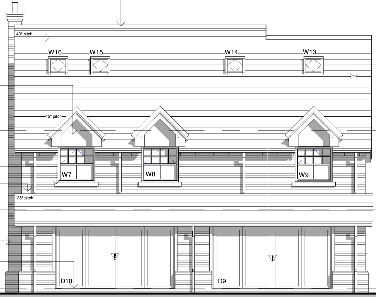

SBMS Posted March 10, 2022 Author Posted March 10, 2022 5 minutes ago, Nickfromwales said: Can you upload your plans? The roof with the 4 veluxes are the south facing roof. It's tight getting between the dormer window bits and the veluxes.I might be able to shift the veluxes up a bit.
Marvin Posted March 10, 2022 Posted March 10, 2022 Think I'm going to change my name to Slayerofdreams. 1
Marvin Posted March 10, 2022 Posted March 10, 2022 7 minutes ago, SBMS said: The roof with the 4 veluxes are the south facing roof. It's tight getting between the dormer window bits and the veluxes.I might be able to shift the veluxes up a bit. What pitch is the roof?
SBMS Posted March 10, 2022 Author Posted March 10, 2022 1 minute ago, Marvin said: What pitch is the roof? 40 degrees.No shading:
