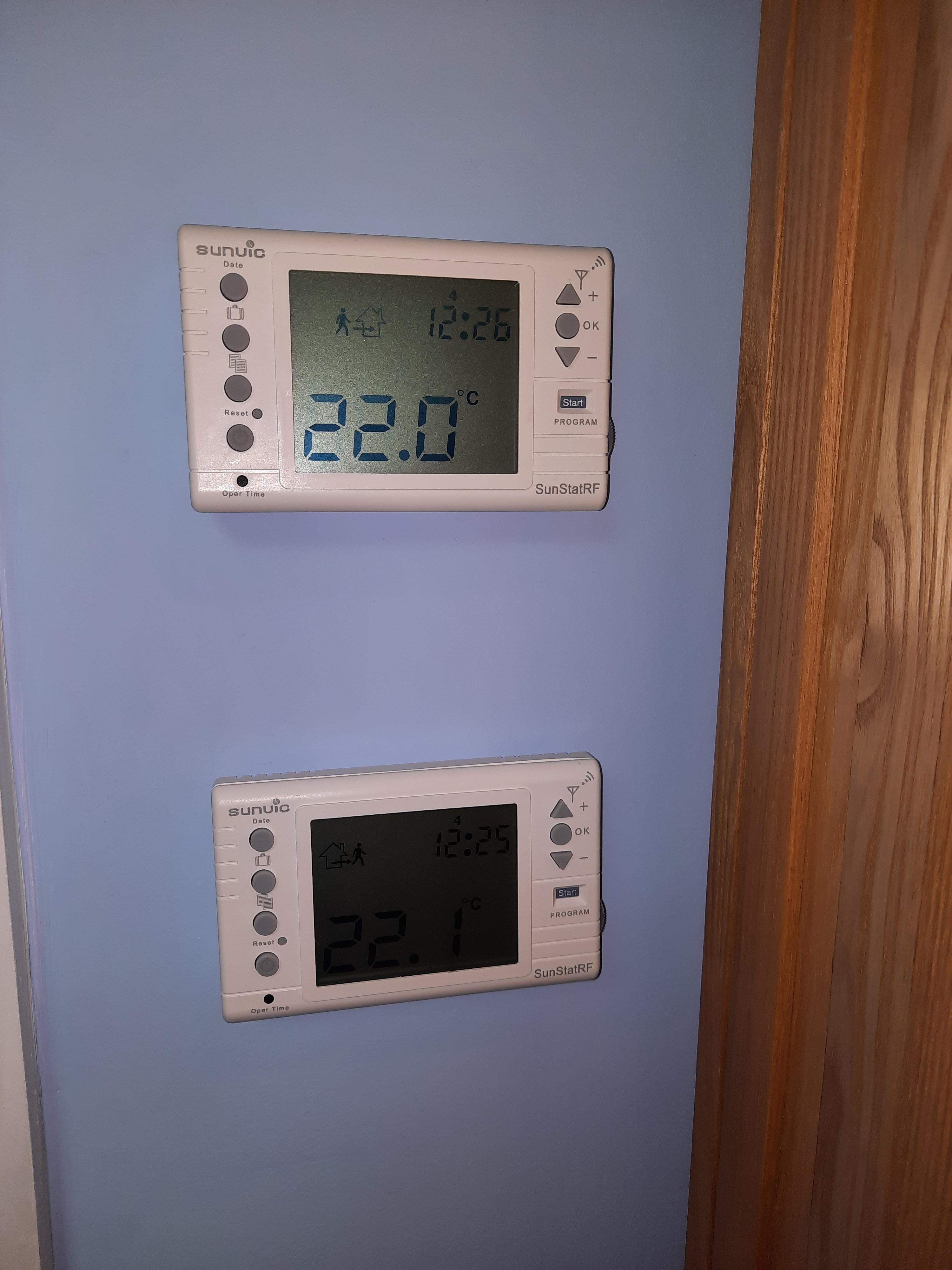

Marvin Posted March 10, 2022 Share Posted March 10, 2022 (edited) This is very close to what we are doing and our results. We are 24/7 set back 2C at 10.30pm until 6am. ASHP using (altered to our particular site and use requirements) the weather compensation mode. Difficult to split the heat/hotwater energy use so: All ASHP energy use approx 10kWh a day from 5th Jan until today for 100m2 floor. Presently 14C outside with heating automatic setup at 35C Top one heating, bottom one cooling. Edited March 10, 2022 by Marvin The word ASHP added for clarity after "All" Link to comment Share on other sites More sharing options...
