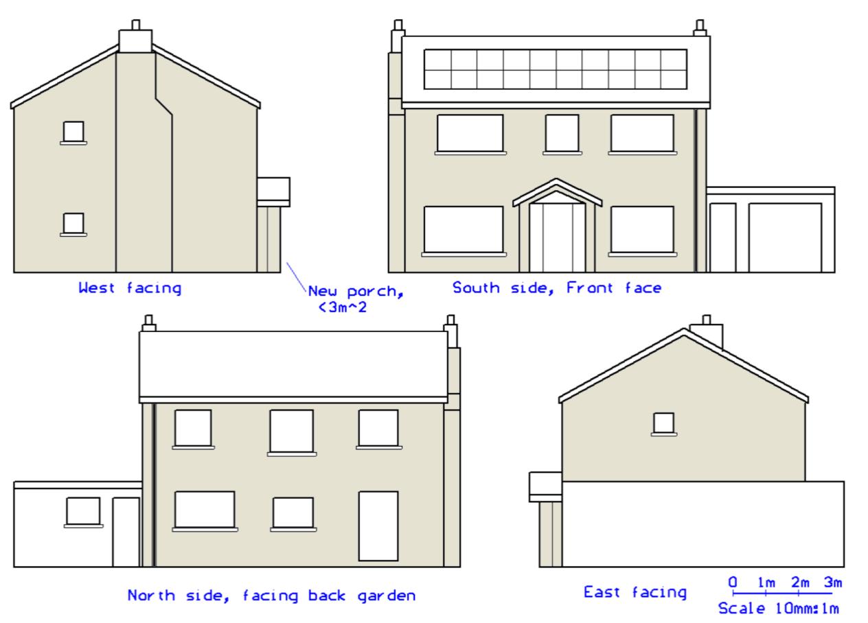

RobLe Posted March 6, 2022 Share Posted March 6, 2022 I would like to insulate our garage roof so it’s not so cold in winter, and also as it’s now the weakest link of our newly EWI-ed house. We are link-detached - there is a mirror image house to our right, linked by the garage. It’s a 1963 build, torched felt, no insulation, with a fall of only 1 in 100 with the lowest at the front, so it pools. It’s not leaking though. What I would like is to add shaped insulation making a warm roof (insulation, osb3, epdm), such that it is 140mm taller at the front, and 290mm taller at the back, giving a decent overall U value of around 0.13W/m2/K, and a fall of 1 in 40. Do I need full planning permission to do this? (Gah) Is there anything sensible else I could do? House plans attached, which I needed to do the EWI ! Link to comment Share on other sites More sharing options...

RobLe Posted March 7, 2022 Author Share Posted March 7, 2022 Thanks for the interest, I love that it's all energy related 🙂 Some details here: The back of the garage is mostly wall - it is being EWIed, U approx 0.22W/m2/K. I want a roof overhang detail to finish it. Between house and garage is a filled cavity wall, U=0.7. Internal door is insulated, it's the original cardboard honeycomb inner with wood outers - I squirty foamed the honeycomb to insulate. The side is a party wall to next doors garage, a mirror of ours. The personal doors are uPVC 3G all glass, fit well up and over door has 50mm celotex on the inside so U=0.5. It has rubber flaps around it, but will be leaky. I wish it has a window in it, it's south facing. I've not EWIed the front of the garage - there's not a lot of brick there. It would need PP. Roof is uninsulated, I think it is the original. House and garage are uninsulated concrete floor. I have perimeter insulated the house and back of garage, likely do front of garage too one day. Rest of house is U=0.15 EWI, gas use last year was 4.5MWh, the gas boiler living in a small room at the back of the garage with token IWI. The boiler has last Dec been replaced with a heatpump, but the pipe run is the same. There is actually a rad in that IWI room - not convinced there should be as it's technically not house, but the plumber 15 years ago persuaded me. It's never used. I know without deliberately heating it won't get very warm, but I expect it would be warmer. Right now it is 20C indoors, 5C outside (it was colder overnight), 10C in the garage. Just a bit warmer would make it a nicer space to use for diy in the winter, and turning on a heater in it now would cause mental anguish. Link to comment Share on other sites More sharing options...
