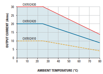

Mike Posted March 4, 2022 Author Posted March 4, 2022 On the question of durability, and looking at the thermal de-rate graph (below), while the 20A model has enough headroom to switch 3kW, I guess it may be worth paying the extra £10 to upgrade to the 30A version? Presumably it either handles the heat better, or generates less, as all models seem to have the same finned case. 2
TerryE Posted March 4, 2022 Posted March 4, 2022 (edited) @Mike, I did the same. I use the 20A versions and my loads all pull just under 12A so I am at the limit of the CKRX2420 spec at 60°C. I did just think of putting a 5V 100mm quiet fan below the SSRs to give a bit of forced are circulation over the fins to see if this made any significant difference. PS: I do find the nominal ratings of these devices very misleading because at 20A, say, the device needs to dump about 7W and there's no way that this would stay under 60 let alone 25°C without having forced airflow over the finned areas. Edited March 4, 2022 by TerryE 1

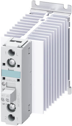

Mike Posted March 4, 2022 Author Posted March 4, 2022 Well after a few hours investigation, I'm inclined to specify a Siemens model instead - probably the 30A 3RF2330-1AA22 in my case - for a few reasons: It has a significantly bigger heat-sink At the planned loading it doesn't require additional space around it (though the 30A module is 45mm wide, thanks to the sink) The datasheets are clearer on the acceptable currents : 22A @ 40°C according for resistive loads (category AC-51 of IEC 60947-4-3) for the 30A version; 13.2A for the 20A version* Prices not too dissimilar to Crydom The range is certified for domestic use to IEC/EN 60335-1 (fairly certain I spotted only a reference to industrial applications for the Crydom models). *Siemens have an article discussing current specifications & the need for additional precautions in higher ambient temperatures for this range here. 1

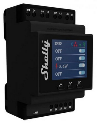

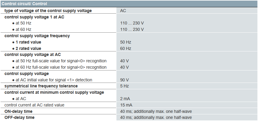

Mike Posted March 5, 2022 Author Posted March 5, 2022 (edited) On 04/03/2022 at 21:47, TerryE said: The Siemens models you reference are really optimised for industrial use and take 40V AC control inputs Expand Thanks for checking, and for the warning! Having read the Siemens datasheet more closely, the section on the control inputs does seem unclear to me - I've posted it below. There's a line for "control supply voltage 1 at AC" of 110 ... 230 V ; I had read that as meaning a voltage in that range switched it on - and a lower voltage off, which is as far as I'd got. There's also a line for "control supply voltage at AC... at 50 Hz full-scale value for signal<0> recognition" of 40V - meaning below 40V switches it off? And another "control supply voltage... at AC initial value for signal <1> detection" of 90 V - meaning over 90V switches it on? Are you able to add any illumination? I'm not used to analysing electronics specs in depth, as you may have spotted As for my intended voltages, I was planning to indirectly switch the SSRs at mains voltage. That is, I'm planning to use a Raspberry Pi + MQTT + NodeRed for control, but to switch a Shelly Pro 4PM, which outputs 230V to drive the SSRs. The Shelly's in there for a couple of reasons. Partly because it could be used to control the SSRs directly, either via the manual control buttons or the Shelly app, or its onboard access point (which also allows the setting up of weekly programmed schedules) - so a good fallback if there's ever a problem with the Pi. And also because it doesn't rely on a 'DIY solution', so I hope will not perturb the electrician or the inspector; being France all new installations have to be signed off by a national electrical inspectorate before they'll turn on the supply! In fact, it's slightly more complicated that the above. The Shelly will actually switch the SSRs via a load-shedder, which can temporarily shut down the SSRs & which also operates at 230V; in France your standing charge depends on the mains supply current that you subscribe to, so shedding the load from low-priority circuits at times of peak household demand has a short payback period, and flattens peak demand on the national grid. BTW, although I need 230V control, other Siemens models, such as the 3RF2330-1AA44, can apparently control using 4 to 30V DC (perhaps switching on at 4V and off at 1V, subject to the correct interpretation of their datasheet). Edited March 5, 2022 by Mike
TerryE Posted March 5, 2022 Posted March 5, 2022 First I misread the Siemens datasheet. The input will accept 240V at a current draw of around 15mA so yes, this could be switched by the Pro SM4. The advantage of a Wifi based switch is that it removes the RPi from the scope of the inspectors review, though you should have the CE DoC to hand. The disadvantage of Wifi is that it doesn't work too well in a steel equipment enclosure. 🙃 Though you could try putting the RPi inside the enclosure as well In the UK, the rule are different. Your electrics have to be signed off by a Part P certified electrician who certifies the house registration and does this in an online registry so the Binsp (and insurance companies) can look this up. Once my electrician read the datasheet for the Crydoms he was happy to ignore the 5V control signals as these are outside the scope of the certification. 1
Mike Posted March 5, 2022 Author Posted March 5, 2022 (edited) @TerryE thanks again for your feedback - it's good to have someone looking over my shoulder and pointing out potential problems. Enclosures are still plastic on this side of the channel, so WiFi will probably work, however the Pro range of Shellys also have Ethernet ports, so I can hook up to that if it doesn't. The Pi and network switch will be in the (mandatory) Communications Cabinet directly below the consumer unit, so it would only need a couple of patch cables. Keeping the DoC to hand is certainly a good idea; I'd like the electrician and inspector to be as equally disinterested as yours was! The French system is stricter than Part P, in that no electrician can sign off their own work. On the other hand - if you live in a detached house and don't sell it for 10 years after certification (to sidestep other legal issues) - then it's still possible to do a complete DIY installation over here, provided it meets the standards and is signed off by the inspector. Edited March 5, 2022 by Mike

Mike Posted March 6, 2022 Author Posted March 6, 2022 Well it looks like I may be choosing Crydom after all. After checking the wiring information for the Siemens units, only selected models are suitable for use with MCBs, and they can only be driven by 0-24V DC, or 4-30V DC (models ending -1DA06 & -1DA44; 3RF2330-1DA06 for example). Their other models require fuses, which aren't permitted in domestic installations...
