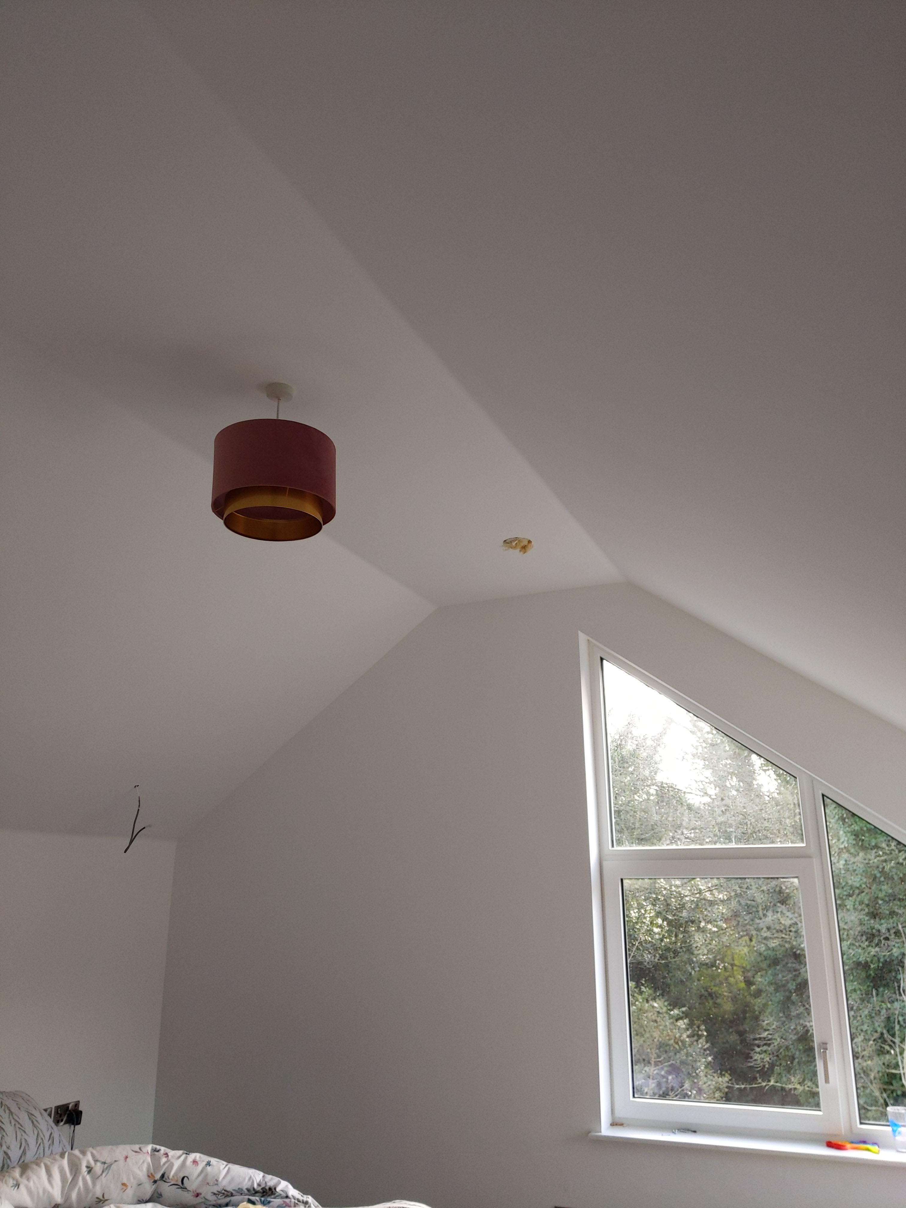

Alan Posted March 1, 2022 Share Posted March 1, 2022 Hi everyone, Currently in the process of planning our MVHR and have come across an issue i hope you can help me with. Where/how do you place the supply vents in bedrooms that have vaulted ceilings? The other aspect to consider is that the Timber Frame Company will be supplying/installing a Closed Panel System for the roof and external walls. Initially i thought i could use the partition walls but now don't think they're deep enough to accommodate the unit and ducting. Alan Link to comment Share on other sites More sharing options...

Conor Posted March 1, 2022 Share Posted March 1, 2022 (edited) Just drop in a service void at the ridge. 200mm should be more than enough. Run the ducts along the ridge and then down a service cavity to the manifold. This is ours. Still have 3.4m ceilings. We had to have one anyway to cover over the ridge beam. Edited March 1, 2022 by Conor 1 Link to comment Share on other sites More sharing options...
