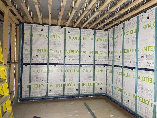

Thorfun Posted March 11, 2022 Posted March 11, 2022 my apologies to @DragsterDriver for hijacking the thread but I have another question about this as I work through doing the work. I have put up battens over the AVCL and all is good....apart from the fact that the wall feels 'squidgy' due to the PIR not being solid. this is probably expected. but I'm wondering if I should've covered the AVCL with OSB before battening to give a more solid base for the battens to rest on? Another thought I had was that with 25mm deep battens and 12.5mm plasterboard there is only 35mm for fixing things to the walls using plasterboard plugs. is that enough is what I was wondering or am I running the risk of, down the line, puncturing the AVCL when I attach things to the walls? so I could, in theory, add 11mm OSB to the front of the battens and then plasterboard directly on to that to give more room for fixings? obviously, OSB in either position is going to add substantial cost to the build so I wonder what others have done that have PIR internally to the TF studs. I've got this far in one room so still not too much effort to take the battens down, tape up the holes and start again! 1
Thorfun Posted March 11, 2022 Posted March 11, 2022 I should add that the battens are solid so it's not the wall that feels squidgy per se but the PIR behind the battens. so I've no concerns about the solidity of the plasterboard on top once added.
