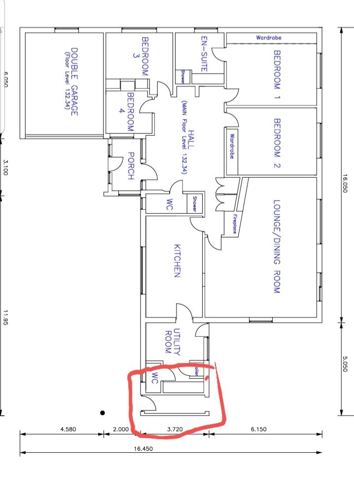

Zak S Posted February 24, 2022 Share Posted February 24, 2022 Hi. I am wondering if there are any design ideas you guys can suggest which can work with the existing building without the need to demolish and rebuild (which I am sure would be the best and cleanest but costly option). I have attached the existing measured building survey and topographical survey which I commissioned in Dec last year. You might have seen from some of my other posts including the Ground Investigation Report that: Ground is very soft and clayey hence the piles would be required for any extension work and some clever structural planning. Water table is at 1m. Existing foundation are 400m to 1m and hence determined to be unsuitable for second story unless some clever design ideas are required if I am to use the existing building structure. Demolish and build would not be done right away as needs to move in and complete couple of other project as well as sort the planning issue first. I would need to move in from April hence would need to do refresh of the property either including plastering/redecorating/kitchen/bathrooms. _2021-20-1 Topographical Survey and Street Scene Layout.pdf _2021-20-2 Existing Plans, Elevations & Sections Layout.pdf Link to comment Share on other sites More sharing options...
SimonD Posted February 24, 2022 Share Posted February 24, 2022 Clay ground and 400mm to 1m existing foundations does not necessarily preclude second floor extention, but does require the right designer and structural engineer. Solutions can include making the 2nd floor loads less than existing, especially if existing has concrete roof tiles, pad foundations to support point loads, ring beam around existing ground floor walls. I know this because my project uses all of these things and we've got 300mm foundations in places, and that's 300mm below dpc which is 150mm above ground level. How many trial pits/trenches have been dug to obtain information? In ours too few so poor assumptions were made until I insisted on digging and investigating more. When was the original house built? 1 Link to comment Share on other sites More sharing options...

Zak S Posted February 25, 2022 Author Share Posted February 25, 2022 (edited) 1 hour ago, SimonD said: I took that risk off my offer. The seller didn't accept so we walked How did you determine it. What is the right amount for which it would be something worth taking. Should I show to foundation specialist. One option I was thinking that how much would it cost remove the walls and put in the piles and then rebuild the walls instead if underpinning. The issue seems to be on one side only in the extension used as utility room (pic attached). There are crack along the lentils, along the DPC (quite wide that its causing dampness in that area) and in the boundry wall to the side of utility room. The rest of the property seem perfectly fine. Edited February 25, 2022 by Zak S Link to comment Share on other sites More sharing options...
SimonD Posted February 25, 2022 Share Posted February 25, 2022 (edited) 32 minutes ago, Zak S said: How did you determine it. What is the right amount for which it would be something worth taking. I spoke to a local surveyor and asked him to look at the property and review the insurer's report. He came back to me with a view regarding required remedial work plus a ballpark figure - it was complex due to banking on the side where there was subsidence meaning deep piles. I then assessed the rest of the site, for example poor access and neighbour close by whose garden we'd have to use for some of the work. Added my contingency and offered 200k below asking price. It's definitely worth getting it looked at by someone with relevant knowledge and experience. Edited February 25, 2022 by SimonD Link to comment Share on other sites More sharing options...
