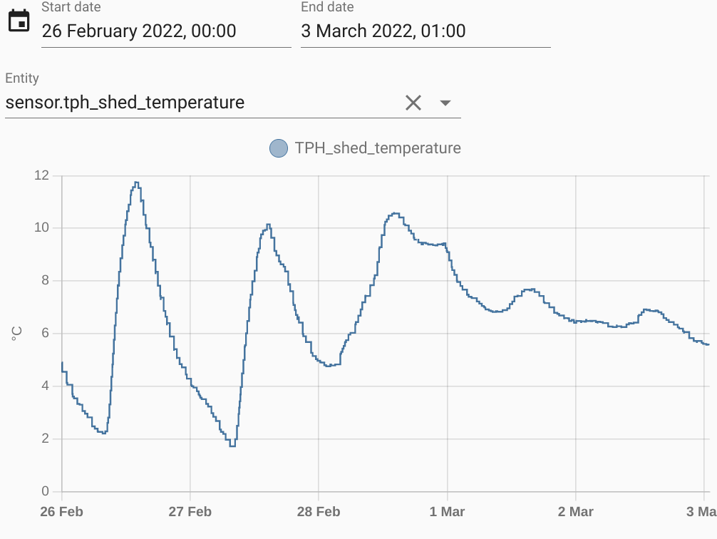

TerryE Posted March 4, 2022 Share Posted March 4, 2022 On 22/02/2022 at 12:31, SteamyTea said: Should be easy enough to bury a sensor a few mill deep into a wall. If you have a flush meter box in your outer skin then another alternative is to put in there. I also have an Aqara ZigBee temperature and pressure sensor in my garden shed, which feeds into my RPI4-based Home Assistant setup. Below is a quick screen grab from HA, but the data goes back a couple of years in InfluxDB. The shed is unlagged so tracks outside temperature well, but the sensor if in a dry environment. Link to comment Share on other sites More sharing options...
