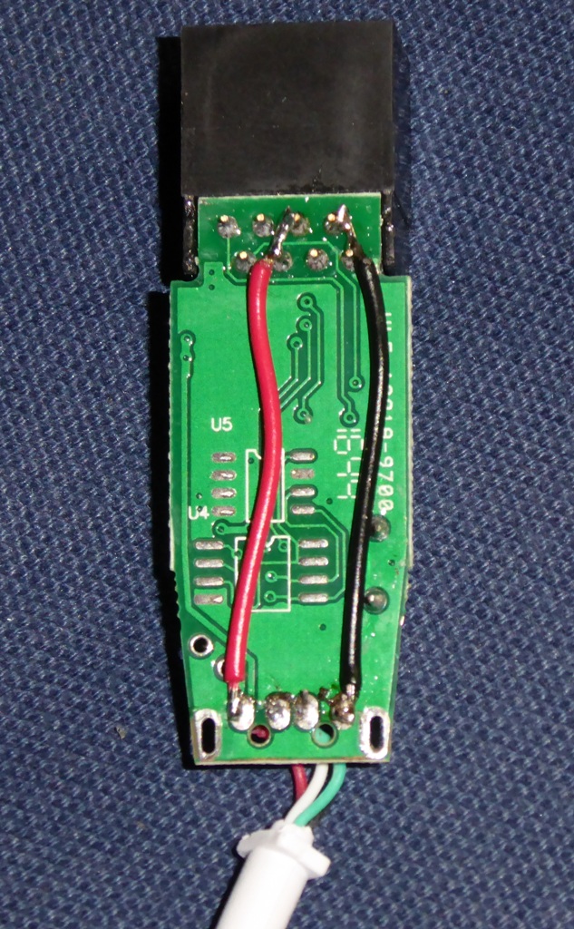

Made a bit of progress on making things smaller and simpler.  I discovered that there is a direct power connection between the power micro USB and OTG micro USB on the Pi Zero W, which means that the Pi Zero W can be powered just as well through the OTG micro USB port as it can through the adjacent power micro USB port.

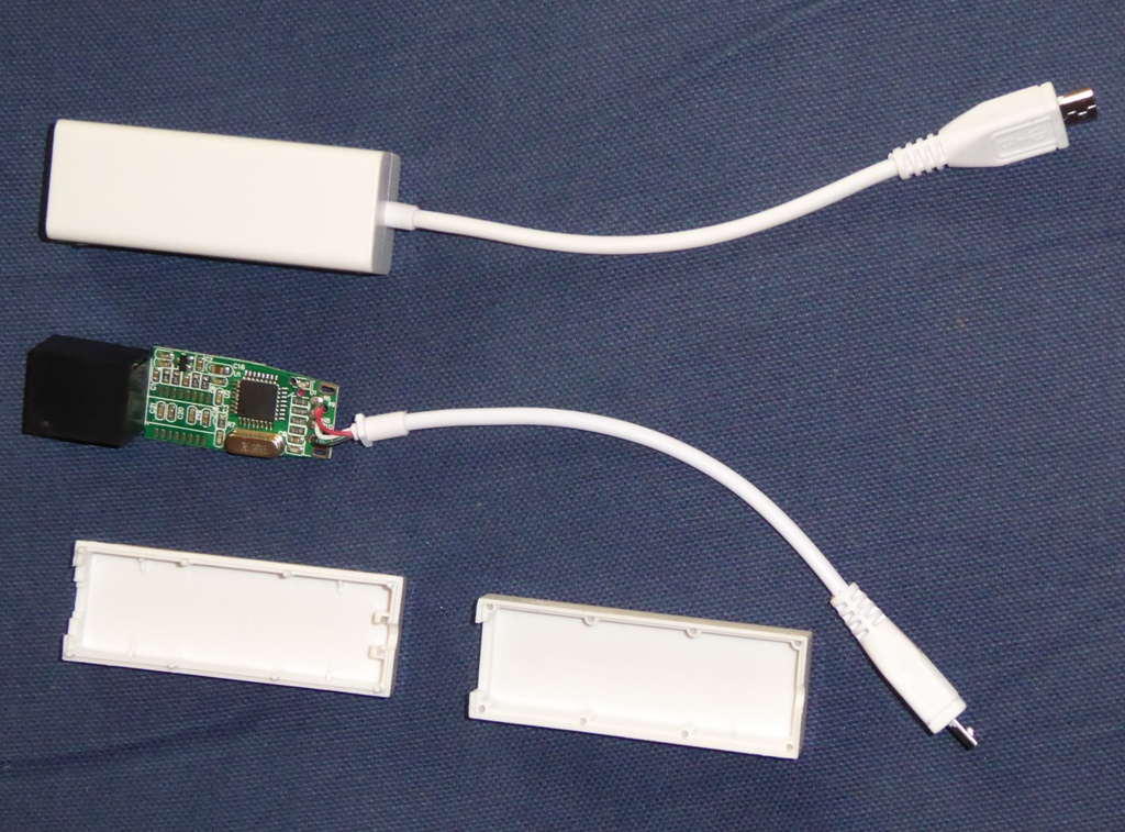

Next, I decided to take one of the cheap Ethernet to micro USB adapters apart.  Dead easy, the sticky labels on either side are all that hold the push together case in one piece.  This is what they look like when apart (one is untouched, the other has been pulled apart):
590e088494bdf_MicroUSBtoEthernetadapter.thumb.JPG.69b897e8da751a21385583aa1b9d2916.JPG

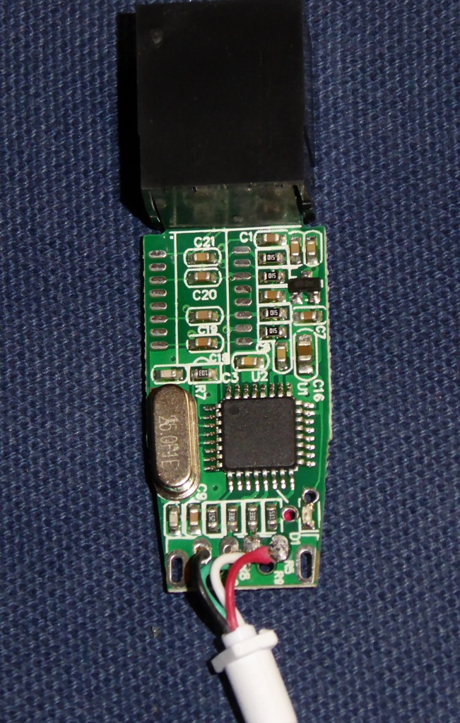

Here's a close up of the top of the module:
590e088c72410_MicroUSBtoEthernetadapter-topview.thumb.JPG.e3204e03d821d45c692e1179c6449bd9.JPG

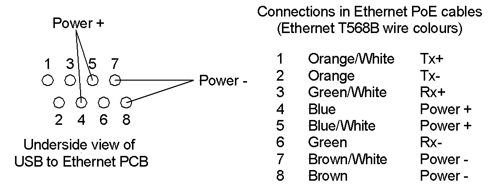

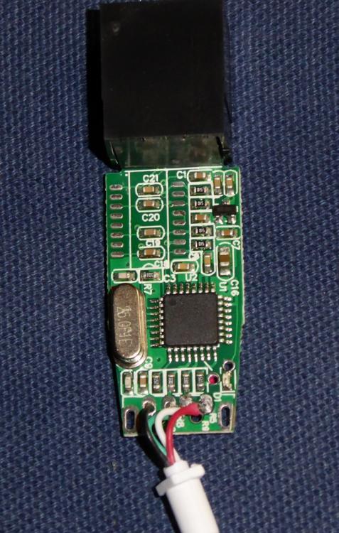

Next I discovered that the pins for power over ethernet were there on the underside of the board, so it was dead easy to just add two wire links to connect 5V to the USB lead:
590e0892cb7ac_MicroUSBtoEthernetadapter-bottomview-moddedforPoE.thumb.JPG.62bf3d1e1d876867acc23445ab88d5f9.JPG
I put the unit back in it's case, hooked it up to one of the cheap Chinese PoE injectors, plugged it into the Pi Zero W, plugged the PoE injector into a spare 5m Ethernet cable, with the opposite gender PoE adapter on the other end, which was plugged into a 5V power supply and the router, and lo and behold the Pi Zero W AP came to life, powered by the Ethernet cable alone.
This is one of the simplest bodges I've done, yet will be very handy in terms of being able to run a single length of Ethernet cable to the place where I want to put the AP, and have it both power the thing and transfer data back to the network.
Indeed, I'm seriously impressed by how easy this was to do, especially as I'd not bought the parts with this in mind!

Here's a bit more info for anyone that wants to run this pretty crude form of power over Ethernet.  Cat 5e/6 cable has four spare wires (two pairs) that aren't used, pins 4, 5, 7 and 8 at the connector.  This sketch shows where these connections are on the cheap Chinese Ethernet to USB adaptors, together with the cable colours for the T568B Ethernet cable (there are two standards, T568A and T568B, but my whole house happens to be T568B - it makes no difference as far as PoE is concerned):

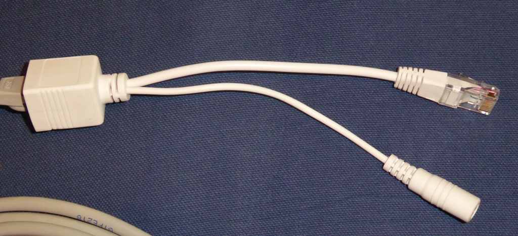

To inject power to the unused pairs, I used a cheap Chinese PoE injector.  These are sold as pairs on ebay, with a power socket on the power injection end and a power plug on the other end, to power equipment.  I've not bothered with the equipment end adapter, as I just soldered link wires inside the Ethernet to USB adapter:
590ecd08c7d47_ChineseEthernetPoEinjector.thumb.JPG.929153f3620c7e53573ce5b870f46f93.JPG
Typical prices for a pair of these PoE adapters is less than £2 for a pair, including shipping from China.  An ebay search for "Ethernet PoE adapter" will throw up hundreds of these things, I bought a bag of 5 pairs for a bit over £8.
I should point out that this is a non-standard way of using PoE, and won't work over long distances.  It depends on the amount of current the device at the end draws, but I've found that as long as the current is below about 500mA then there's very little voltage drop over up to around 15m of cable.  More than that and you would be better looking at proper PoE systems, that use a higher voltage on the cable with a high efficiency voltage regulator at the equipment end.  By increasing the voltage and regulating it at the equipment end, proper PoE gets around the cable voltage drop and runs a lower current down the cable.
For home use, where you know what you're doing, the "Commando" style system of just running low voltage DC down the unused pairs works fine, though, you just need to remember what voltage any particular cable is running at, if you have more than one (I'm running 12V over a system like this to power our VDSL modem, which is mounted on the wall next to the master socket).

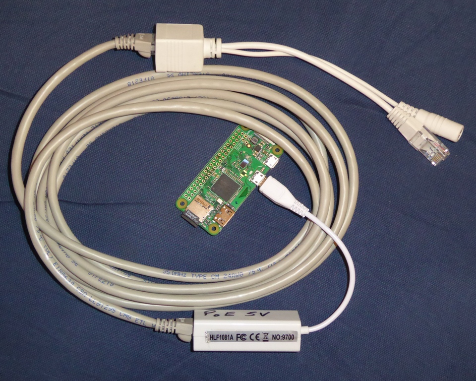

Finally, this is the complete test setup from yesterday, with the Pi Zero W wireless AP hanging off the end of the cable:
Note that I've marked the modified Ethernet to USB adapter to show that it has to run on 5V PoE, just in case I forget at some future date!

@JSHarris Do these adapters isolate pins 4,5,7,8 on the injector RJ45 plug ? In a Gigabit system these pins aren't spare and I'd be worried about uncontrolled DC voltages on the ports of a gigabit switch.
Yes they do.  The Ethernet plug on the adapter/injector only has a four core cable, so there are no connections to the Gigabit pins.  It's only the Ethernet sockets that use all 8 pins, 4 for data and 4 for power, so you could use these safely on a Gigabit switch or router (accepting that you're only going to be able to run at 10/100).
