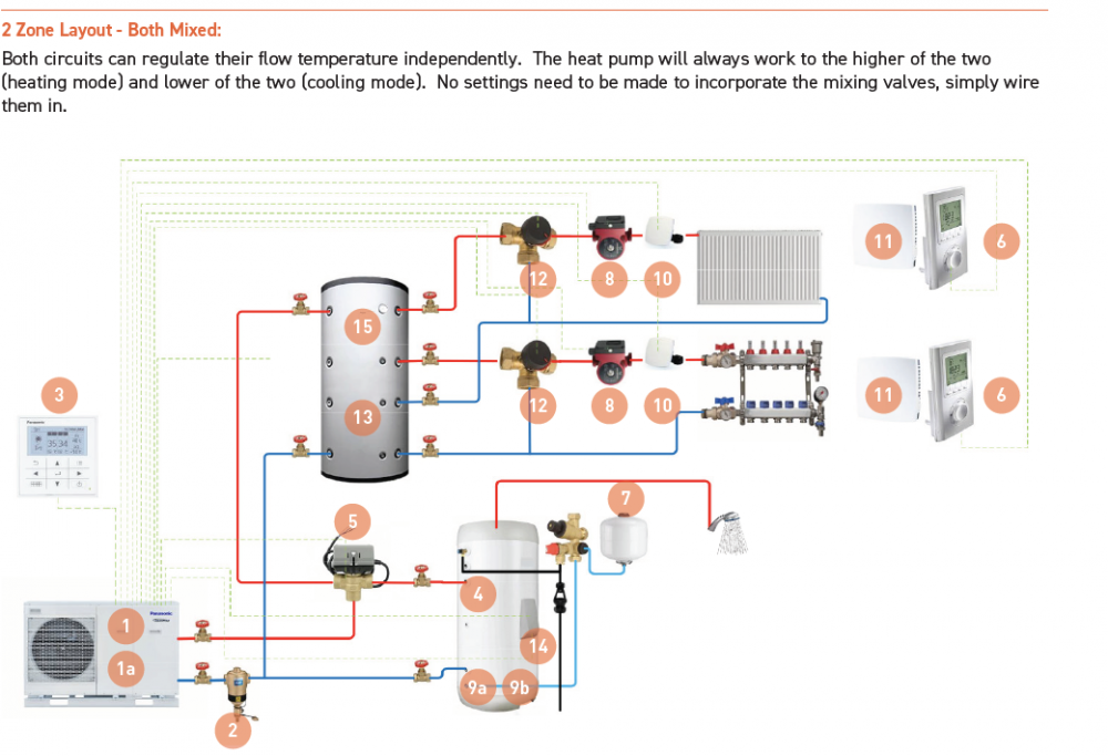

Mr Blobby Posted February 14, 2022 Share Posted February 14, 2022 Sorry to ask again about my heating system but my M and E consultants are not good listeners. They are proposing two MVHR post-heaters/coolers connected to a Panasonic ASHP. The UFH to be used for heating only. I'm OK with the Comfopost post-heater upstairs but they don't want to do UFH cooling downstairs, which seems like a no-brainer to me. The M and E propsal would have 3 zones, CP1, CP2, and UFH. This just seems over-complicated, more expensive, and less efficient. Before I go on, I am very grateful to @Dan F who over the weekend has patiently answered my questions and explained his similar setup (with comfopost but a different ASHP vendor) and how mixed circuits can control flow temps on the different "zones". Before I make an ass of myself by telling my M and E people how to do their job, I just want a sanity check here first because the solution below is so much simpler and more effective than my M and E proposal that I think I must be missing something. From the latest manual it looks like Panasonic support 2 mixed circuits out of the box, with each "zone" having a pump, mixing valve and temp sensor. A single buffer can be set up to be controlled by a temp offset from the heating/cooling circuits flow temps. UK_INSTALLATION_MANUAL_H 2020V11 (002).pdf Here's page 37 from the latest Panasonic manual: So if I were to replace the radiators above with the comfopost, then I can run UFH and comfopost at different flow temps, say 45,25 heating and 10,18 cooling. This is far too simple to set up. Is this the right way to set up my system for UFH and comfopost heating/cooling. Have I missed anything? Has anyone else set up a Panasonic heat pump in a similar way with mixed circuits for heating cooling, and if so, is it really this simple? Link to comment Share on other sites More sharing options...
Dan F Posted February 14, 2022 Share Posted February 14, 2022 (edited) This is exactly what I have set up, apart from the fact that our installer also insisted on installing a (IMO redundant) circulation pump and zone valves. I don't know exactly what Panasonic supports, but from that snippet it looks like it suppots this setup at least. I'd also look to see if the Panasonic controller also supports i) use of different (optional) heat curves for different circuits with min/max temps. ii) has dew point monitoring to automatically limit UFH temperature etc. You may not use these for ComfoPost, but both heat curve and dew point monitoring are useful for UFH On the Comfopost(s), have you looked a the very low heating/cooling output that they provide: https://www.paulheatrecovery.co.uk/wp-content/uploads/2020/07/ComfoPost-CW6-PAUL.pdf. I don't know how much glazing/shading you have, but unless you cooling load is very low I would not look at only using comfopost for cooling. In fact, assuming if you are using UFH cooling downstairs (which I agree is a no-brainer), I would only use Comfopost (vs. fancoils) upstairs if you have comprehensive shading (e.g. automated blinds on most windows). Otherwise the limited output from Comfopost probably just is going to be enough on a hot summers day. You mentioned your cooling demand is around 3W/m2. What is your total area? What cooling power can ComfoPost provide based on flow rates? Even if Comfopost can meet your cooling load, you still need to consider if you have any rooms without shading which suffer from solar gain and may overheat. If this is the case, you would need aircon or fancoils in these areas, and you could not depend on Comfopost. PHPP doesn't consider things room-by-room, only the house as a whole. Edited February 14, 2022 by Dan F Link to comment Share on other sites More sharing options...
Mr Blobby Posted February 14, 2022 Author Share Posted February 14, 2022 (edited) 3 hours ago, Dan F said: Th I'd also look to see if the Panasonic controller also supports i) use of different (optional) heat curves for different circuits with min/max temps. I think it does from what I have read in the manual Quote ii) has dew point monitoring to automatically limit UFH temperature etc. I don't think Panasonic support this but I would hope that 18C flow to the UFH would be warm enough to avoid condensation on the manifold umnless RH levels were >95%. Quote You may not use these for ComfoPost, but both heat curve and dew point monitoring are useful for UFH On the Comfopost(s), have you looked a the very low heating/cooling output that they provide: https://www.paulheatrecovery.co.uk/wp-content/uploads/2020/07/ComfoPost-CW6-PAUL.pdf. I looked at the conmfo post data, I don't get how the cooling output relies on 100% humidty ! Quote You mentioned your cooling demand is around 3W/m2. What is your total area? What cooling power can ComfoPost provide based on flow rates? Even if Comfopost can meet your cooling load, you still need to consider if you have any rooms without shading which suffer from solar gain and may overheat. If this is the case, you would need aircon or fancoils in these areas, and you could not depend on Comfopost. PHPP doesn't consider things room-by-room, only the house as a whole. Coolind demand is ony 500W, but your'e right, there will be parts of the house without blinds that will suffer local overheating. I think I need to speak to my M and E people about using the UFH for cooling. Edited February 14, 2022 by Mr Blobby Link to comment Share on other sites More sharing options...

NCXo82ike Posted September 6, 2022 Share Posted September 6, 2022 This is a really helpful thread and hoping I can learn from the experiences of people on here. Planning an extensive refurb/rebuild of a place with insulation, ASHP, and MVHR. In addition to UFH (certainly on the ground floor, likely upstairs), I'm keen to install a Comfopost, primarily for a little cooling on the hottest days. It's also great to see that you can have different flow temperatures between the Comfopost and UFH, since I was concerned I'd be running the Comfopost at minimal output to avoid dew point in the UFH system. This may be a silly question, but is there any reason why the Comfopost would require a Zehnder MVHR? Or could the supply from another MVHR e.g. Vent-Axia be run too the Comfopost, through a Comfowell, and then distributed? Link to comment Share on other sites More sharing options...
NCXo82ike Posted September 6, 2022 Share Posted September 6, 2022 On 14/02/2022 at 11:19, Mr Blobby said: Sorry if I'm just stating something obvious here- I'm quite new to this. Just wondering if in the heating setup you've outlined with a 45,25 supply to the comfopost and UFH respectively, are you not heating the whole buffer tank to a greater temperature than your UFH would need and then blending the temperature down, dropping your COP on the whole heating setup for the sake of the additional comfopost heat? I guess the reverse is also true for cooling, but in my mind the comfopost would do a greater proportion of cooling that of heating. I've not done the sums yet and that would naturally vary between installations. Link to comment Share on other sites More sharing options...
Mr Blobby Posted September 6, 2022 Author Share Posted September 6, 2022 Unlike @Dan F I haven't implemented any of this yet, but this configuration comes out of the panasonic box and is what we plan to do. 42 minutes ago, NCXo82ike said: Sorry if I'm just stating something obvious here- I'm quite new to this. Just wondering if in the heating setup you've outlined with a 45,25 supply to the comfopost and UFH respectively, are you not heating the whole buffer tank to a greater temperature than your UFH would need and then blending the temperature down, dropping your COP on the whole heating setup for the sake of the additional comfopost heat? Basically yes, but because the MVHR air flow rates are so low and the capacity of the air to transfer the heat from the heat exchanger quite low, then in realoty the temperature difference will likely be smaller, more like 35/25 heat, 15/20 cooling. I think anything more will result in a very hot or very cold heat exchanger in the comfopost that the air supply in the ducts cannot transfer quickly enough. At 35 heat and 15 cooling the COP should remain > 3. For the cooling our solar PV will be powering it all anyway so there is no energy cost. 42 minutes ago, NCXo82ike said: I guess the reverse is also true for cooling, but in my mind the comfopost would do a greater proportion of cooling that of heating. I've not done the sums yet and that would naturally vary between installations. What I am hoping to acheive from the mixed circuits is the ability to tinker with different temps to see what suits us best. In reality I expect the comfopost to make a small difference upstairs where the UFH will do the heavy lifting in the more important downstairs. 1 hour ago, NCXo82ike said: This may be a silly question, but is there any reason why the Comfopost would require a Zehnder MVHR? Or could the supply from another MVHR e.g. Vent-Axia be run too the Comfopost, through a Comfowell, and then distributed? Good question. I don't know. I do know the Zhender units are not cheap and other MVHR units with heat exchangers are available. Link to comment Share on other sites More sharing options...
