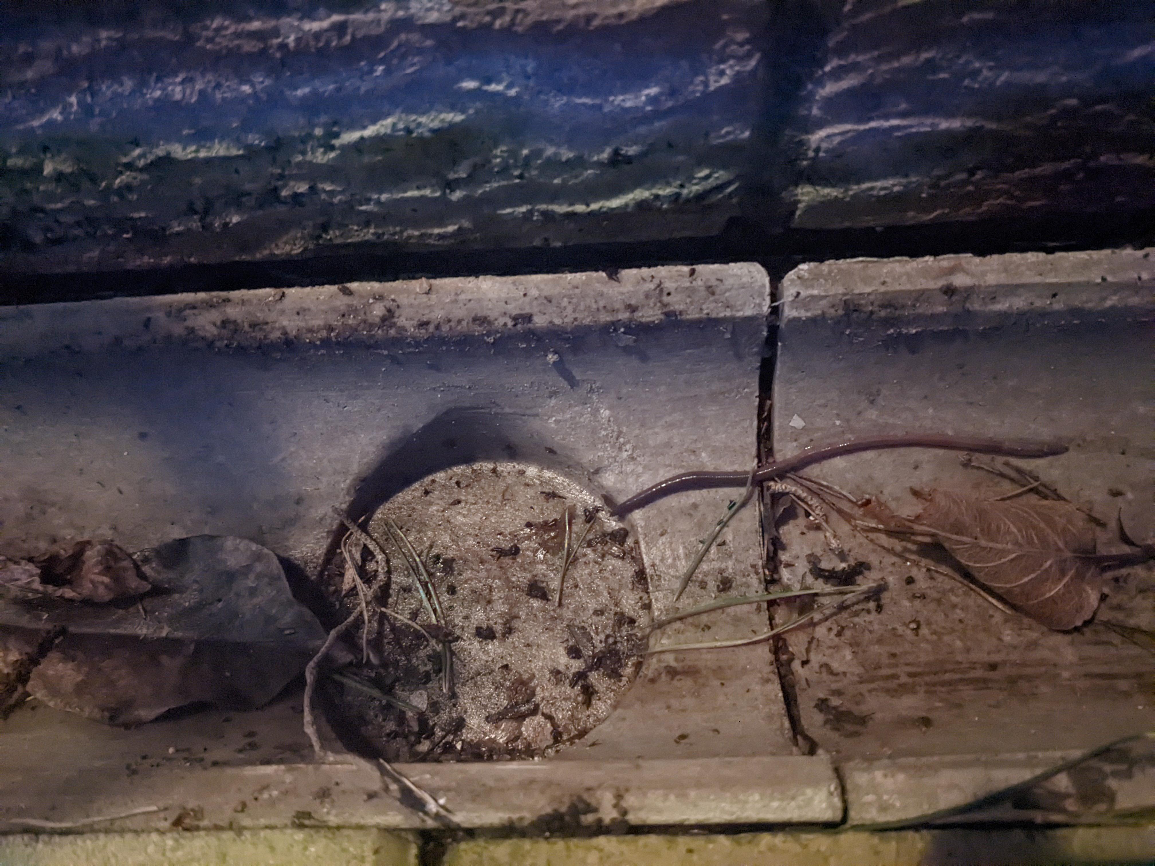

BobAJob Posted February 8, 2022 Share Posted February 8, 2022 The other day I was looking at some ACO drainage channels that a patio installer installed around part of the house to keep collecting rainwater away from low lying air bricks. I noticed the installer hasn't mortared all the way around the end of each channel unit where it joins to neighbouring channel units. He has just mortared the bottom end part of each channel unit. To me this means that the water isn't staying inside the channel and running to the drain. Instead the water is leaking away into the neighbouring ground. I'm not sure why he has done this. Is my thinking correct? Link to comment Share on other sites More sharing options...

Roundtuit Posted February 8, 2022 Share Posted February 8, 2022 I wouldn't worry about it; from memory, I think they have a slight lip that over-laps with the next channel. Any slight gap will soon silt up and losses will be minimal, but you can always smear a bit of gutter sealant over the join from above if you like. The main thing is that they are well bedded in mortar so they can't move. Link to comment Share on other sites More sharing options...
BobAJob Posted February 8, 2022 Author Share Posted February 8, 2022 (edited) Ours are Clark Drain ones. Photo attached. CD CS10.10 with metal slotted covers Edited February 8, 2022 by BobAJob Link to comment Share on other sites More sharing options...
BobAJob Posted February 16, 2022 Author Share Posted February 16, 2022 Is it ok to not having mortar in the joints? Link to comment Share on other sites More sharing options...
