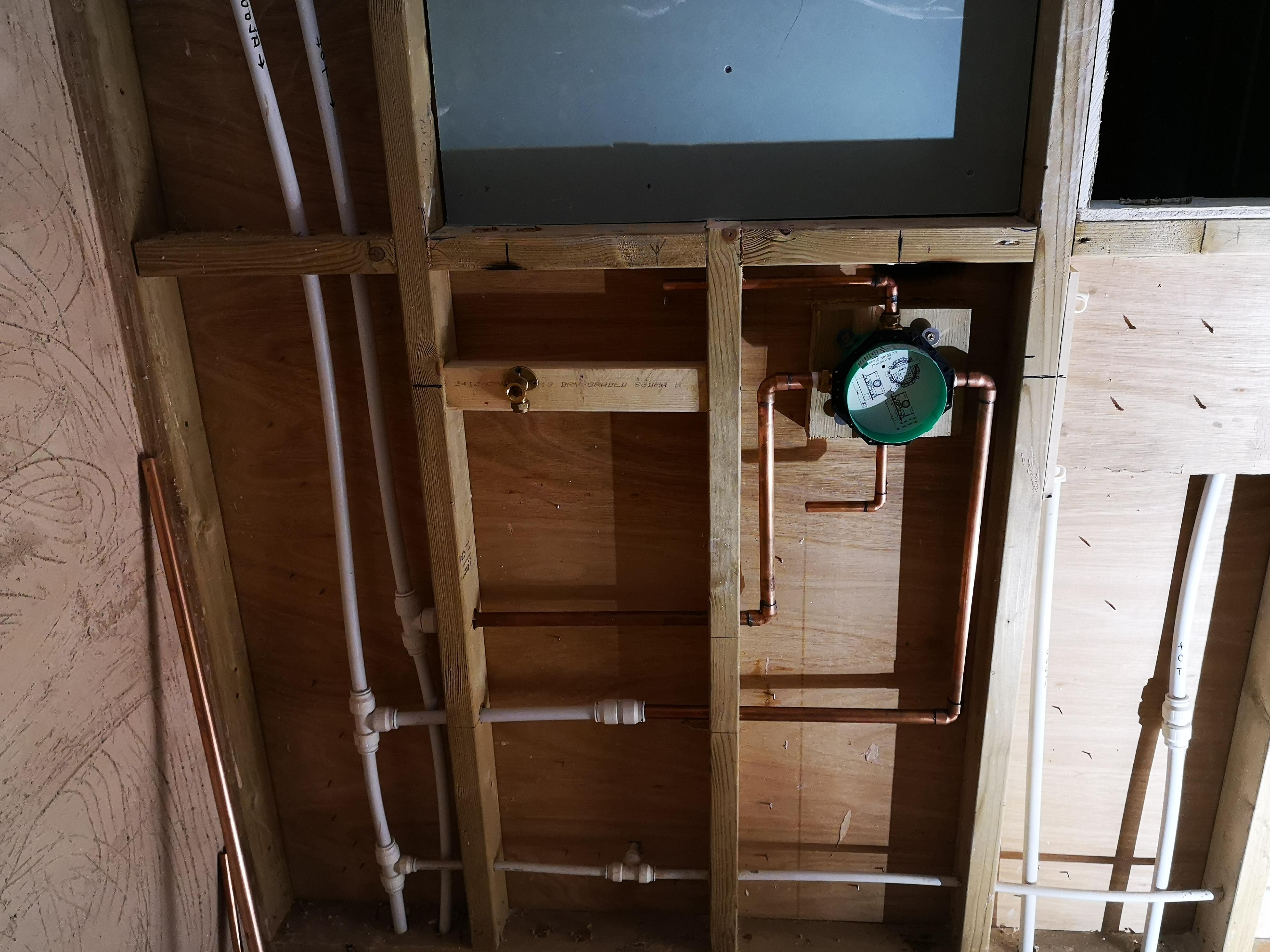

Porthole Posted February 8, 2022 Share Posted February 8, 2022 Hello Please can someone tell me if it matters if different types and sizes of pipes are used to plumb the house? We have all manner of stuff being used - didn't know if it affected pressure or anything. Is plastic just as good as copper these days? I've never come across it - we've always had copper pipes installed by the plumbers in the past. In one bathroom, they have used copper to connect to the shower valve, in the other it is plastic. I asked why and they just said it was what was available. Be grateful for your thoughts. Thanks again Link to comment Share on other sites More sharing options...
Conor Posted February 8, 2022 Share Posted February 8, 2022 Looks exactly same as us. Plastic push fit is generally used on long runs from source to outlet. We used copper for the last few bends and connections to outlets as you need straight pipes to it to be a neat job. 22mm coiled plastic pipe is hard to use in tight spaces as you can never pull it straight. Also most taps etc use compression fittings, so copper is best. Same at the other end at the manifolds / tanks / pumps etc. Our build has everything from 10mm plastic push fit, to 1" hand soldered copper via everything in between. Link to comment Share on other sites More sharing options...

Porthole Posted February 8, 2022 Author Share Posted February 8, 2022 4 hours ago, Conor said: Looks exactly same as us. Plastic push fit is generally used on long runs from source to outlet. We used copper for the last few bends and connections to outlets as you need straight pipes to it to be a neat job. 22mm coiled plastic pipe is hard to use in tight spaces as you can never pull it straight. Also most taps etc use compression fittings, so copper is best. Same at the other end at the manifolds / tanks / pumps etc. Our build has everything from 10mm plastic push fit, to 1" hand soldered copper via everything in btween. Thanks - good to have an explanation for why different pipes are used. Some plastic ones are thinner than the others though and just wondered if that matters from pressure etc point of view. If that is ok, should the only issue be the connections between the different pipes? Thanks Link to comment Share on other sites More sharing options...
PeterW Posted February 8, 2022 Share Posted February 8, 2022 1 hour ago, Porthole said: Some plastic ones are thinner than the others though and just wondered if that matters from pressure diameter affects flow usually rather than pressure when pipes are long. Link to comment Share on other sites More sharing options...
hb1982 Posted February 10, 2022 Share Posted February 10, 2022 Good quality plastic if installed properly should last as long as copper. When installing plastic: 1. Use as few fittings as possible. use cold form bend fitting where possible. 2. Support and clip pipe as per instruction, usually every 800 to 1000mm 3. Only use pipe and fittings from the same manufacturer 4. Remind to install one size bigger in plastic installation. e.g. 15mm copper is (I.D. 13.6mm); Plastic 15mm (nominal) - I.D. is 11.3mm. 5. Press fit is better than push fit but not usually available in domestic contractors 6. PEX pipe is far better than grey PB pipe. Link to comment Share on other sites More sharing options...
