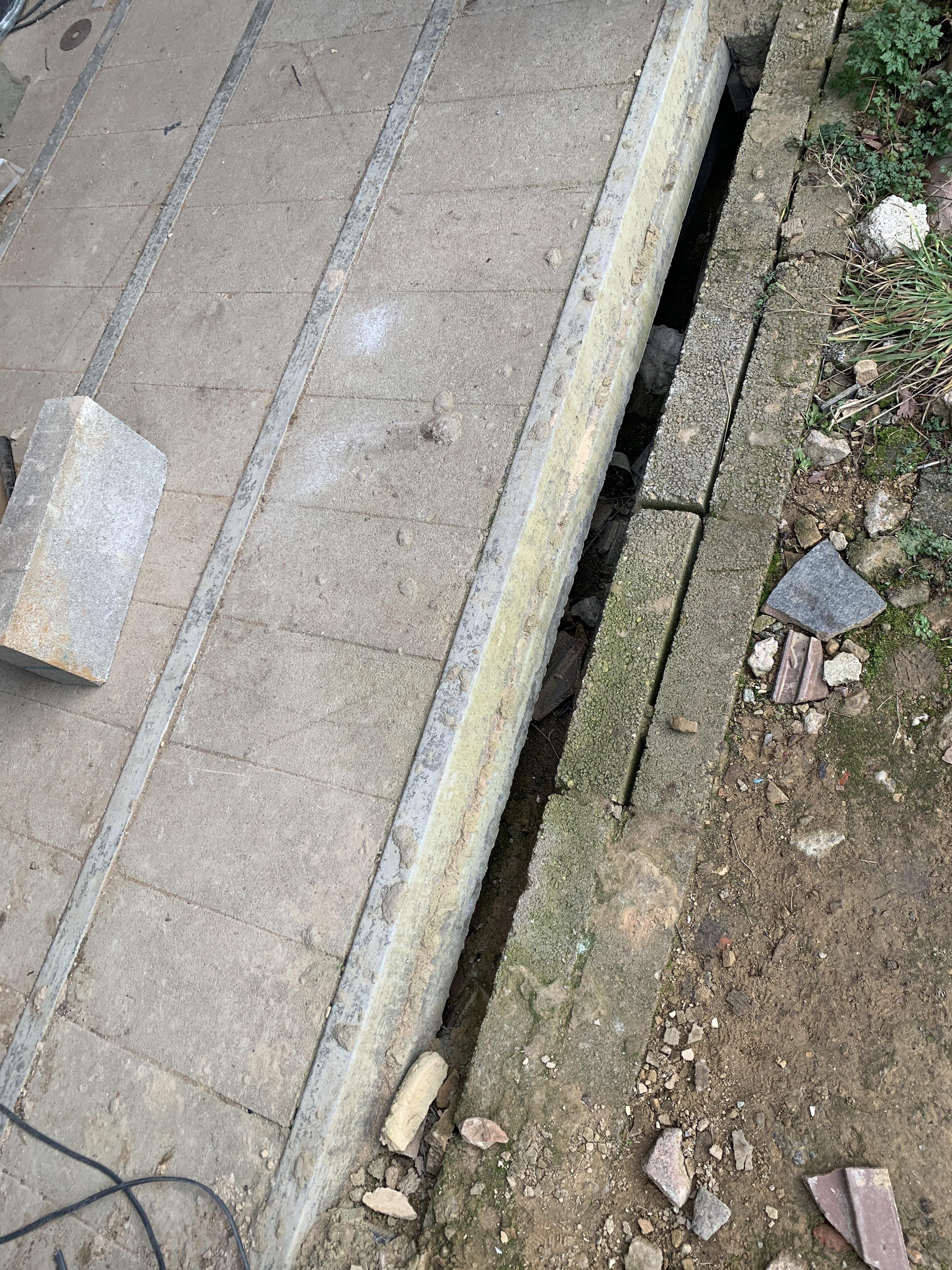

James94 Posted January 28, 2022 Share Posted January 28, 2022 Looking to pour our garage slab and this is what we’ve been left with. What Is the usual method to bridge this gap? james Link to comment Share on other sites More sharing options...
markc Posted January 28, 2022 Share Posted January 28, 2022 A lot depends what will be going outside. You would normally pour the slab and then work the outside to match the slab. I am guessing it will be a decent slab to take some load away from the centre of the first beam Link to comment Share on other sites More sharing options...
JohnMo Posted January 28, 2022 Share Posted January 28, 2022 I'm going to using 3x2 concrete slabs cemented in place. Link to comment Share on other sites More sharing options...
James94 Posted January 28, 2022 Author Share Posted January 28, 2022 Outside will be some sort of loose stone for driveway so not sure if this will determine how best to bridge the gap. The slab will be about 4" thick i'm not sure if this will require anything to strengthen concrete or not. James Link to comment Share on other sites More sharing options...
James94 Posted January 29, 2022 Author Share Posted January 29, 2022 @JohnMo will you be tackling this task yourself, will you be putting any rebar in to strengthen slab or is this not necessary? James Link to comment Share on other sites More sharing options...

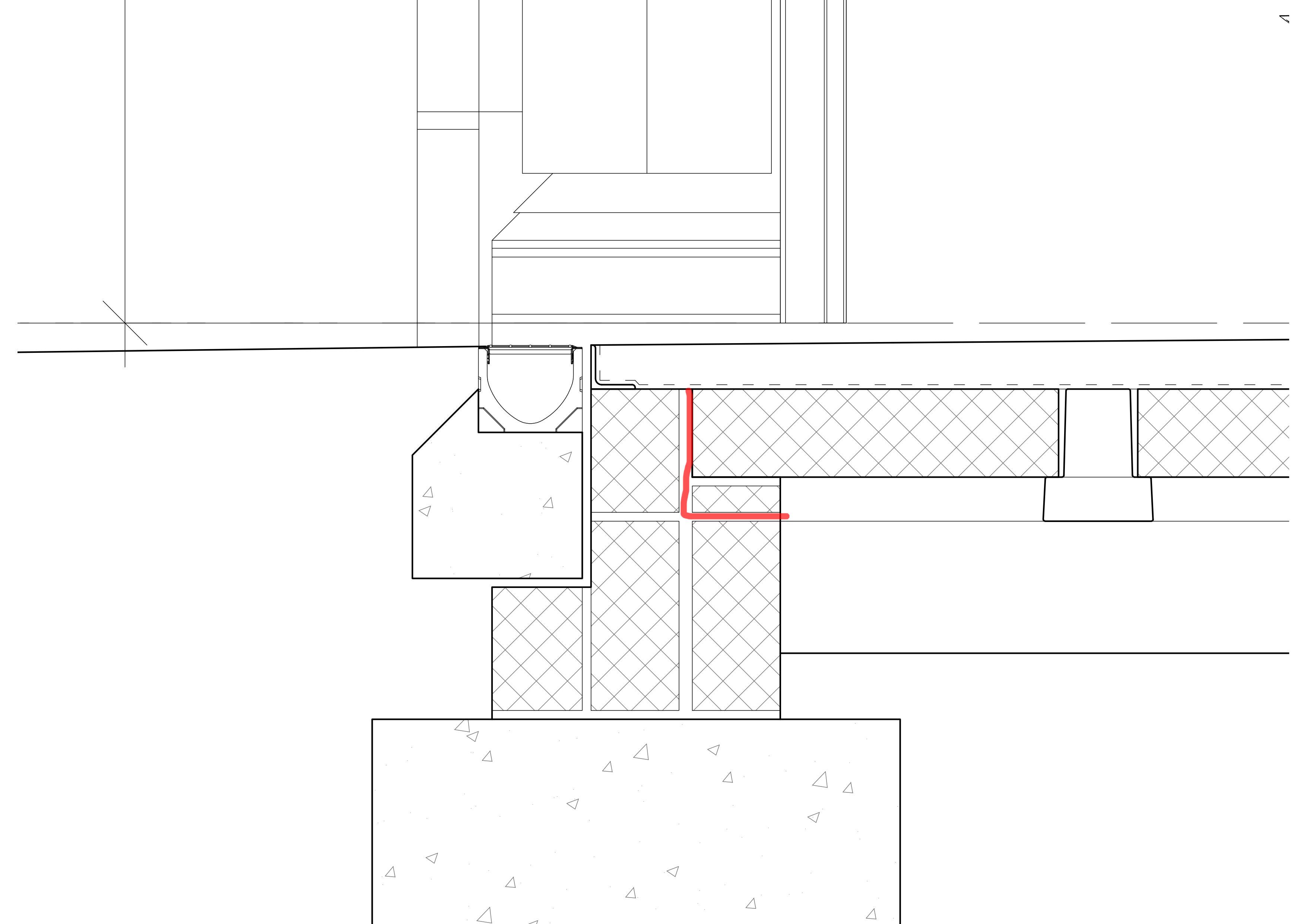

BenP Posted January 29, 2022 Share Posted January 29, 2022 See attached - taken from a very basic set of Building Regs drawings we produce. I've just added a red line to indicate a DPC under the Beam and Block. These drawings are usually seen at 1:50, not 1:5!!!! BP Link to comment Share on other sites More sharing options...
BenP Posted January 29, 2022 Share Posted January 29, 2022 So you're nearly there. Youre ready for DPC, coursing block and then final infill floor block. Another block to bring it level on the outside and then a concrete topper. I would always add the floor/channel drain but you may be OK with some good falls. Link to comment Share on other sites More sharing options...
